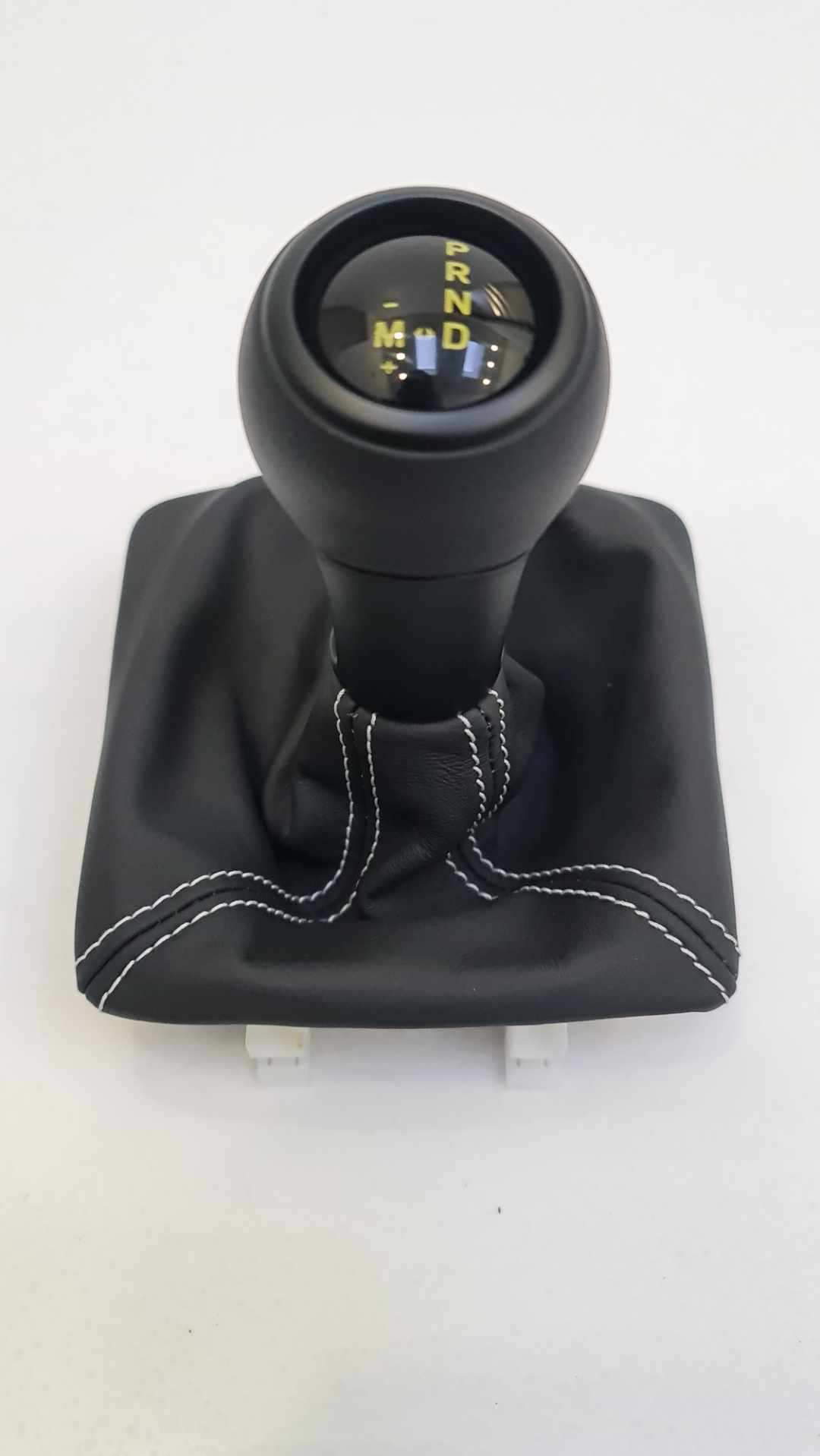

@toddinmd where did you get the leather boot with the platinum grey stitching?
#21
toddinmd
Posts: 151
Location: Ellicott City, MD
Has thanked: 31 times
Been thanked: 59 times
I ended up getting it from Suncoast. Not cheap, but I wanted the look.
https://www.suncoastparts.com/product/9x1pdkboot.html

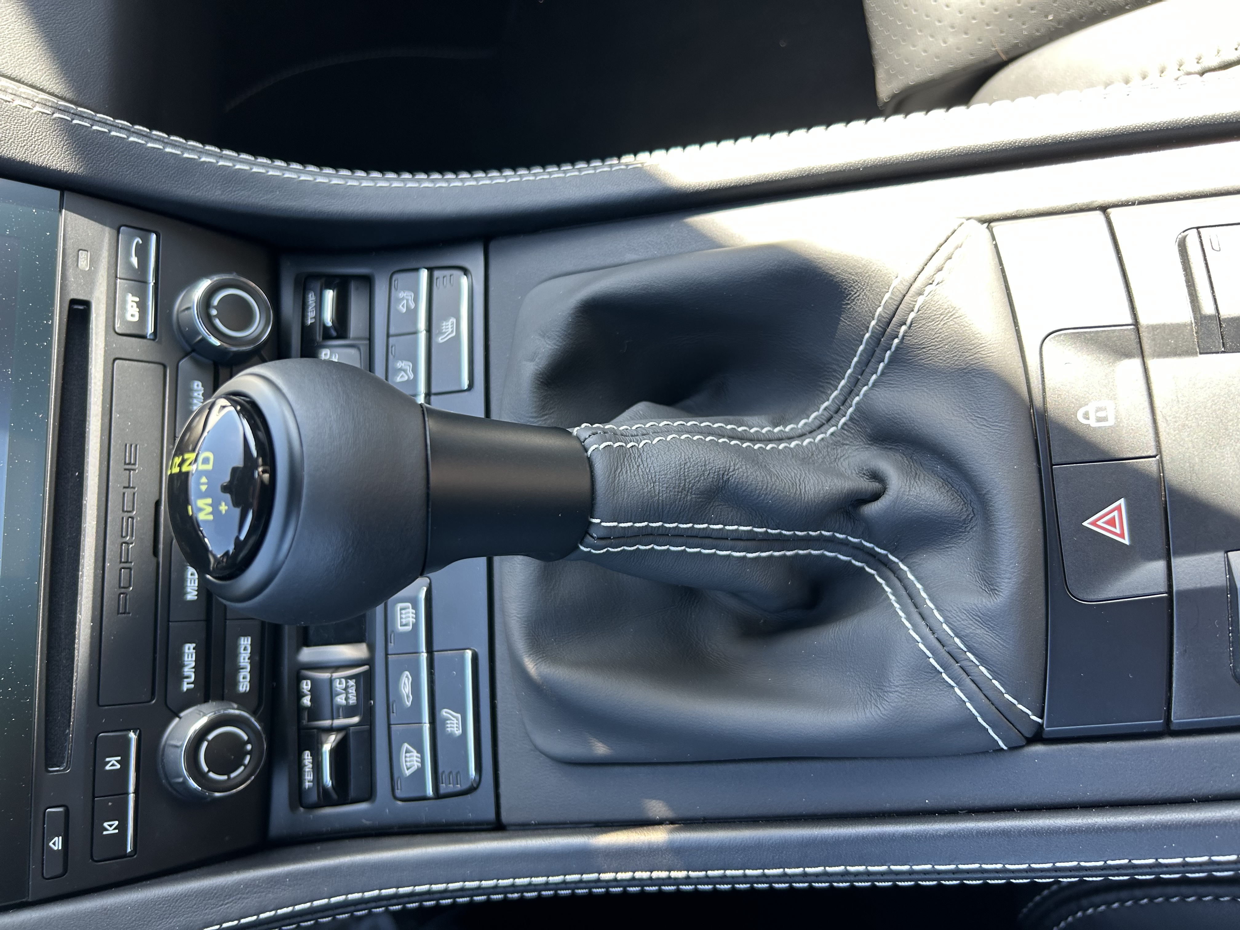

One topic caught my eye and it’s the one about installing the GT3/GT4RS style PDK shift lever plus manual shift housing and boot into my ‘21 Spyder. I bought the parts from Suncoast and had them installed by my local shop this past March. Looks great and works flawlessly.
2021 718 Spyder - GT Silver - PDK w/GT4RS Shifter

@Tom78737 do you have photos of the completed installation? I’m installing mine this week.

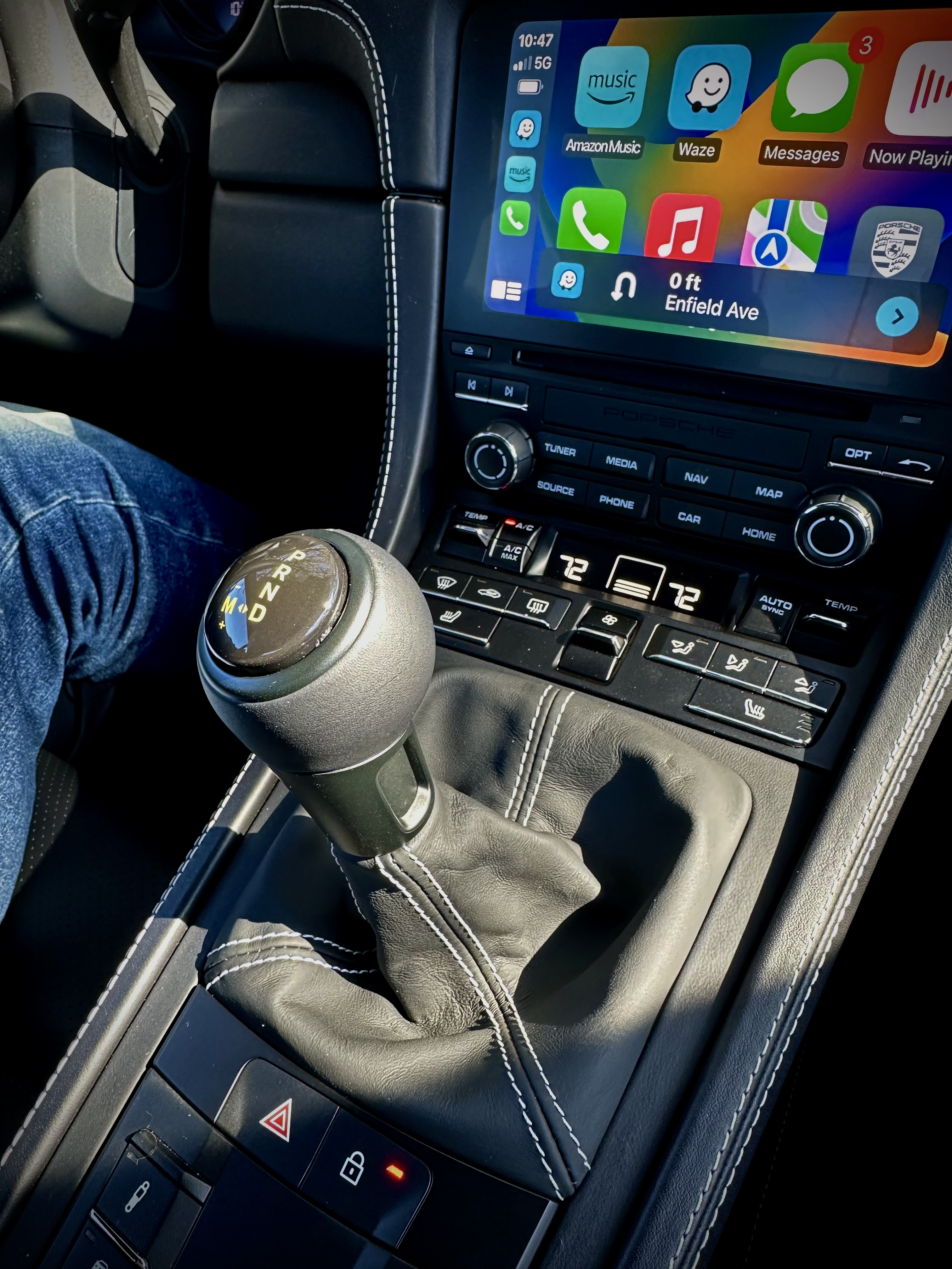

Dr. John @Leader rolled up his sleeves today and helped install my PDK GT4 RS shifter and boot. There is so much that is cool about this:
1. Sits lower than the OEM plastic chrome shifter. The shift knob falls more comfortably in your hand while resting your arm on the center console lid.
2. The black leather boot and shifter look better than the OEM set up
3. The gear changes and manual toggle shifts somehow feel crisper - I’ll admit I may have just a bit of confirmation bias to feel good about the expense.
Thanks a million John🤙🏻
