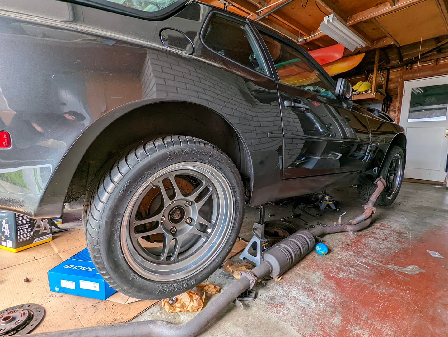

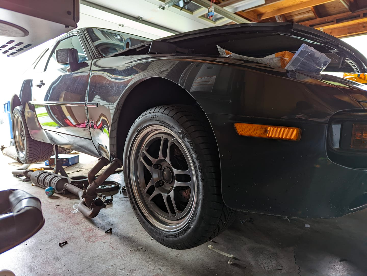

Unfortunately, I believe I do need the clearance in the back. I don't have my car with me at the moment but the previous owner of the wheels was kind enough to provide me these pictures and I think it pretty clearly shows that clearance will be necessary.
