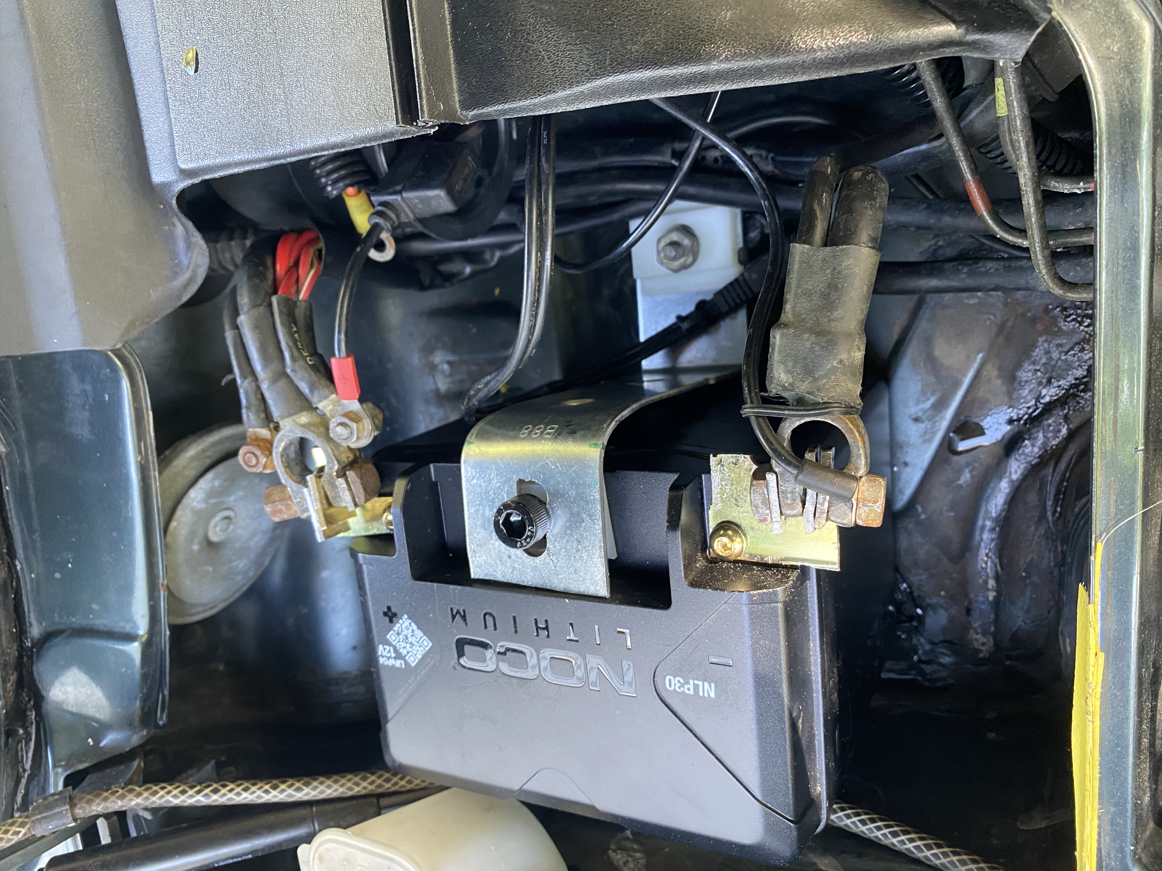

Purchased the NLP-30 and test-fitted it using a home construction framing bracket (had to make one bend) and making some “custom” adapters to connect the battery cables to the battery terminals, which do not have your traditional posts. The battery has a female threaded hole and bolt included, so that is how the bracket is attached.
I will redo the bracket and terminal adapters now that I know it’ll work. I want a “Singer” level of fit and finish, so will paint or powder coat the bracket black. The battery is so light it is firmly held in place by the one bracket. I’ll also cover up the terminals to prevent accidental arching, and top it off with the factory battery lid.
The NLP-30 weighs about 5 pounds and barely registers on a bathroom scale. It has started my car fine over the last couple weeks, though the temperatures have not dipped below 40. I’m loving it so far!
