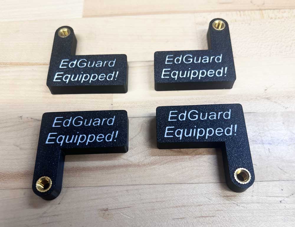

Just did a set of custom mounts for @Crazy Eddie after a 90 miles mountain drive today. I know I keep raving about the new printer technology, but this would have been a pipe dream just a few years ago...

Tom wrote: Sun Sep 10, 2023 7:08 pm Just did a set of custom mounts for @Crazy Eddie after a 90 miles mountain drive today. I know I keep raving about the new printer technology, but this would have been a pipe dream just a few years ago...
Makes my heart flutter 🔥❤️
