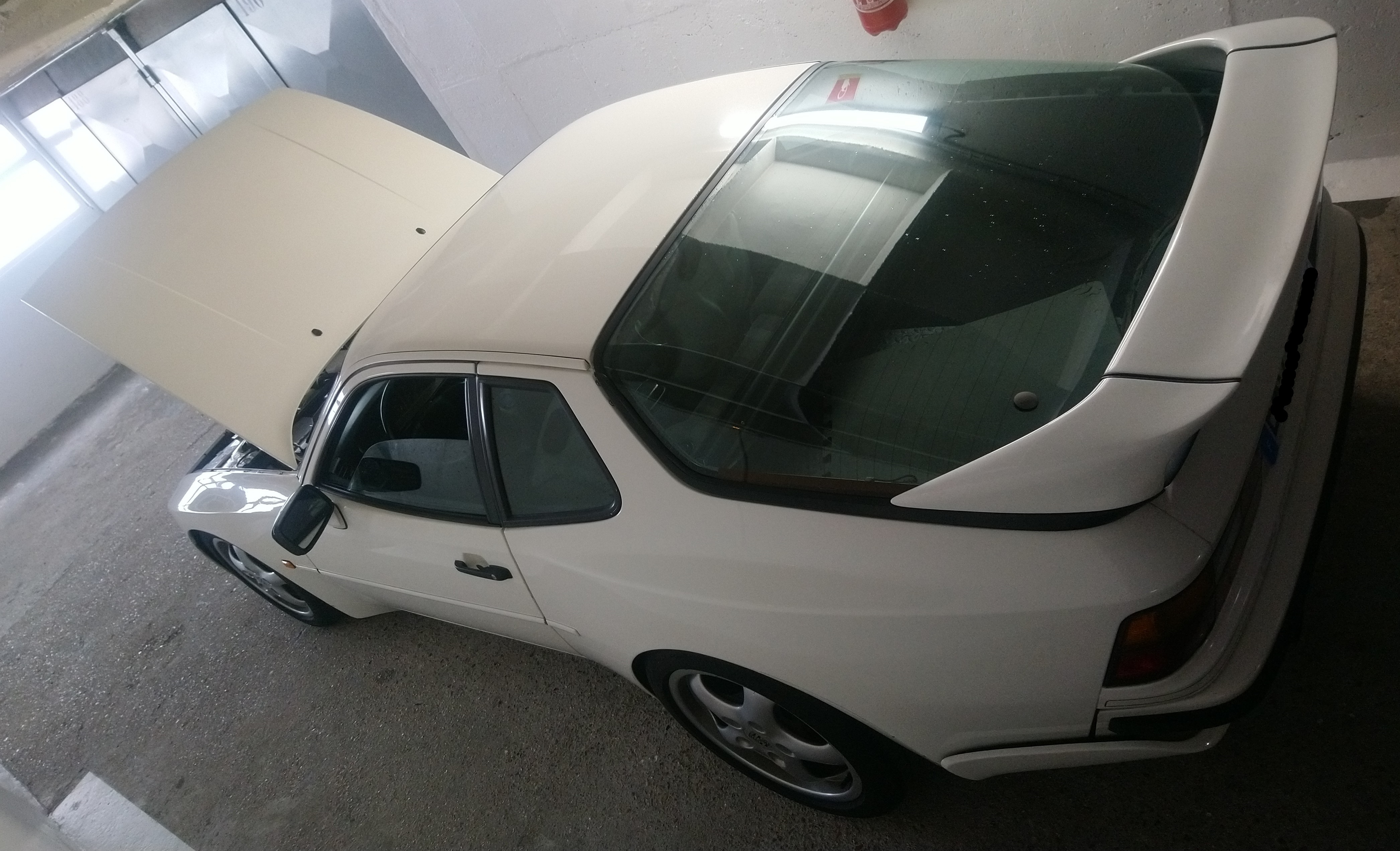

Not sure if I should be posting about a slightly embarrassing encounter that took place yesterday, on the way home from a 700 mile drive (unfortunately to attend funerals) ... but that is too funny/ridiculous to keep for myself.
At dusk, on the way home and cruising comfortably at around 90 mph on the highway, I suddenly saw ahead an early gen Boxster. The driver was making his way to the outer lane, patiently waiting that the series of trucks ahead had overtaken each other. I was already on the outer lane, closing in at a higher rate and found myself ahead of the traffic when sure enough I saw our friend in his Boxster catching up as he was apparently eager to play. I was too happy to oblige, switched from 6th to 5th and applied moderate load to avoid losing traction but what should have ended in tears for him turned into an embarrassing moment for me as upon accelerating my phone fell off its bracket straight onto the switch, ahead of the gearshift, that controls power supply to the fuel pump... before I realized what was going on the engine cut off and I had to coast with the warning lights on. In the heat of the moment it took me a good minute that seemed to last forever to figure out the "issue". I was relieved that it was not something serious like breaking something but equally furious that my phone fell off its bracket for the umpteenth time again, and for once exactly where it should not have. I tried to catch up with the Boxster but unfortunately it seemed to have exited the highway shortly after as I never saw it again.
That cheap phone bracket had been bugging me right from the start for its inability to grip my phone firmly and ended up in the trash can after being somehow passionately taken apart in a thousand pieces by my left foot.
Otherwise the car ran great. The suspension is now as good as can be for road use but I think I need now to upgrade the axles as I still get little vibrations in the rear axle that I suspect could caused by failing CV joints. Not a big issue on shorter drives, but on longer drives such as yesterday's which is how I enjoy using the car best this is getting long in the tooth.
I heard about "stronger" CV joints used on 930s (108mm rather than the stock 100mm units) but who can supply shafts in the 2 different lengths required for a 968 gearbox?
