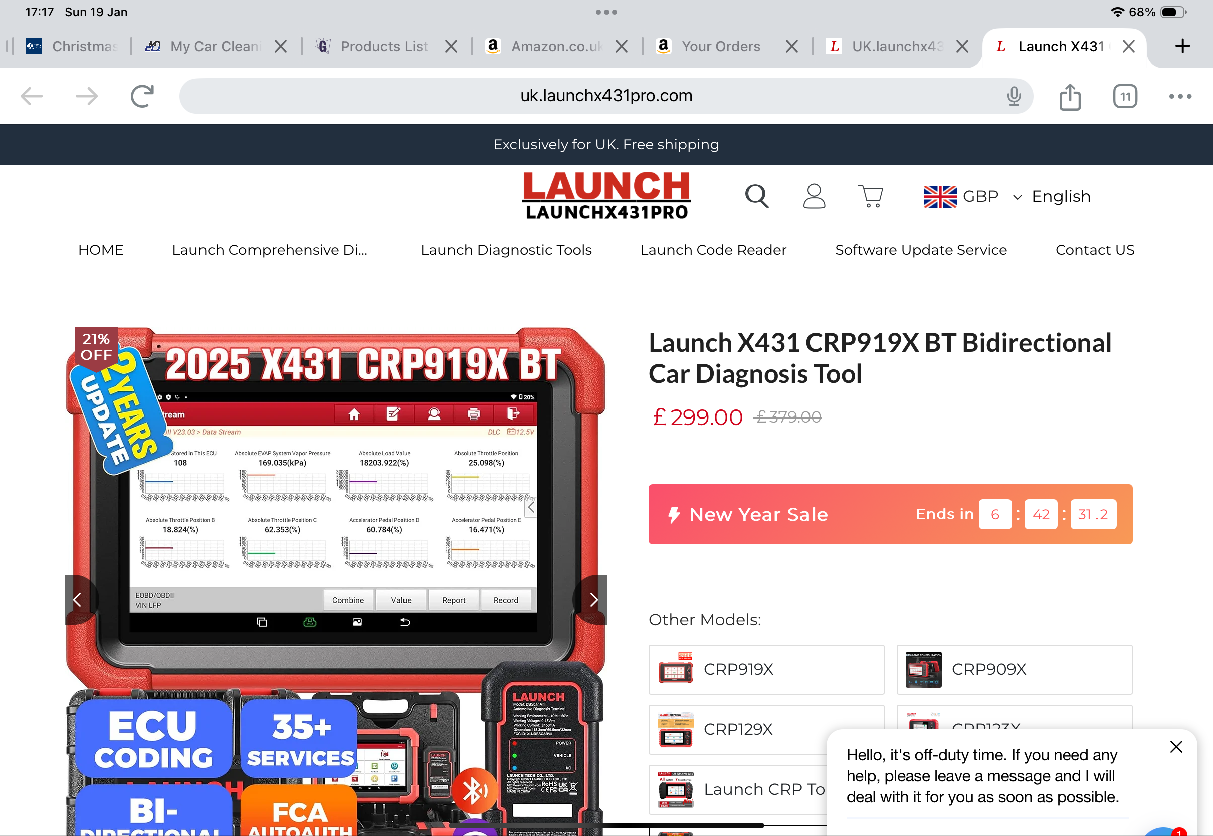

Posted: Sun Jan 19, 2025 10:31 am
by grasmere
UK new year sale ending very soon:
This is a brilliant thread, starting from the beginning I’m itching to do some mods and it seems the 919 X is absolutely fine.
in the UK on Amazon right now it is £499, however on the Launch UK website
https://uk.launchx431pro.com/products/l ... nosis-tool
it is normally £379 but now £299 free delivery for the next 5 hours on New Year sale
Just ordered mine 👌
