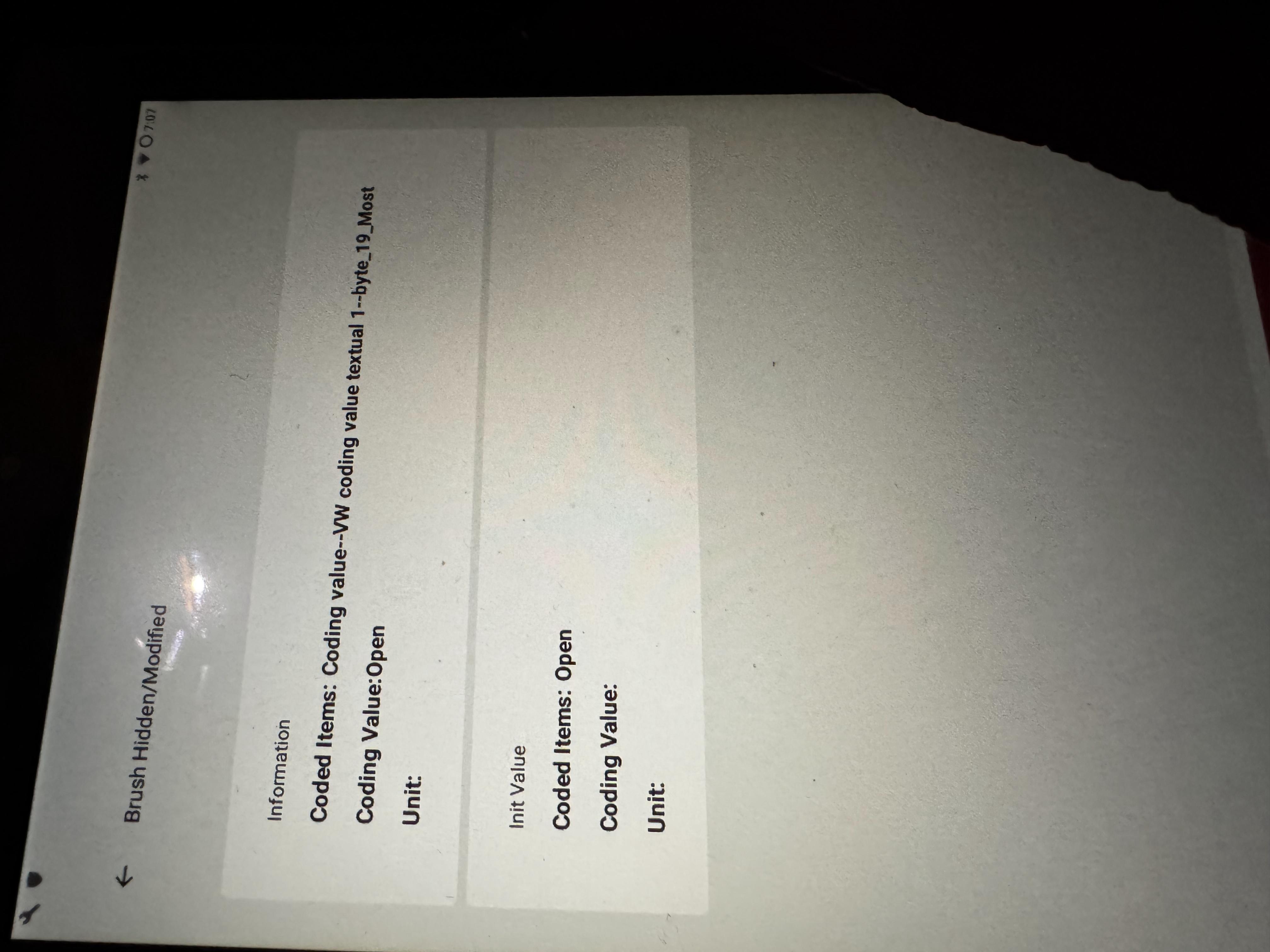

Any idea why that code is set to can on my 718 if it has the Bose system?

planolemans wrote: Sun Dec 01, 2024 5:32 am I want to use the optical output of the PCM to connect to a DSP amp. In other words to connect to the amp digitally. I think you found it, I need to use MOST. How did you get there? Thanks
I found the attached code as well. This one makes more sense given that my car has the Bose system. However, it is possible that there are multiple codes you will need to change.

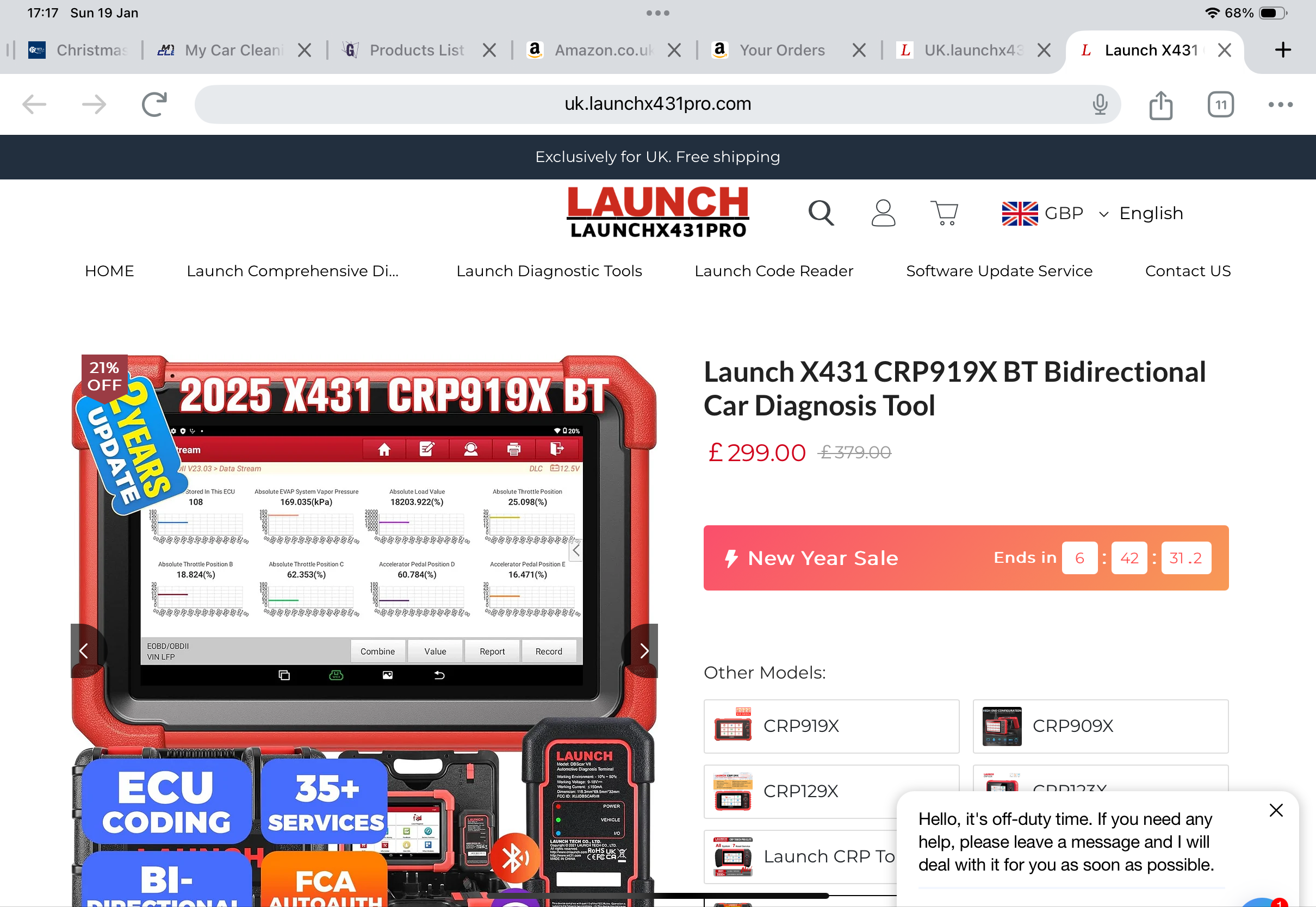

UK new year sale ending very soon:
This is a brilliant thread, starting from the beginning I’m itching to do some mods and it seems the 919 X is absolutely fine.
in the UK on Amazon right now it is £499, however on the Launch UK website
https://uk.launchx431pro.com/products/l ... nosis-tool
it is normally £379 but now £299 free delivery for the next 5 hours on New Year sale
Just ordered mine 👌
