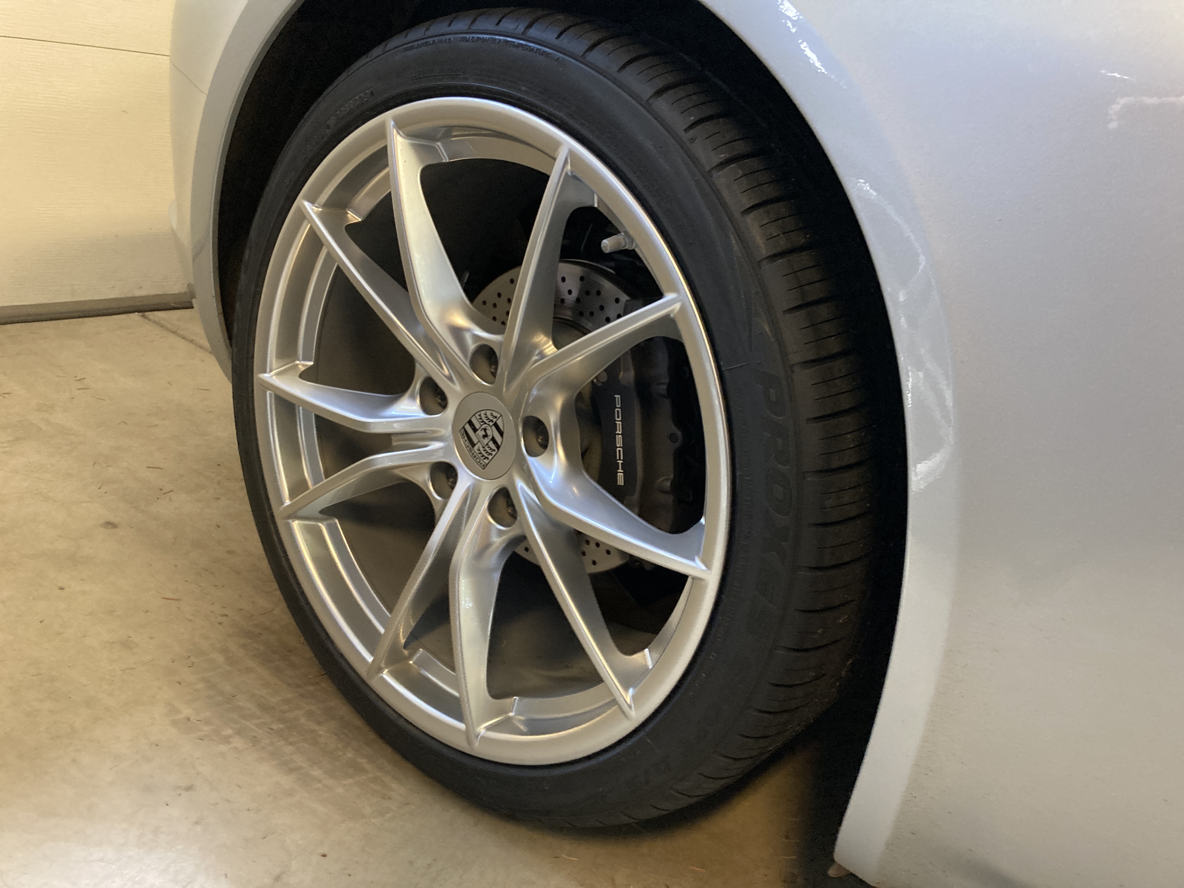

The Toyos and wheels were installed this morning. Don't have enough miles on them yet for any kind of meaningful review. But they look good and took very little weight to balance out. And I really like the Carrera S style wheels, much nicer (to me) than the previous Boxster S wheels.

Arne2 wrote: Tue Sep 26, 2023 3:36 pm The Toyos and wheels were installed this morning. Don't have enough miles on them yet for any kind of meaningful review. But they look good and took very little weight to balance out. And I really like the Carrera S style wheels, much nicer (to me) than the previous Boxster S wheels.
Here's the teasers:
Geeez, they look great!! Nicely done.

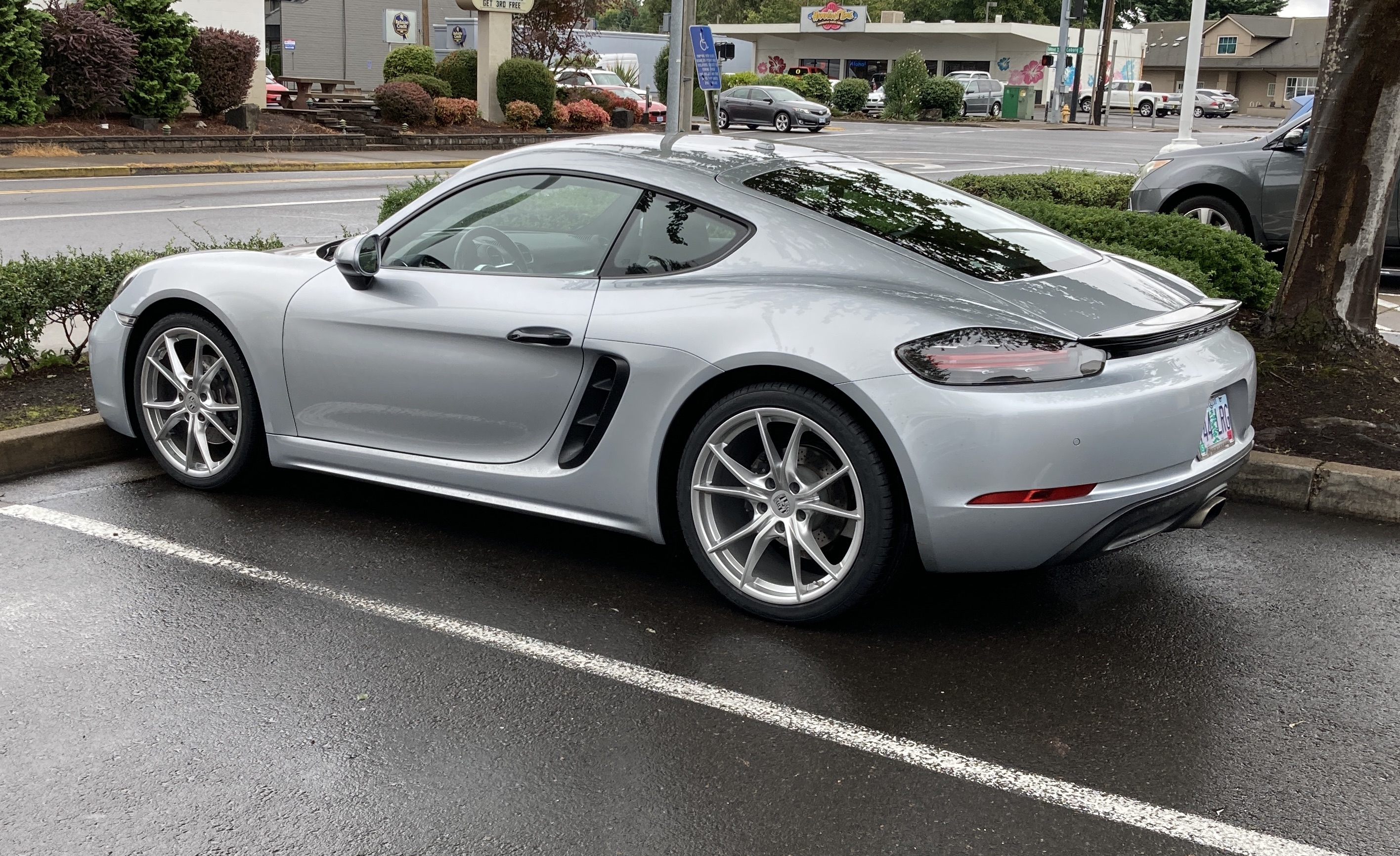

Thanks. I really like the updated look. Still not enough miles for much of a review on the Toyo all seasons, but I can say they seem to be reasonably quiet so far. Will have a better feel for them after next weekend's PCA drive.

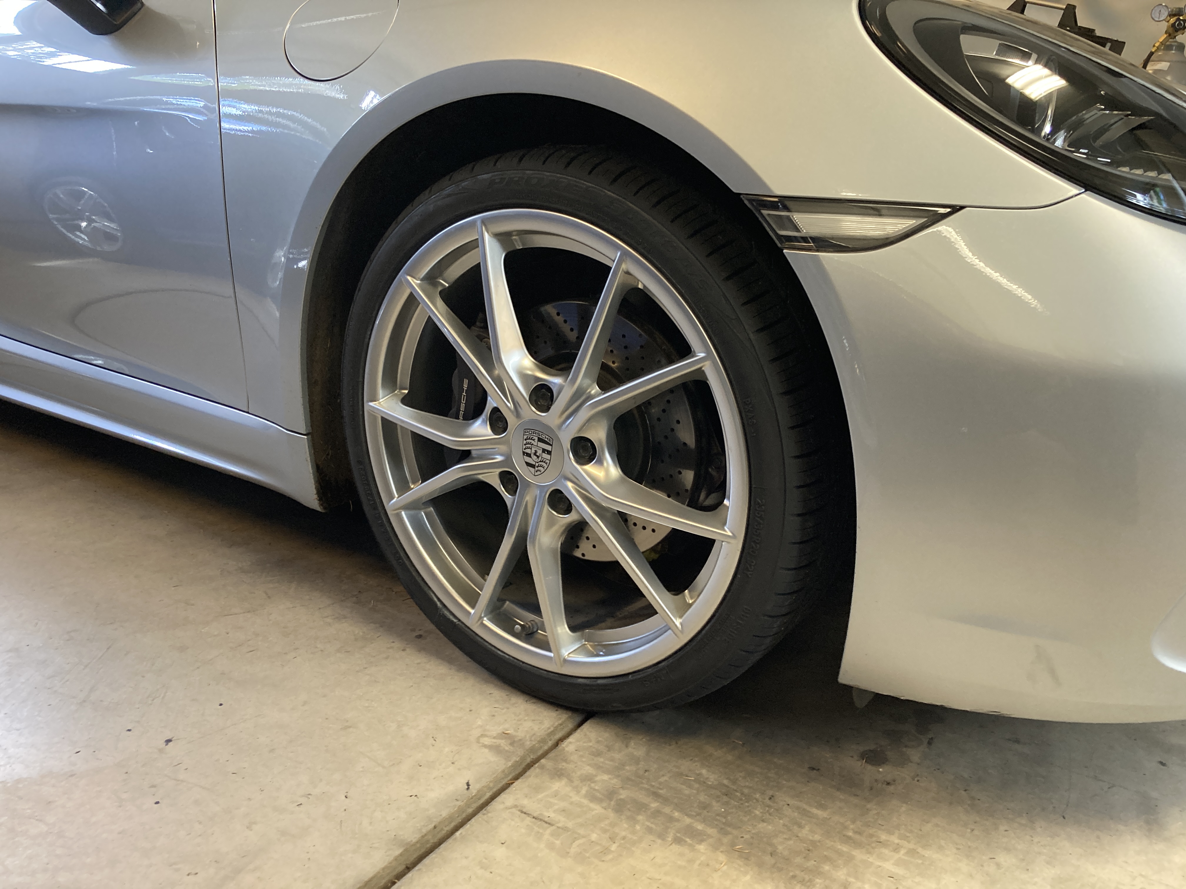

Here is a 'before' shot.
And here it is on Friday during a couple of short errands.
