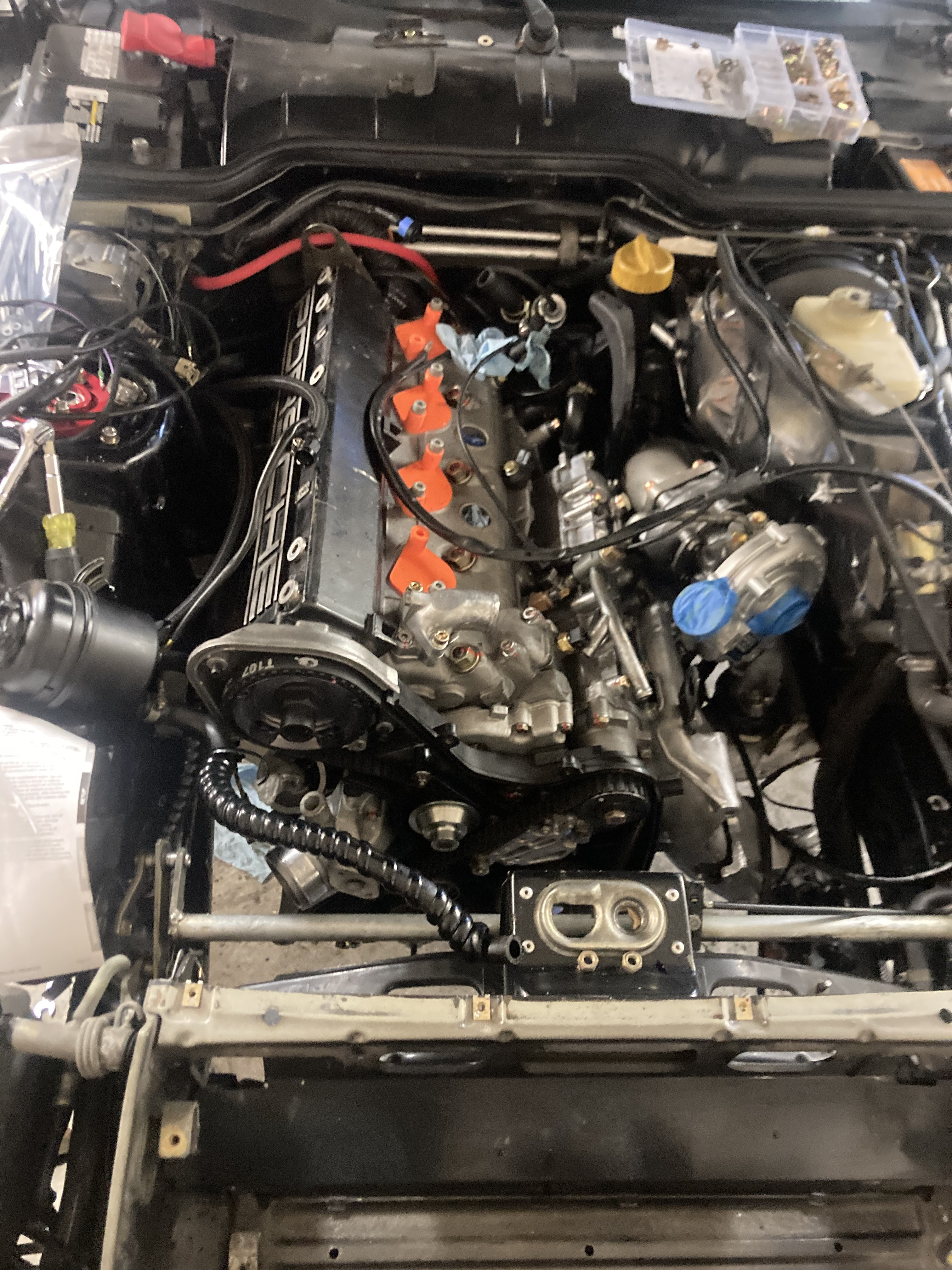

Still slowly plugging away, got the motor in over the last two evenings:
Pardon the mess.
You'll have to take my word (and that of my sore everything) that it's mated up proper to the TT. It looks like I took this before handling the engine mounts and crossmember too, but that's all squared away.

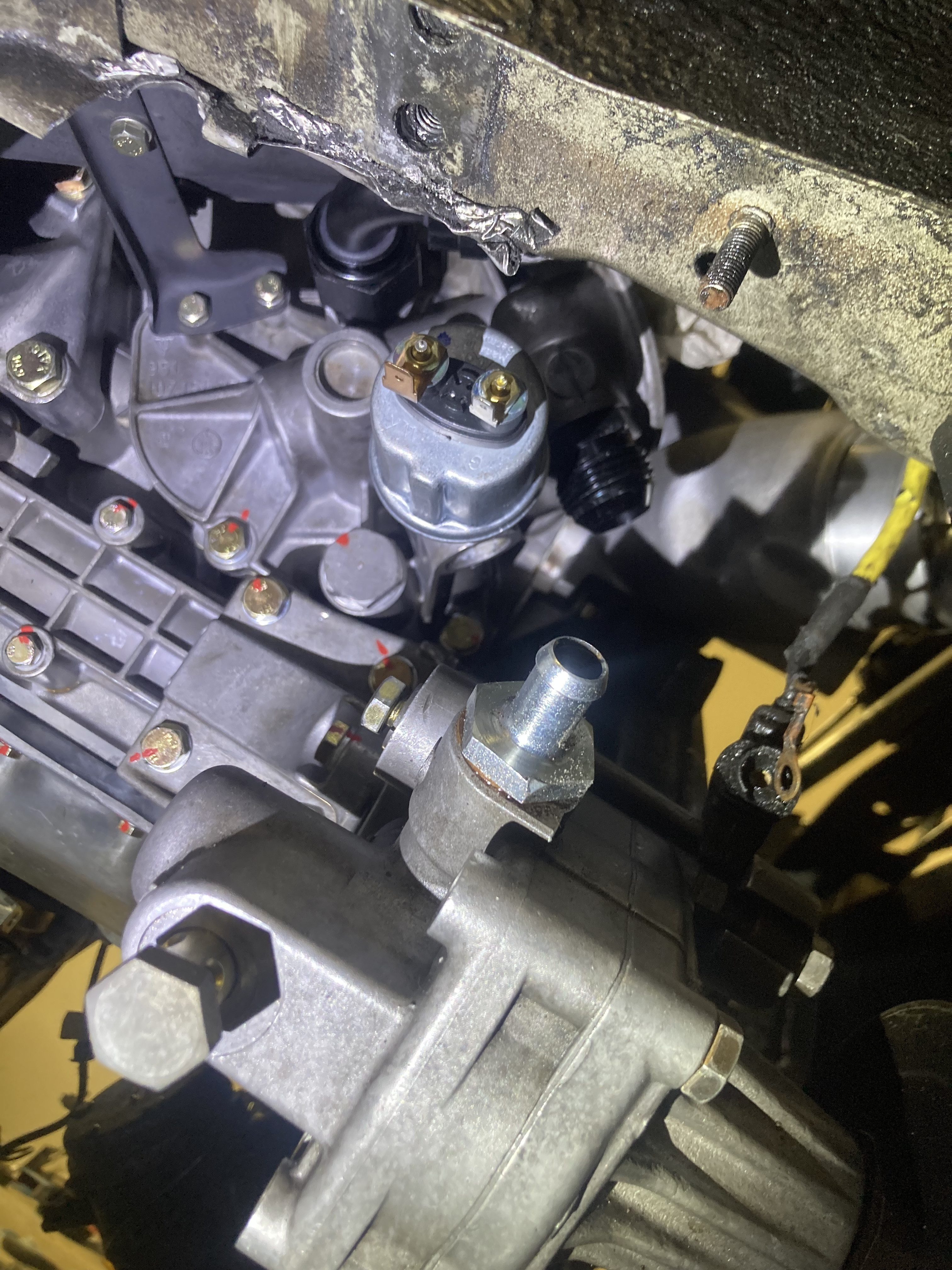

Suddenly all that nice room I had for running the new oil hoses has vanished, routing this will be interesting:
edit: my attachments fell off, trying again?

Looking great. Fingers crossed on start up!!
