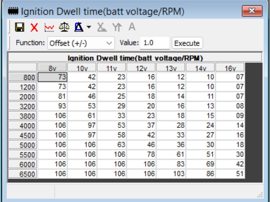

John, you are a treasure trove of info! Thank you for posting all of this! I am working to build a new XDF for the 951, which I'll post when done, mostly cobbling together tables from the other XDF's out there, but also correcting things like the idle thank to your help. I'm now trying to build an ignition dwell table. There is an XDF on the TunerPro site that shows 0x3FA as the start of a 2-axis dwell table with 7 voltage levels on one axis and 12 rpm levels on the other axis. Here's what it looks like with a stock BIN:
per TunerPro site.jpg (189.37 KiB) Viewed 376 times
Both the RPM and Voltage values are hard coded into the XDF (i.e., typed in by whoever made the XDF), and they differ from what other people (like @Dave W. ) have posted on other sites. Does this look like the right location for the dwell table? And are the actual axis values in the code? The other tables I've seen use 40, 80, 160, 320, 480, 640, 800, 1440, 2080, 2280, 3840, 5240, and 6480 for RPMs (all of which are multiples of 40, so seem more likely real); and 6, 8, 10, 12, 14, 16, 16.4 as volts. I've scanned the BIN for a string or matching RPMs to no avail...
This does seem to be the right location but you're correct the RPM values are wrong. The real ones are what you posted except 80 (you posted 13).

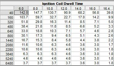

I found this note I wrote from when I looked at the dwell table before:
So for instance, for 800rpm and 14v I have the value 18.
Multiplying this by 1.363 (degrees per half-tooth) I get 24.54 degrees dwell time.
Now 800rpm is 75 milliseconds per rev, or 0.2ms per degree.
So that gives ~5.1ms dwell time.
Also a while back someone posted this and I remember checking it and coming to the conclusion that it was correct:
But it was a while back!
I'll put this on my list to double check. FWIW the way the map axis values are stored is hard to read directly. When a value is being looked up, the program takes the input variable and adds it to the rightmost axis value, then adds the next one to the left, and so on until the add results in an overflow. That's how it decides which column to read (but it ultimately does an interpolation to get more accurate in-between values).
So take the first one from the right for rpm in this map (5Eh = 94 decimal). You'd have to add 162 to that to get an overflow, so the right most map heading for the rpm axis is 162*40 = 6480
I'll have to take a closer look to see what the voltage axis values are.

:lol: :angel: :shifty: Sorry about that. My memory isn't what it used to be. :) I'm having hard time following the RPM axis structure. What cell does the 5E represent in your example? In the table I posts, the value in the table is 24 (decimal) for 4000 rpm at 14v. I'm not following how it gets to 4000? I guess that means there would need to be a 156 somewhere in order for 100 to be the overflow (since 100 * 40 = 4000). Just kind of lost.
