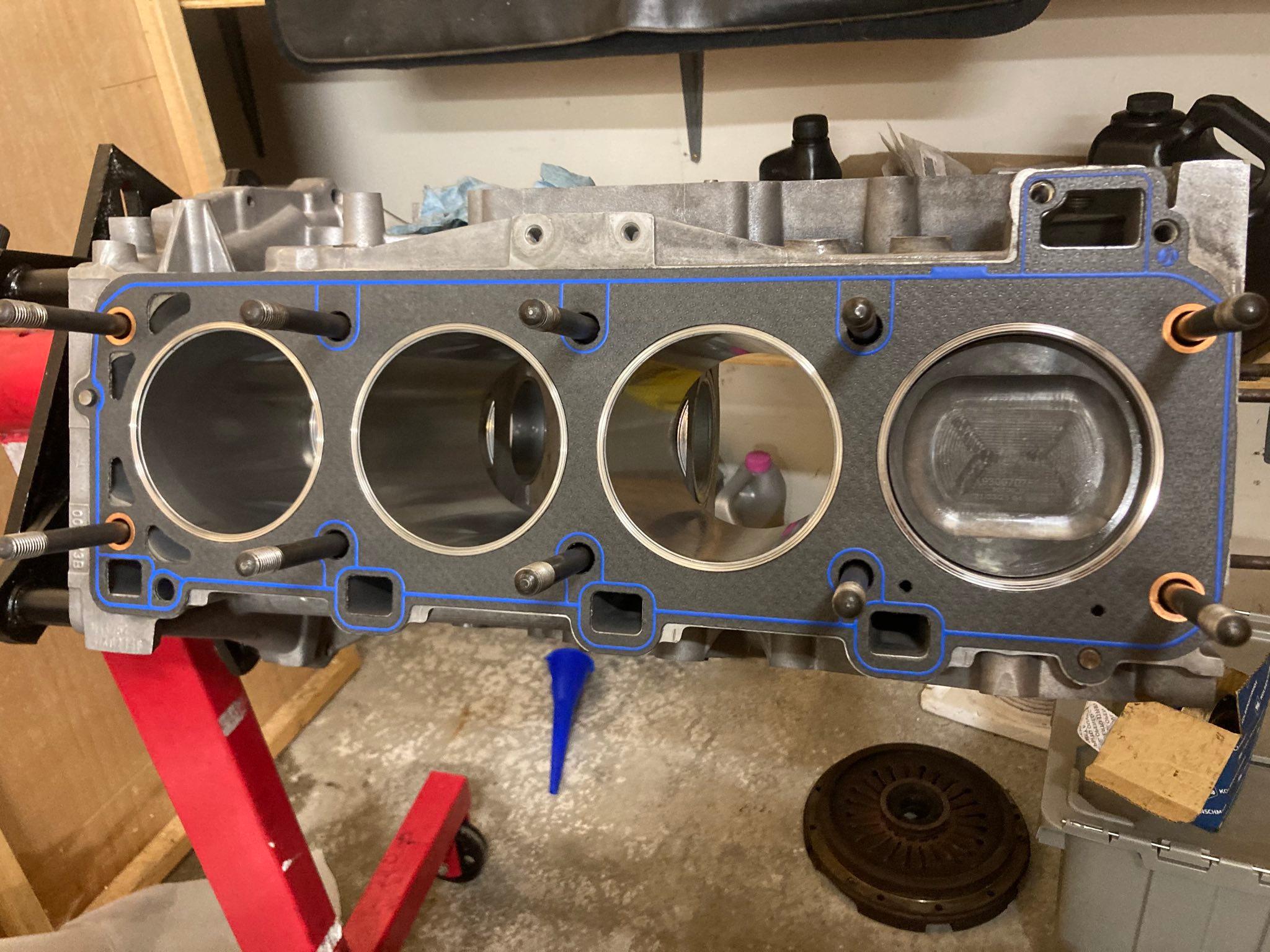

Unfortunately, that piston got yanked once I measured ~1.5 thousandths clearance (edit: realizing this is specified across diameter for some reason, not radial like I thought). Waiting on delivery of a bore gauge at this point in hopes that my and my old telescoping gauges were inconsistent.
Hoping I don't need to drag this thing back down to Portland. Kicking myself for not checking this sooner.
Edit: Of course I didn't take pictures of this, but I printed a simple jig to press the rings to the same depth repeatably. Waaay easily than lining up a piston. OpenSCAD file here, but you can probably imagine what it looks like :lol:
Edit The Third: Bore gauge came in, measured clearance to bang on 2. While I asked for 2.5, I'm sure they have better tools than I do, so I think this is alright...Will just check with Mahle on Monday, they've been helpful thus far.

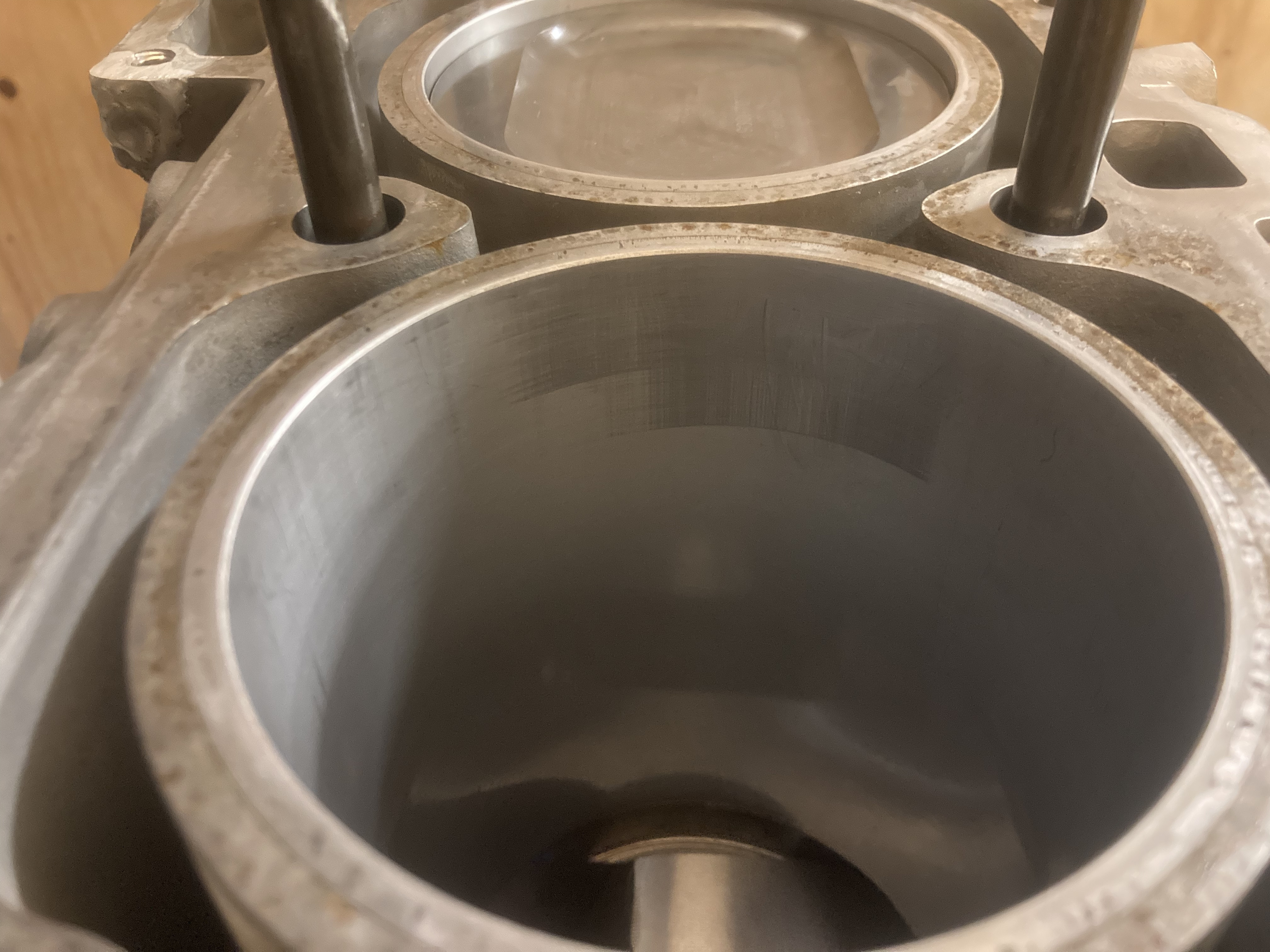

Well, I messed up a bit - caught just the oil ring set on the cylinder. Not sure how I managed that with a tapered ring compressor - guess I'm just that talented :crazy:
Here's the damage - I can't feel any of it at all, so I'm (barring sudden words of caution) just gonna order some new rings and keep plugging away. Frustrating nevertheless.

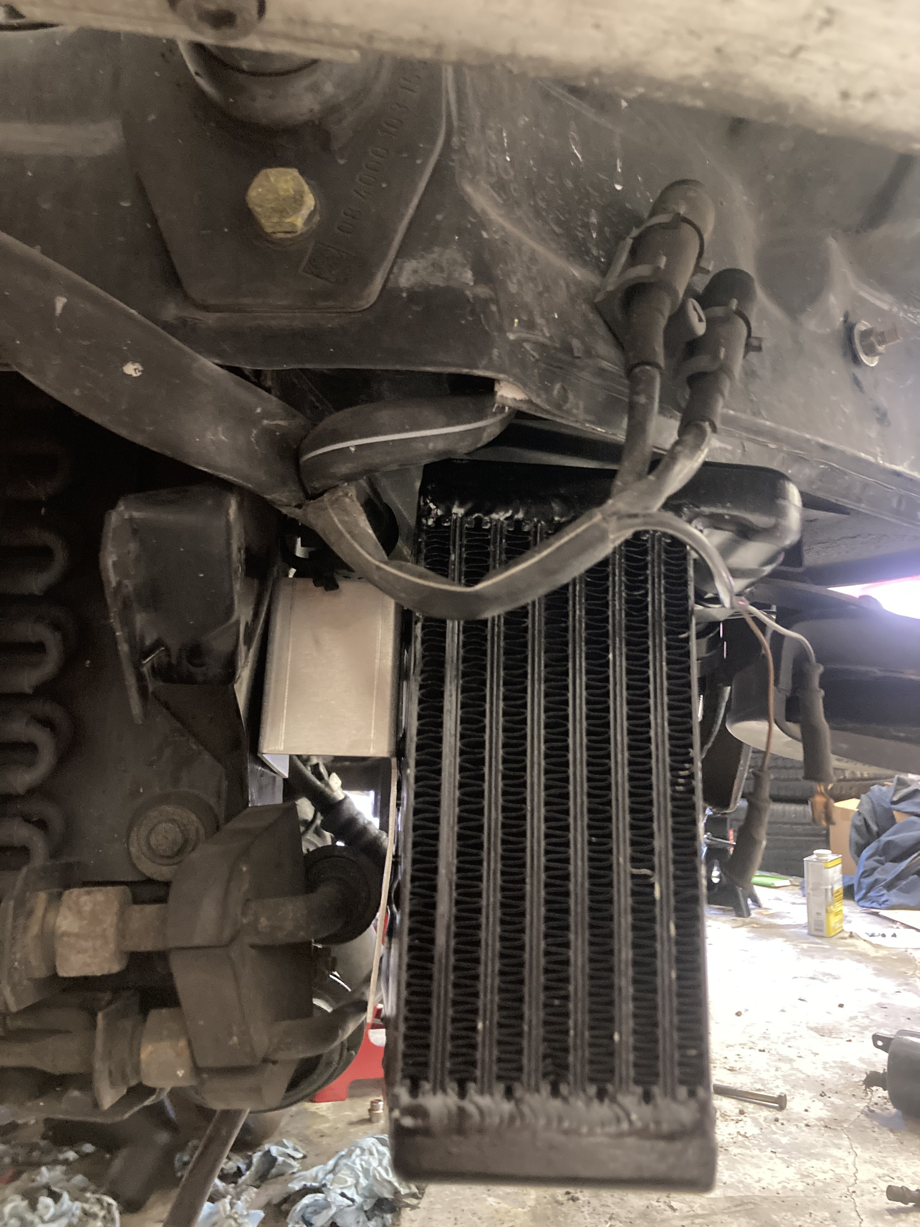

I also threw together a little bracket to help the new driver's side oil cooler mount + clear the AC condenser lines. I've never drawn anything up for bending before, so we'll see how that shakes out when sendcutsend gets it out the door, but my hope is it's a little cleaner than the plumbing straps I've seen other folks use :P

OK, well. I goofed. Or something.
Got the ringset in, and promptly repeated the same mistake (caught oil scraper ring). Disassembled and cleaned the piston and rings, fit them again, rotated the ring compressor a full rotation to check that everything was seated nicely...and did it again, but this time I left a mar I can feel :\
Adding a little more on the pile, at some point the spreader ring marred up its land. Luckily all that damage is on the portion of the piston that is a good bit narrower than the skirt, but I took down the high points anyway.
So I need to have a think on where to take this now. I can strip the block again and have them take it up just enough to clear the scratch, or I can try to take down the high parts of the damage, AN-30 it, accept the imperfection, and send it. Ugh.
Imgur album of the nasty stuff here.
On the bright side, the oil cooler bracket fit great, so I'll just include that inline :lol:

Are you sure the rings are compatible and the right size? Upside down? What ring compression tool are you using?
Re: 89 951 engine overhaul
Posted: Sun Jun 25, 2023 12:02 am
by four0four
Yep - though I didn't check the new oil rails in the bore first, they're the same size and gap as the others (also, the part numbers match up).
Not upside down, they're symmetric. Ring compressor is the smooth Summit one sized for ~100mm.
I'm sure it's operator error, but I can't figure out why. Probably going to get a local shop to take it out another 0.5-1.0 thou and refinish it myself.
