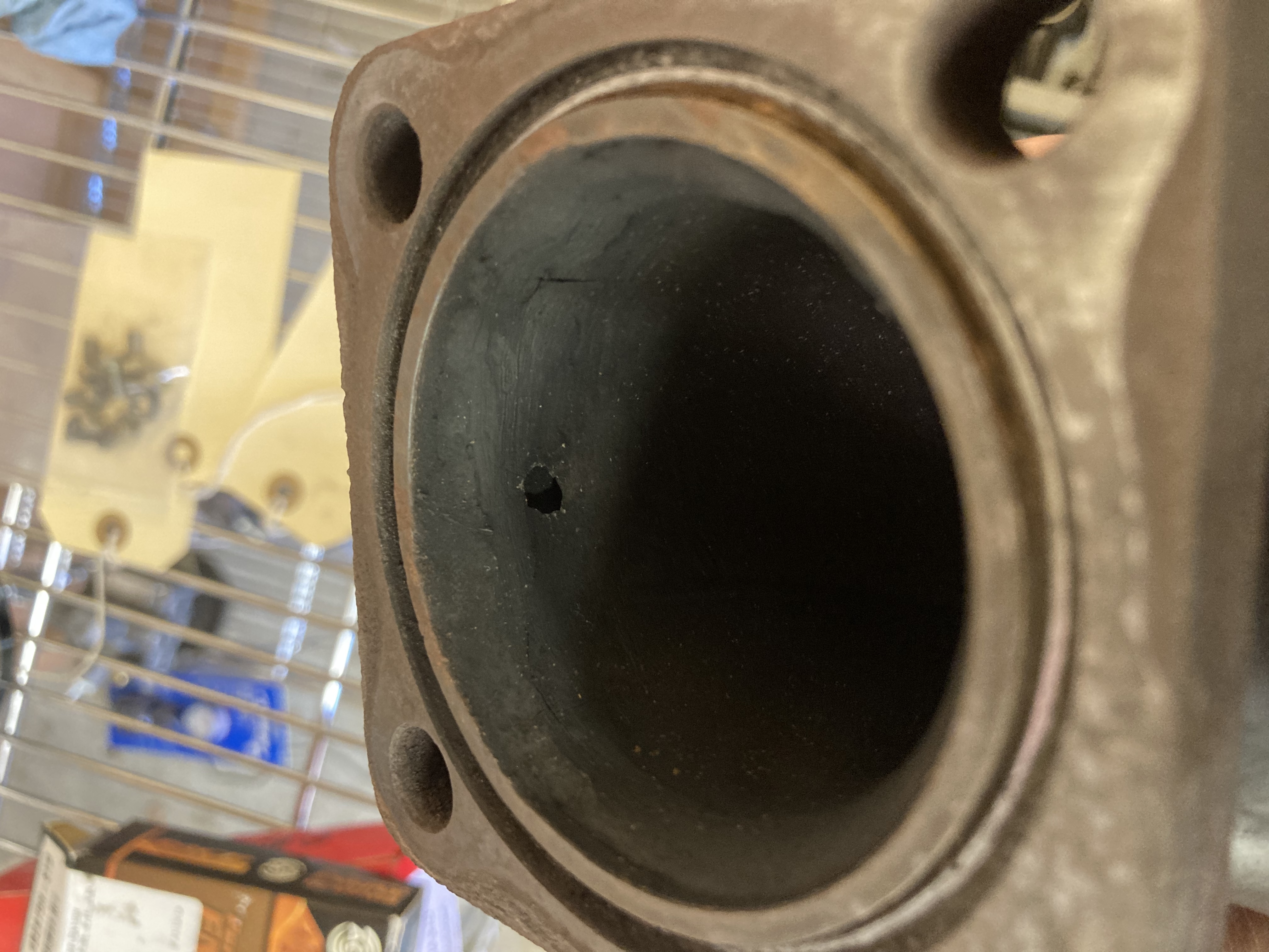

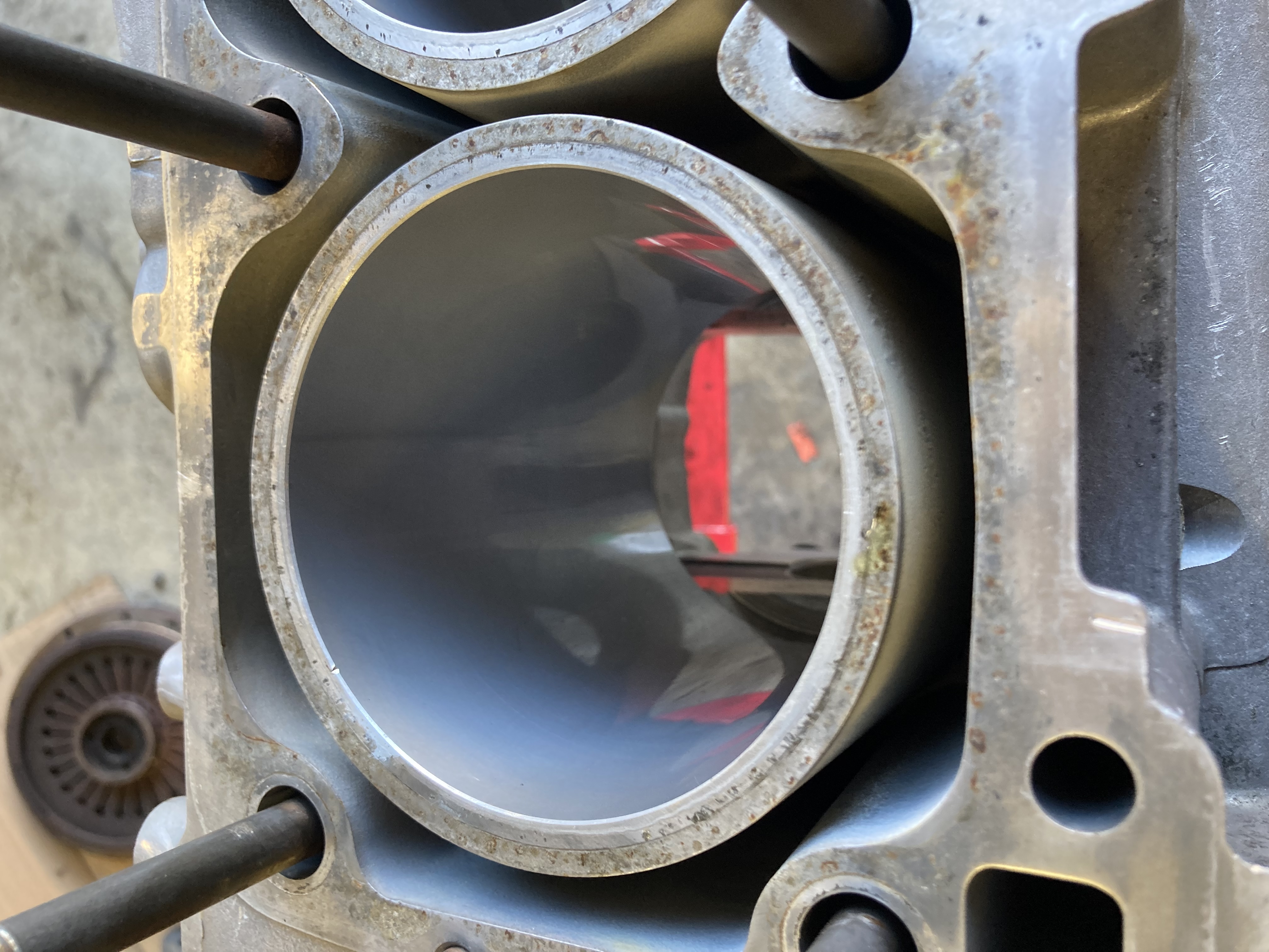

Picked up the motor from Bearing Services yesterday! Everything they touched looks great (so, the deck doesn't look great, probably should've cleaned that up first...will figure that out) & this little nick (outside of ring travel, so whatever):
I think the bores look awesome

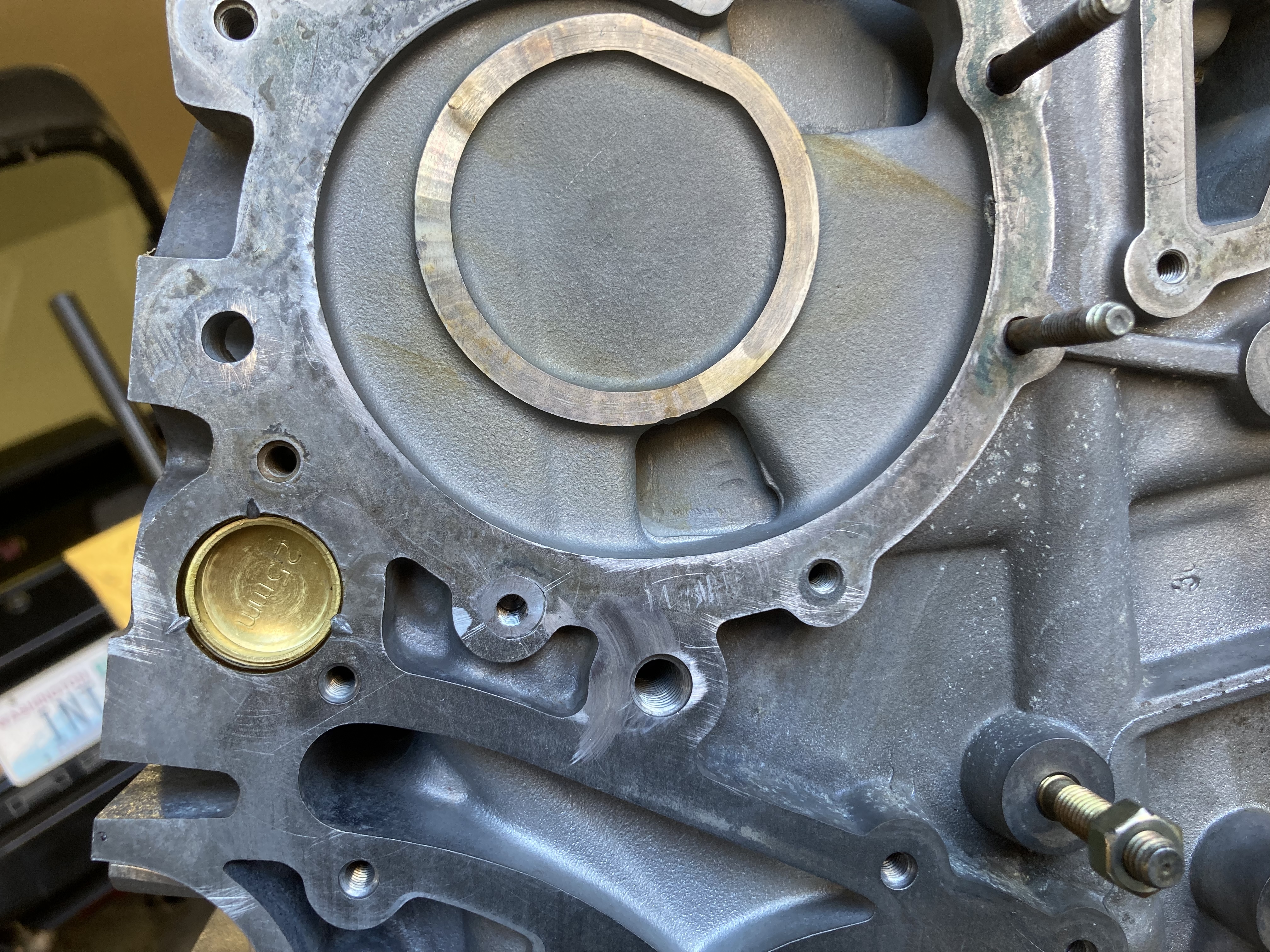

If you'll remember, I asked them to fix up some water pump studs. They cut and fit a custom insert (after digging out someone else's extractor!):
(I've never seen anyone stake a plug like that)
Also, I think I need a new down pipe:
Anyhow, this is exciting and all...but I really just need to finish cleaning the garage and prep it for assembly before anything else!

Looking good. That's how fresh Alusil bores should look like.
The water pump area reminds me of a friend who slightly machined down his 100mm bore block like yours to make room for the larger impeller water pump used on 104mm blocks, in order to improve cooling.

staking the plugs is an old school deal, I still do that to all plugs just in case!
