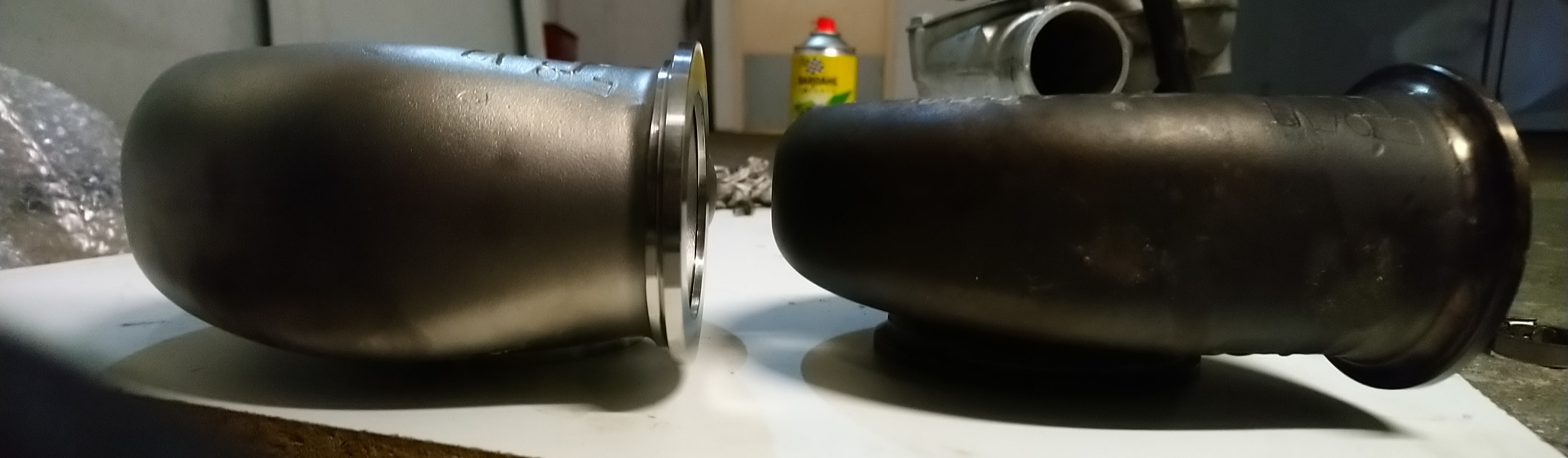

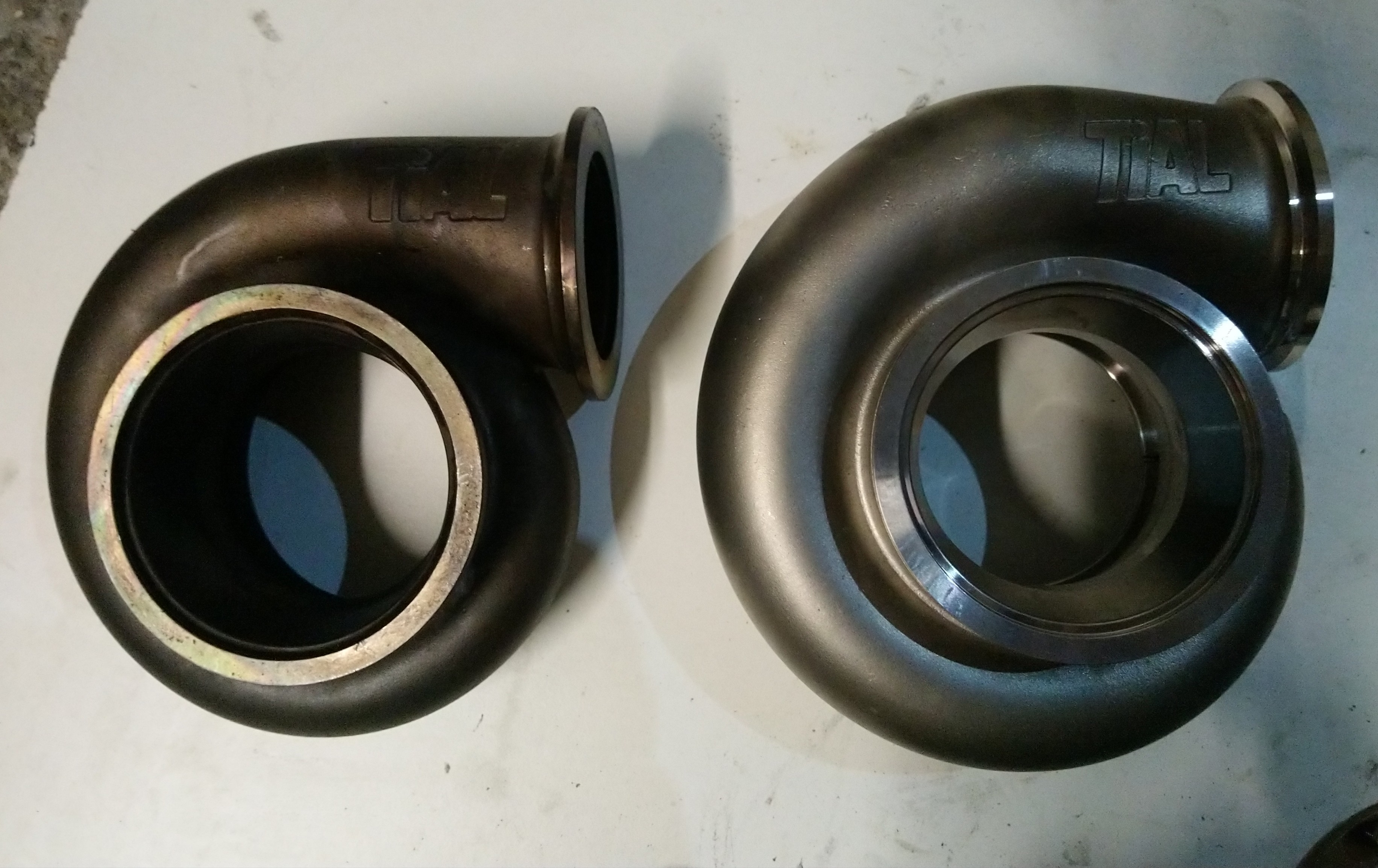

I said I would not touch the turbo but I could not resist and replaced the 0.82 A/R turbine housing with a 1.03 unit, again from Tial. The tongue area on the larger housing is a fair bit wider than on the smaller unit and "of course" interferes with the turbo mount on our cars considering how the housing must be rotated, and the mount needed quite a bit of grinding to "slide" in between the cold and hot sides. It was a tight fit, but a tight fit is still a fit. Well pleased with the results as there were moments I thought I would either have to refit the smaller housing or go with a Tial mount.

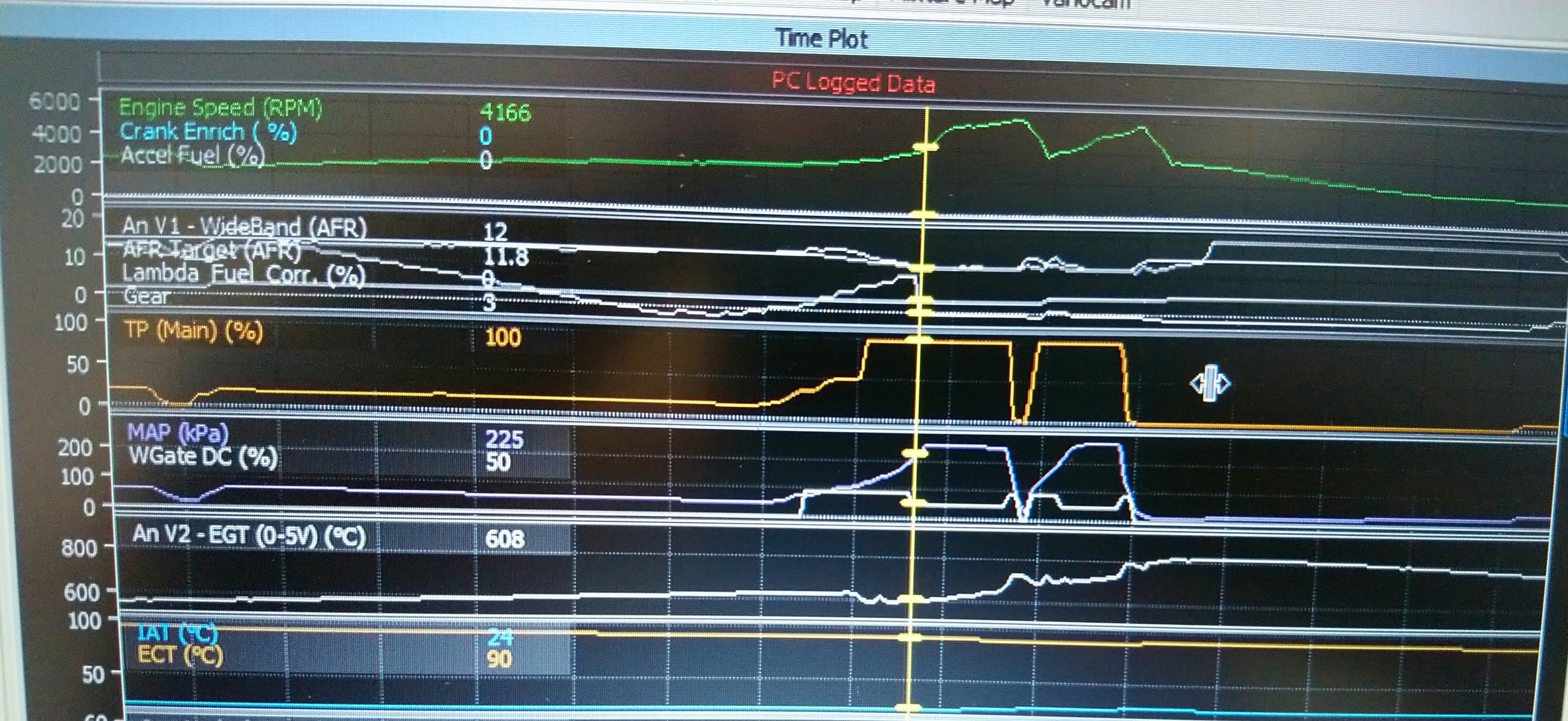

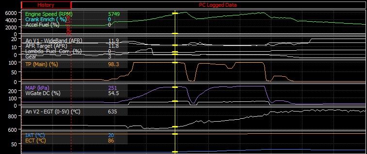

As said, traction is even more of an issue as when torque kicks in at ~4200 rpm the rear tyres give up as can be seen in this log from the sudden rpm increase. It is fun but slightly overwhelming and requires even more respect and focus. The OS Giken LSD keeps doing a great job as the car remains absolutely straight and makes the car feel like the clutch is slipping when it's "only" the rear losing traction, even at speeds above 120 mph when flooring the throttle in 5th gear. It would be "interesting" to experience what the rear end would do with a stock type ZF LSD using a fixed locking rate... or not.

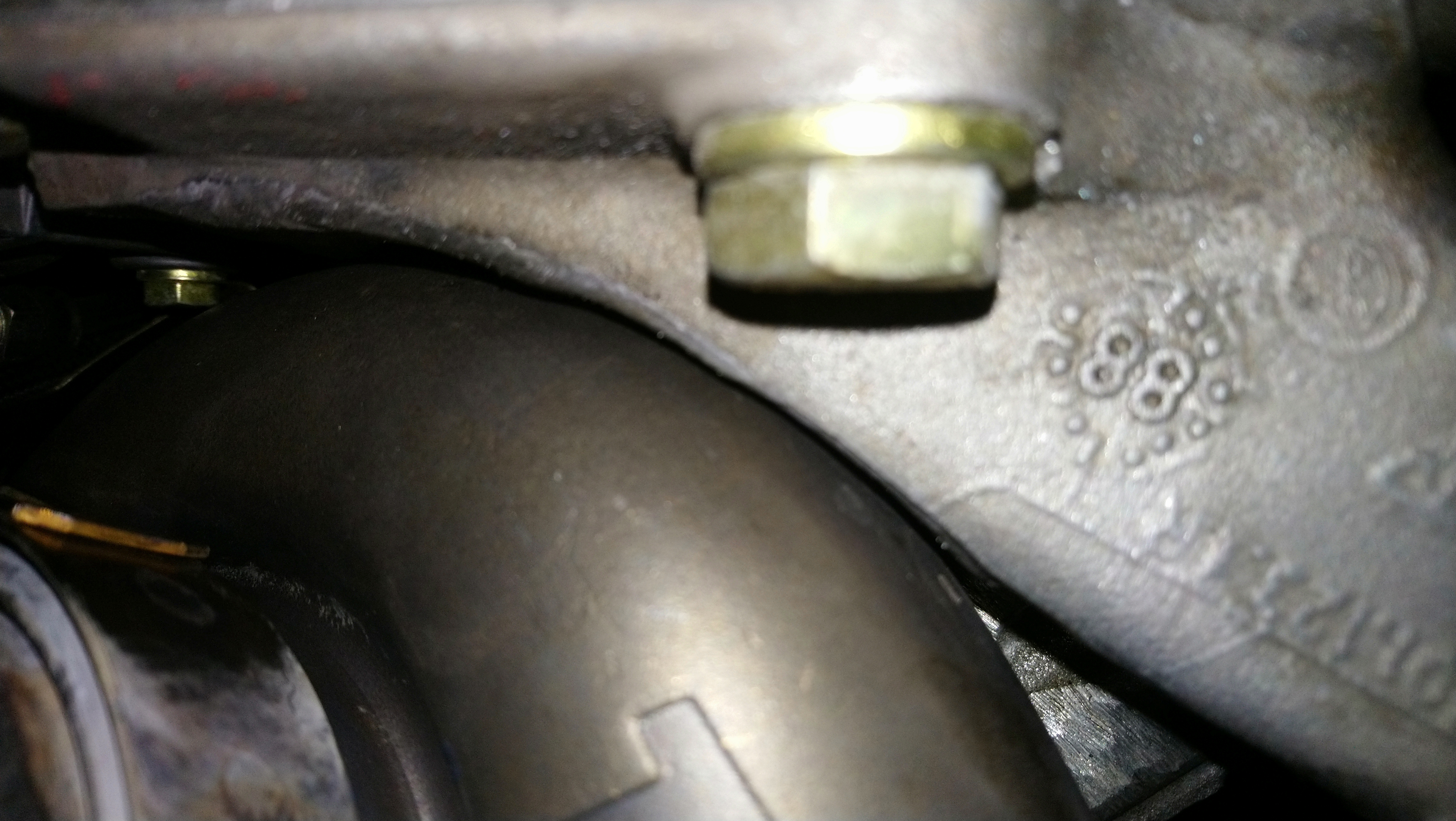

Here is a picture showing how close the 1.03 housing gets to the modified stock turbo mount. Spent some time today preparing the car for the biennial inspection coming soon and had a look at every corner for possible leaks/issue. All looking good.
