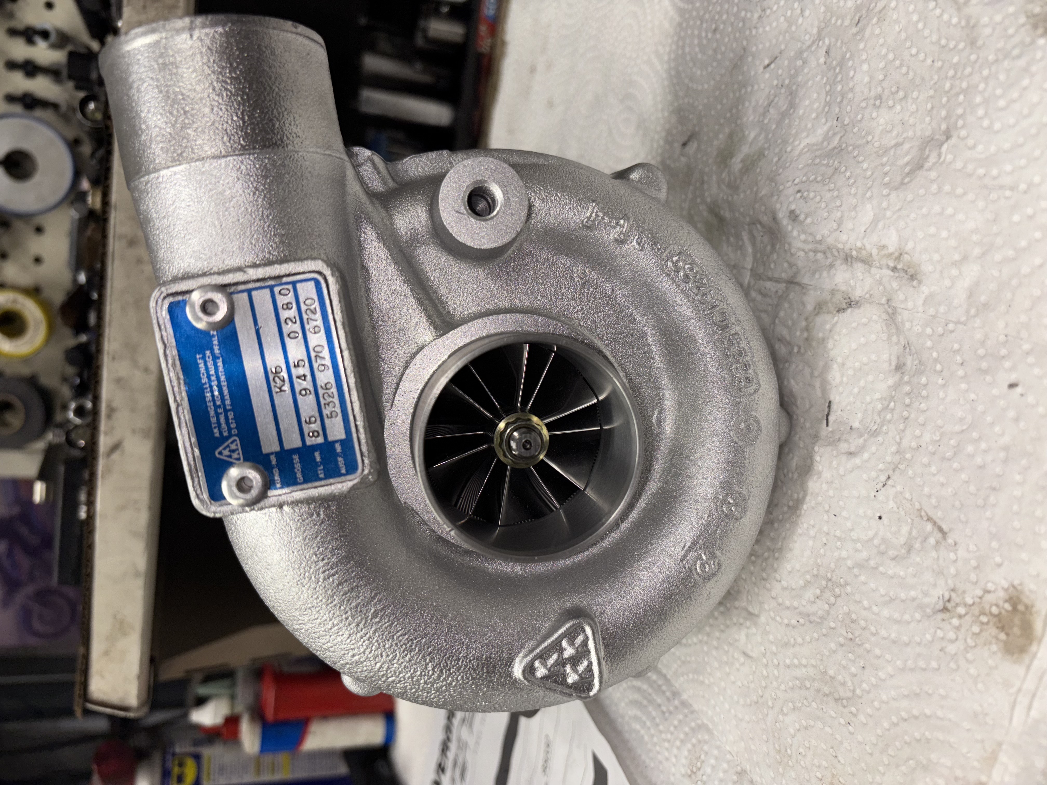

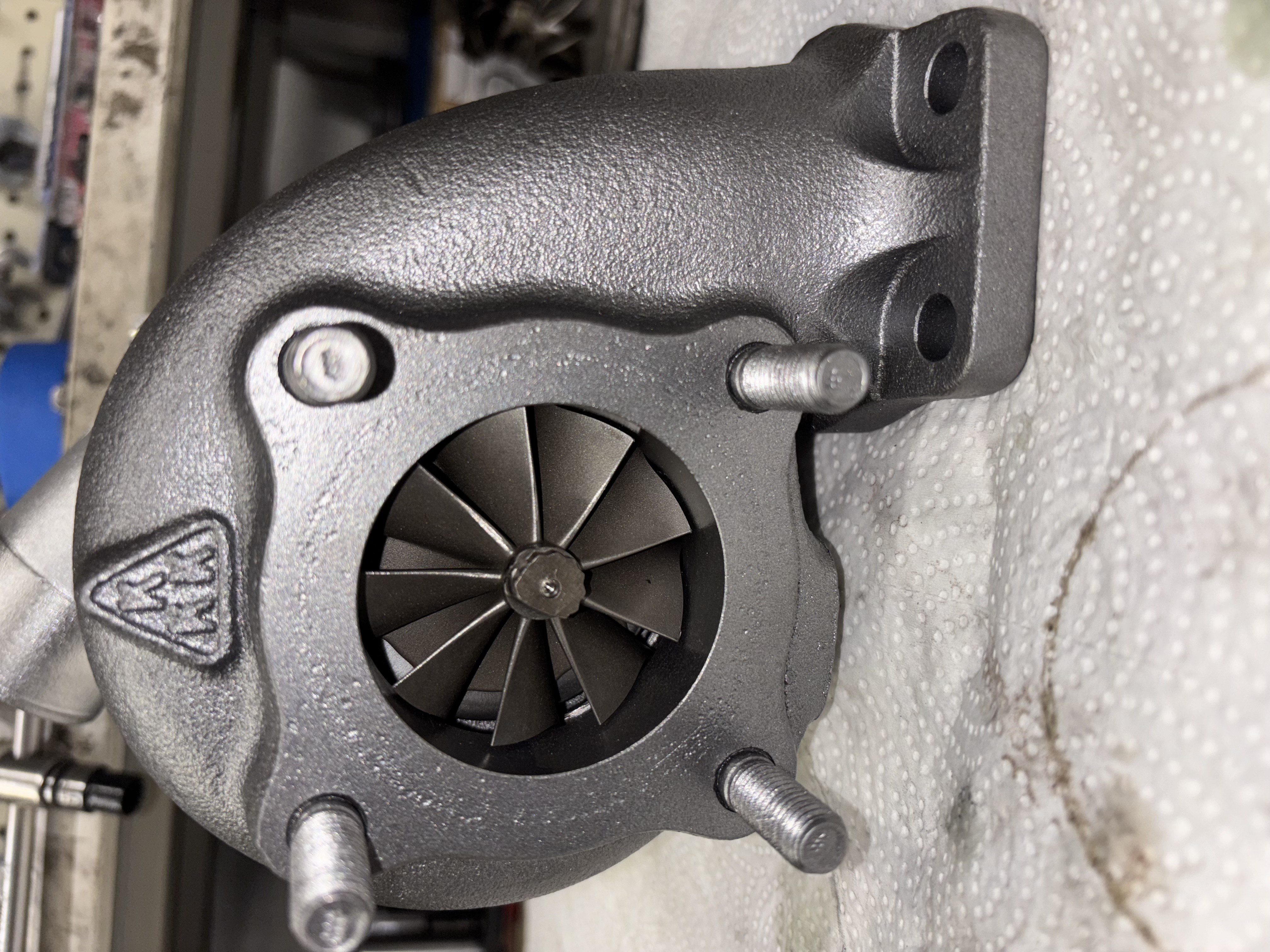

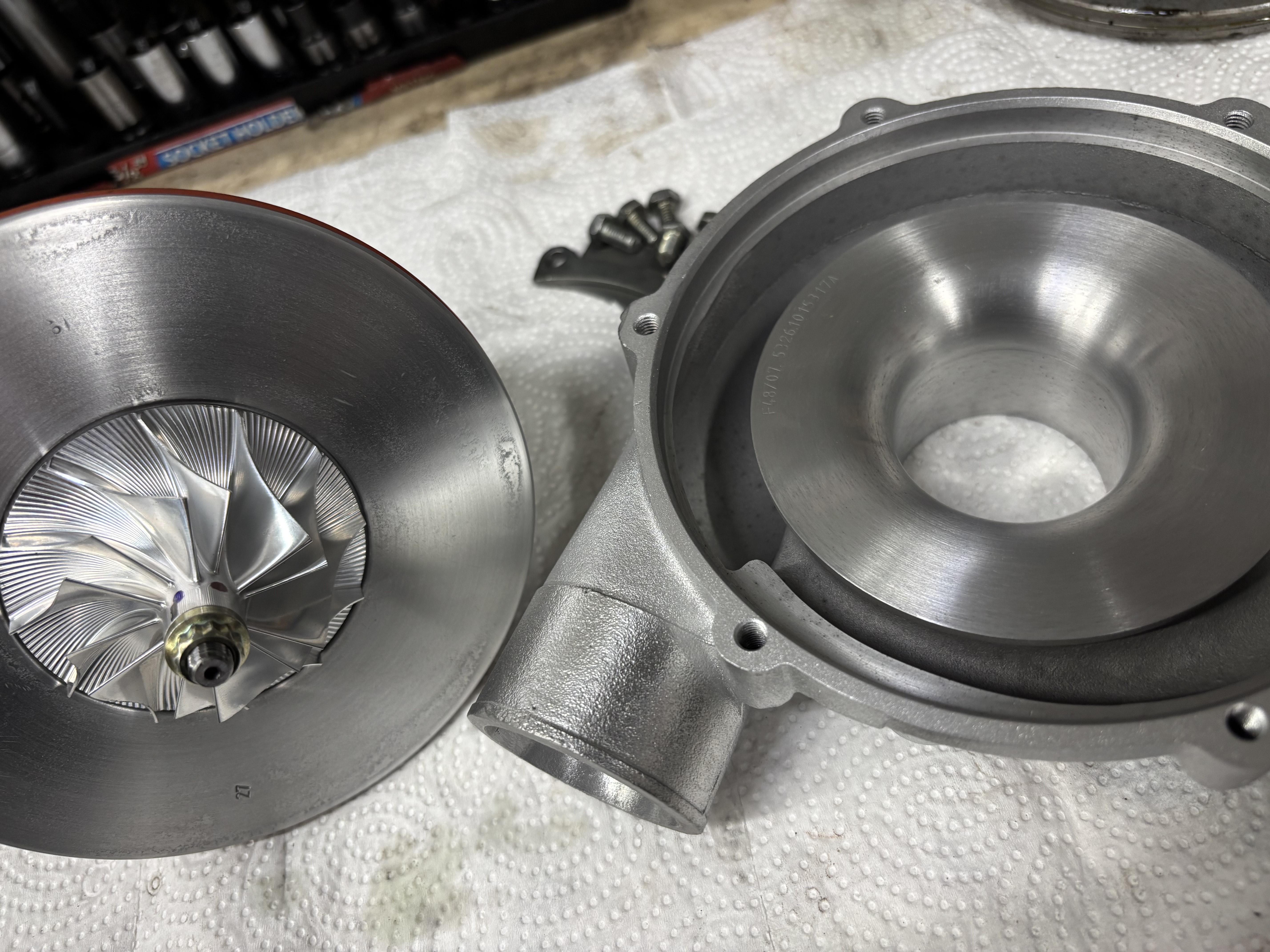

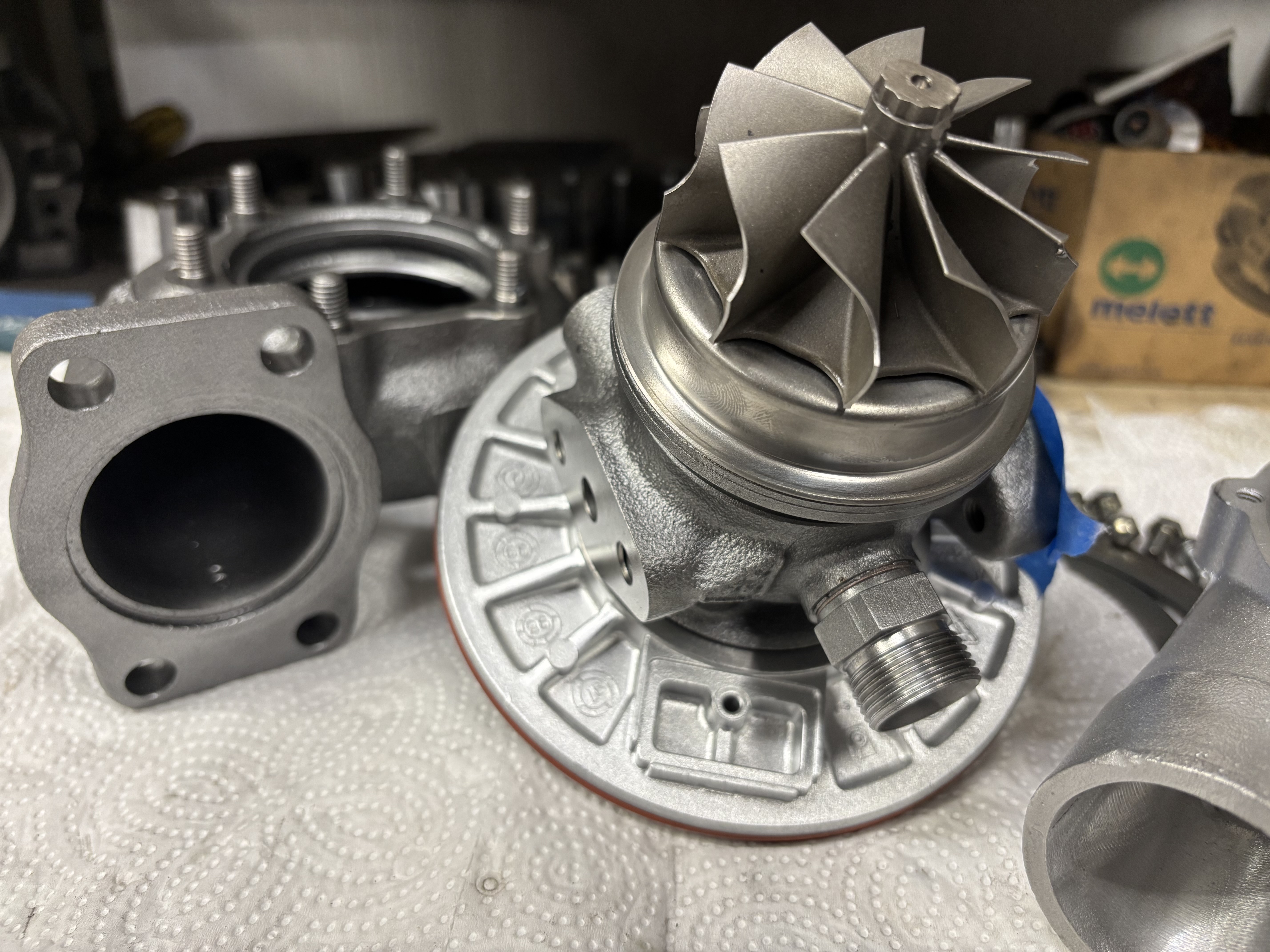

Turbo on its way back from Evergreen. 2 day turnaround!
Looking forward to trying out Charlie's upgrades (after break in period of course!)
