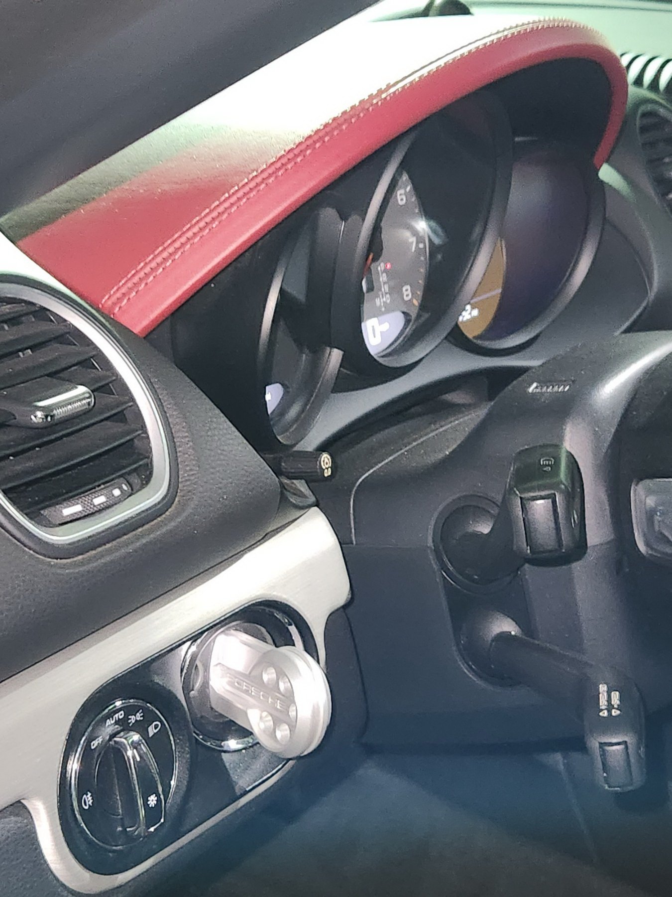

J-Dub wrote: Fri May 09, 2025 5:14 pm @ReidMcT How is that historic key? I am very intrigued. Does it look and feel natural in there, are you liking it?
I say the ONLY reason to buy this thing is because you think it is cool. I like mine, but it is expensive and impractical. It weighs several times the plastic part it replaces. To a bare hand, it feels sharp-edged, uncomfortable while turning. The machining is imprecise, and some buyers report that the key does not fit or is difficult to turn.
But it is a limited edition part, and the Steve McQueen connection is enough to tug at some of us.
Finally, I think the key bezel lighting looks really good reflecting off the aluminum; a nice glow.

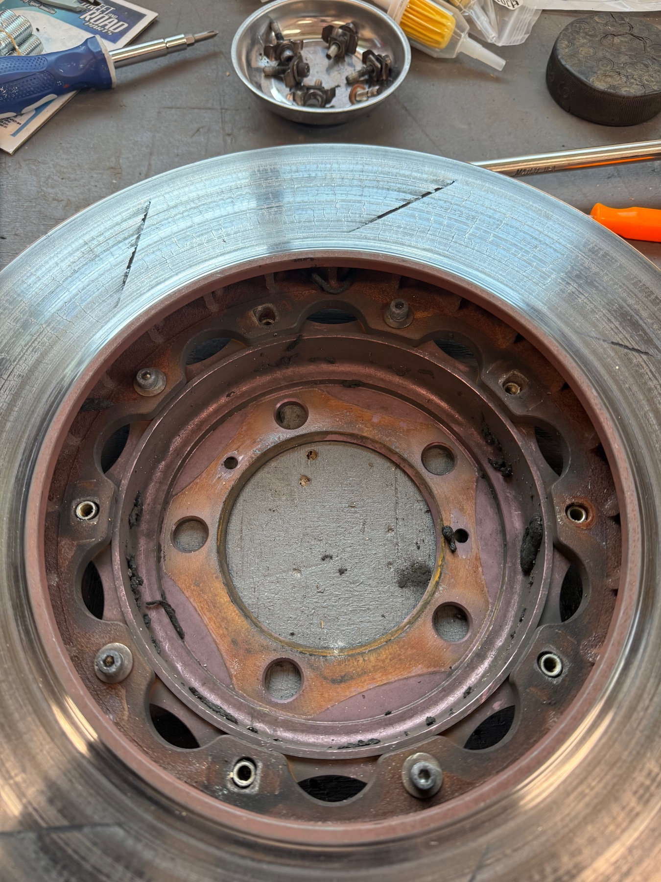

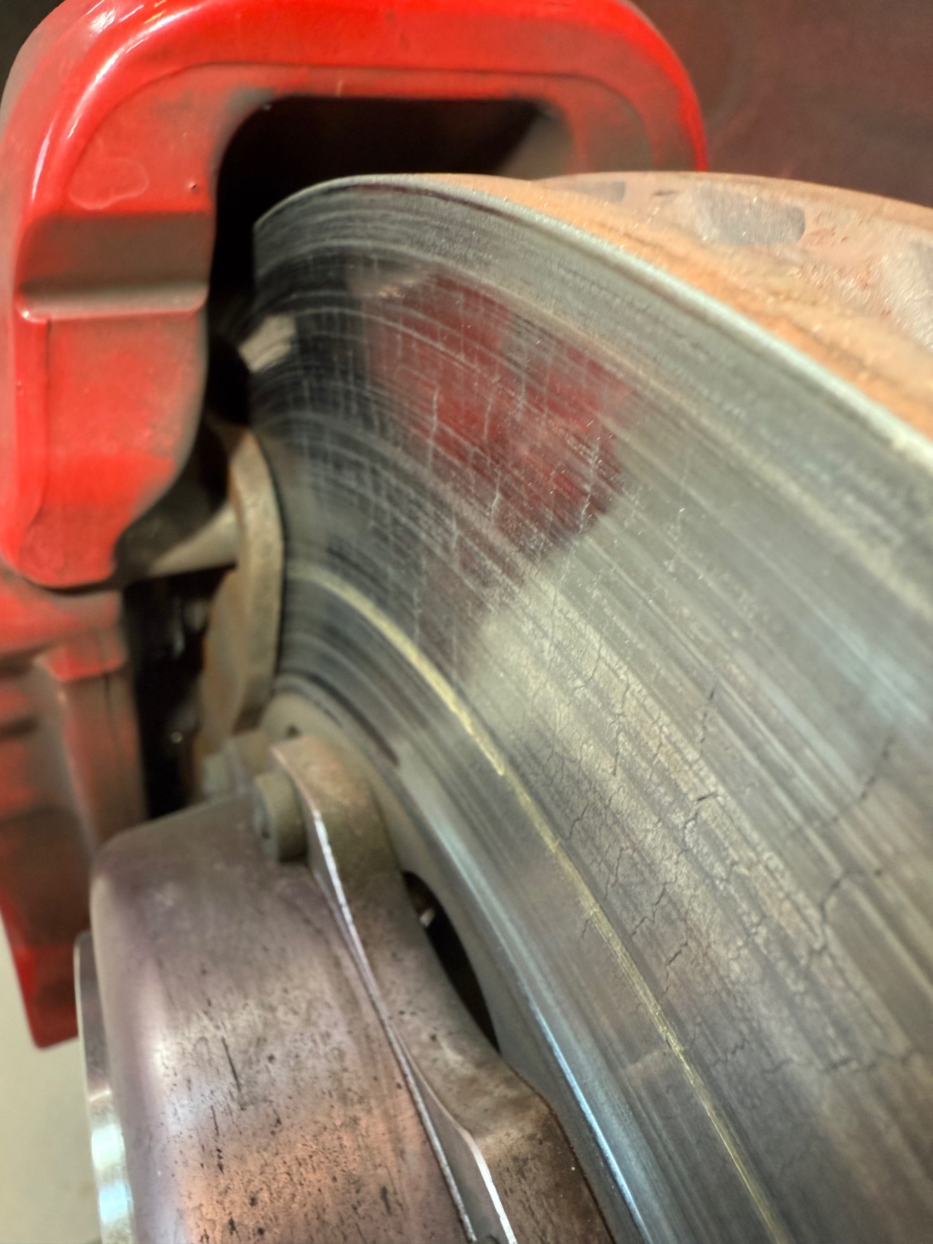

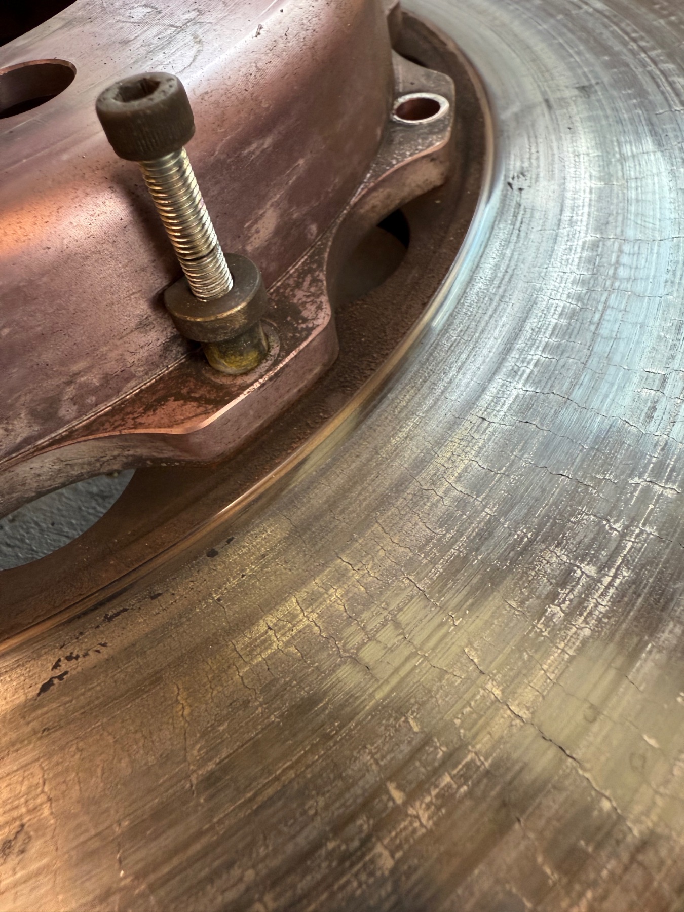

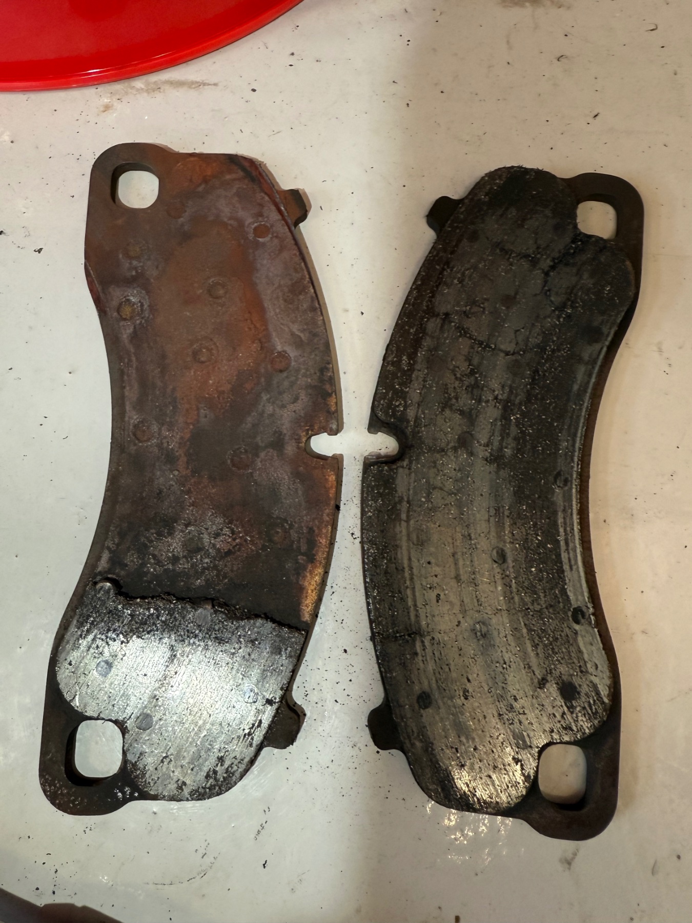

My brake pads were worse than I expected. 5 track days since my last quick inspection.
Started to disassemble the hats from the rotors on my GiroDisc. This is fun. :lol:

J-Dub wrote: Wed May 14, 2025 3:07 am My brake pads were worse than I expected. 5 track days since my last quick inspection.
Wow! I'd have thought the wear indicators would have some margin. Yours appear to have triggered only when the pad was gone.
I think I should make a habit of checking the brakes directly, not relying on the indicators (which are annoying to work with anyway).

Yes, I'd say your pads are kind of gone Jeremy! :lol:
I don't use the indicators - they tend to go bad from heat anyway. Wires are disconnected and zip-tied out of the way on the fronts. Also, since I rotate often (after every day or event), a quick visual and/or measurement with the simple color-coded lining thickness gauge is easy. I tend to log the measurements periodically too so that I have a more accurate idea of how pads are wearing and so that I don't forget what I measured... :(
