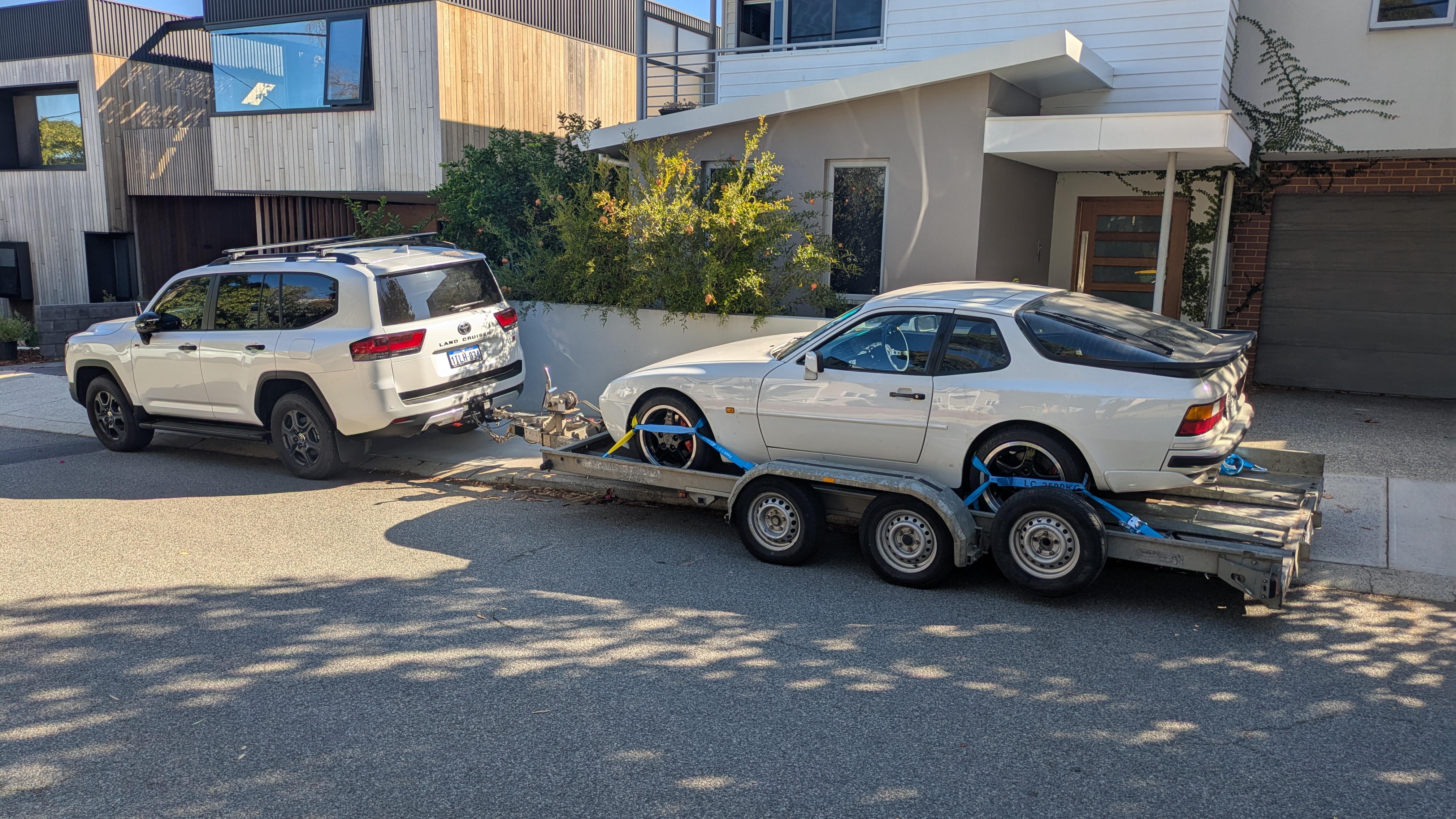

Off to the fabricators for inlet piping! Will be ready for a start and break-in after that.
