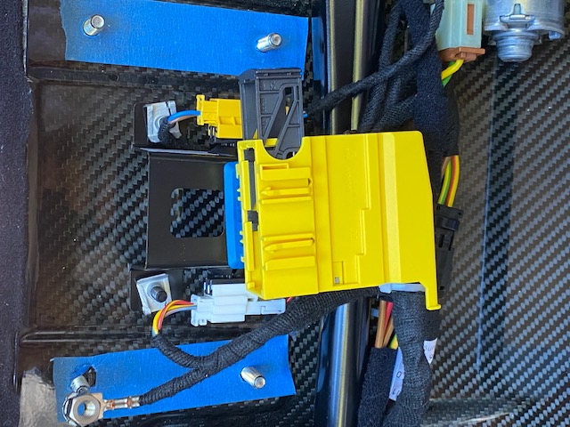

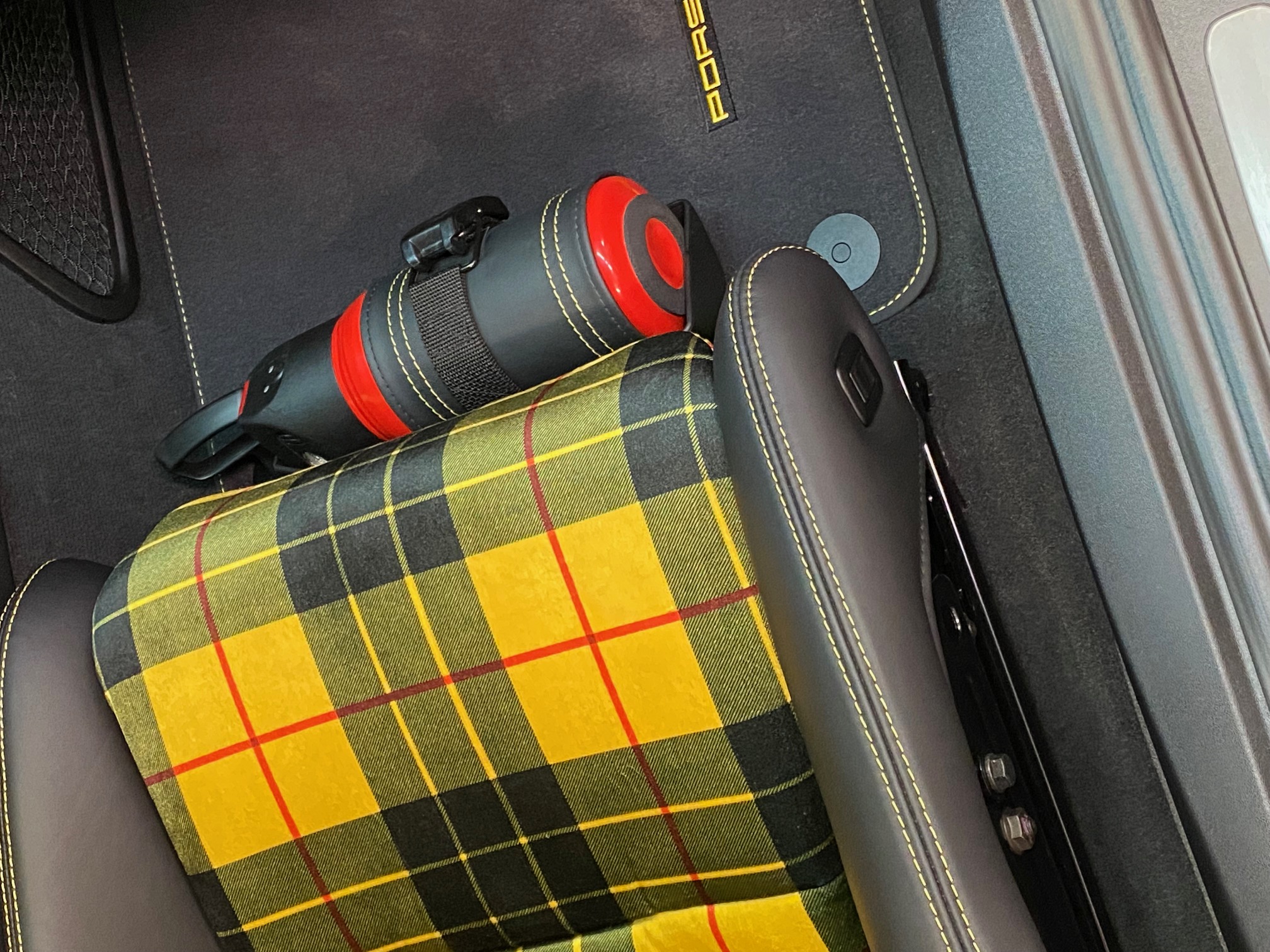

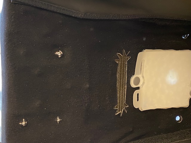

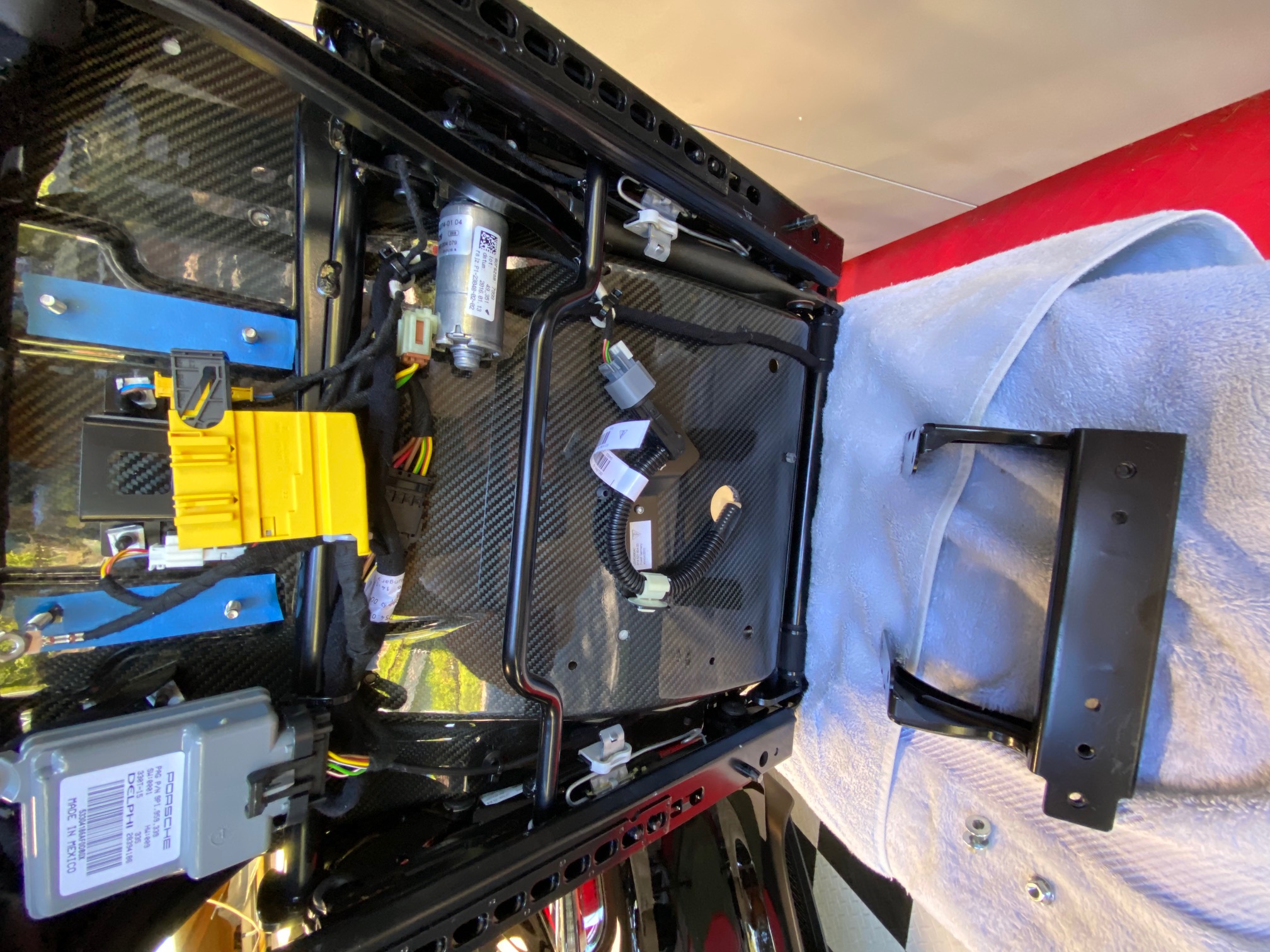

Hi Guys
Well ever since I made these Fire Extinguisher covers for a Porsche buddy of mine, I fell in love with them...
I never ordered the FE from Porsche, as I thought it would be best to use a Halon version. That was a mistake as these OEM Fire Extinguisher are only a 150 dollar option when you check the box when buying your car ... They sell anywhere from 350 - 500 in the after market !!
I wont tell you what I paid, but let's just say that the POS I bought it from was not an honest person ... He never included the under the seat bracket ( which is a must and costs about 250 from the dealer !!)
He's been banned from the forum that he posted on, not once, but twice !! The second time was final...
So I've been around the block on buying these, so I decided to see if the brackets could be made as that seemed to be the hard pill to swallow ... With a good buddy of mine who does CNC work, we came up with this bracket ( once powder coated I'll show how nice this came out )
In the meantime, I will post picts of the install I did ..
It requires taking the seat out in a GT4, prob not in a GT3, as you have room to lean the seat back in a GT3.
Once the seat is out, you need to go under the seat an poke 3 holes where the under the seat fabric is blocking the bolt holes... very simple and easy
Once that is accomplished you just put an X in the fabric and pull back that fabric so you can place the 3 bolts through the bottom of the seat.
The fourth bolt is already there as its a ground wire ...
Let me know if you have any questions
