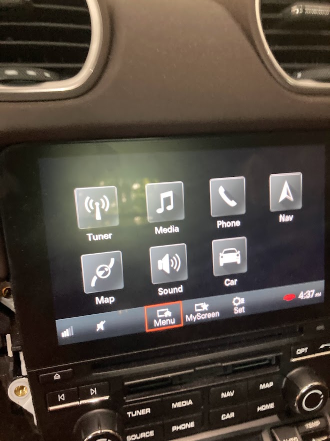

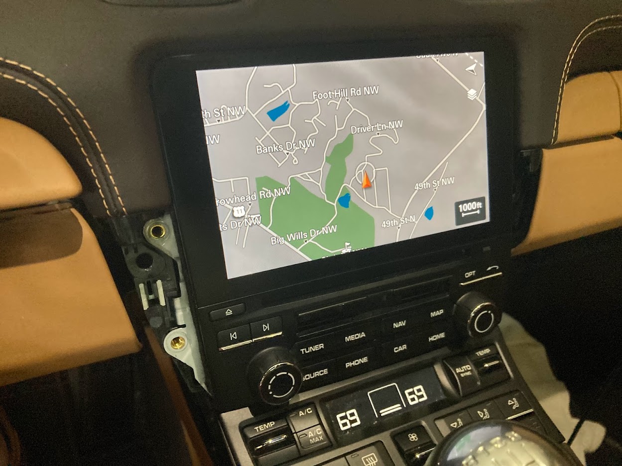

by Bill in Bama
Success! We got back together today and downloaded new files on my SD cards, remotely connected my car to his PIWIS so the cluster was enabled, and I downloaded the Nav and Map functions and the map files on my PCM and everything is up and running just like factory. I'm like a kid at Christmas after so many hours trying without success. If you have any tech sense at all this thing is a breeze to install on your PCM.
Home screen.jpg (101.14 KiB) Viewed 1809 times
PCM map.jpg (243.19 KiB) Viewed 1809 times
The trim is removed because I thought I was going to have to add a gps antenna but my car already had one, so I've put them back and everything is great now.

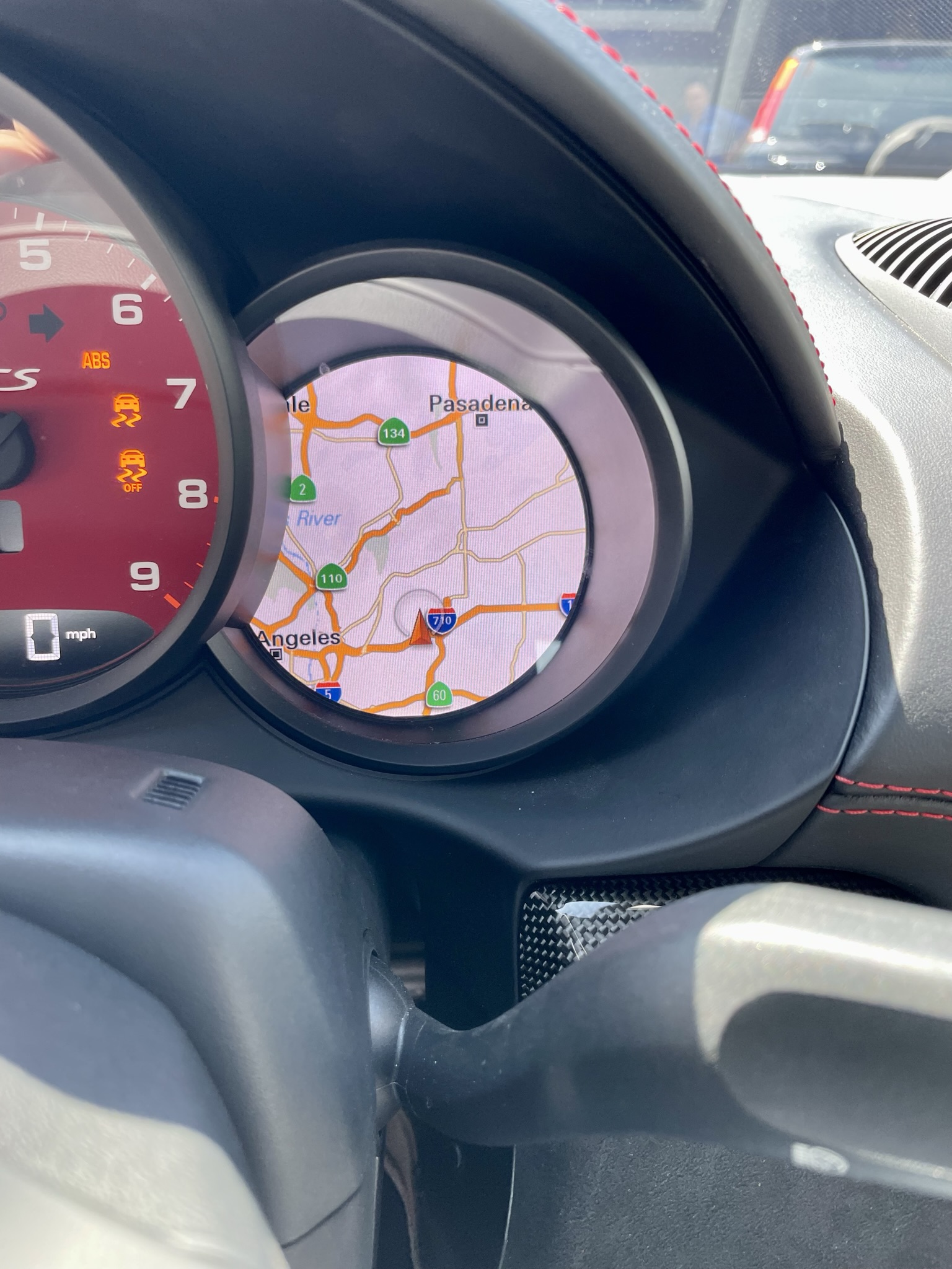

Yes it's a little bit of mystery for the GPS antenna. I have seen a couple 2017-18 Cayman with the GPS antenna installed and some without. All the MY2021 and 2022 GTS GT4 that I have worked on had the GPS antenna. It either comes with Carplay or Porsche Connect depending on your build.
For those interested, here is the link to download and flash your PCM to enable NAV, Carplay, Android Auto, Wi-Fi Hotspot, AUX, Track Precision App etc...
https://github.com/harman-f/MHI2_US_POG ... MU1476-AIO
Please check your version of PCM and see if it's supported first.
NAV requires a GPS antenna
MAP in cluster TFT display requires an LVDS cable and PIWIS coding.
