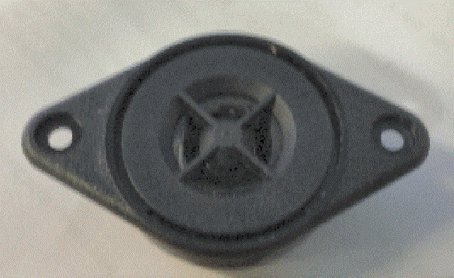

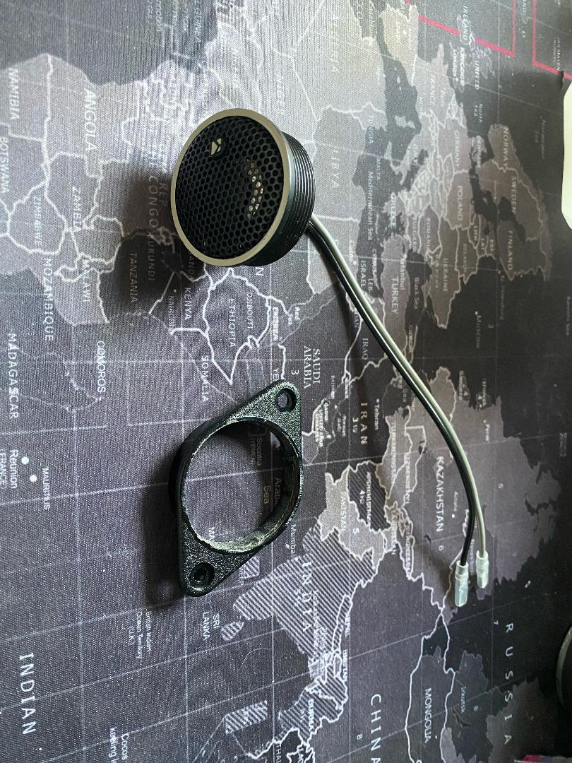

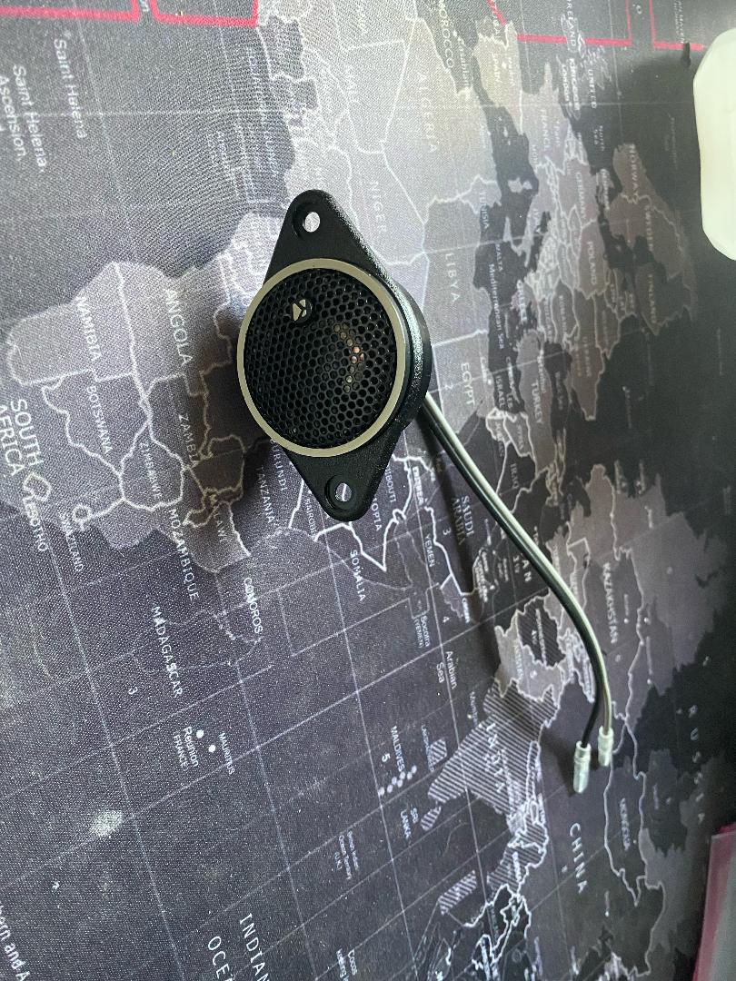

My hunt for a replacement tweeter failed. No one has anything, anywhere and I decided not to try and rely on a tweeter that was the same age as my others so I bought new ones. I was worried about mounting (since OE is such a weird shape) but I think I found a great solution.
I had to cannibalize the old tweeter to get the front face/mounting frame, but after a few minutes with a dremel, I had a good starting point. I still need to recess the tweeter about 2-3mm, but that should be easy enough.
Here is what the original tweeter looked like:
And this is where I'm at now:
