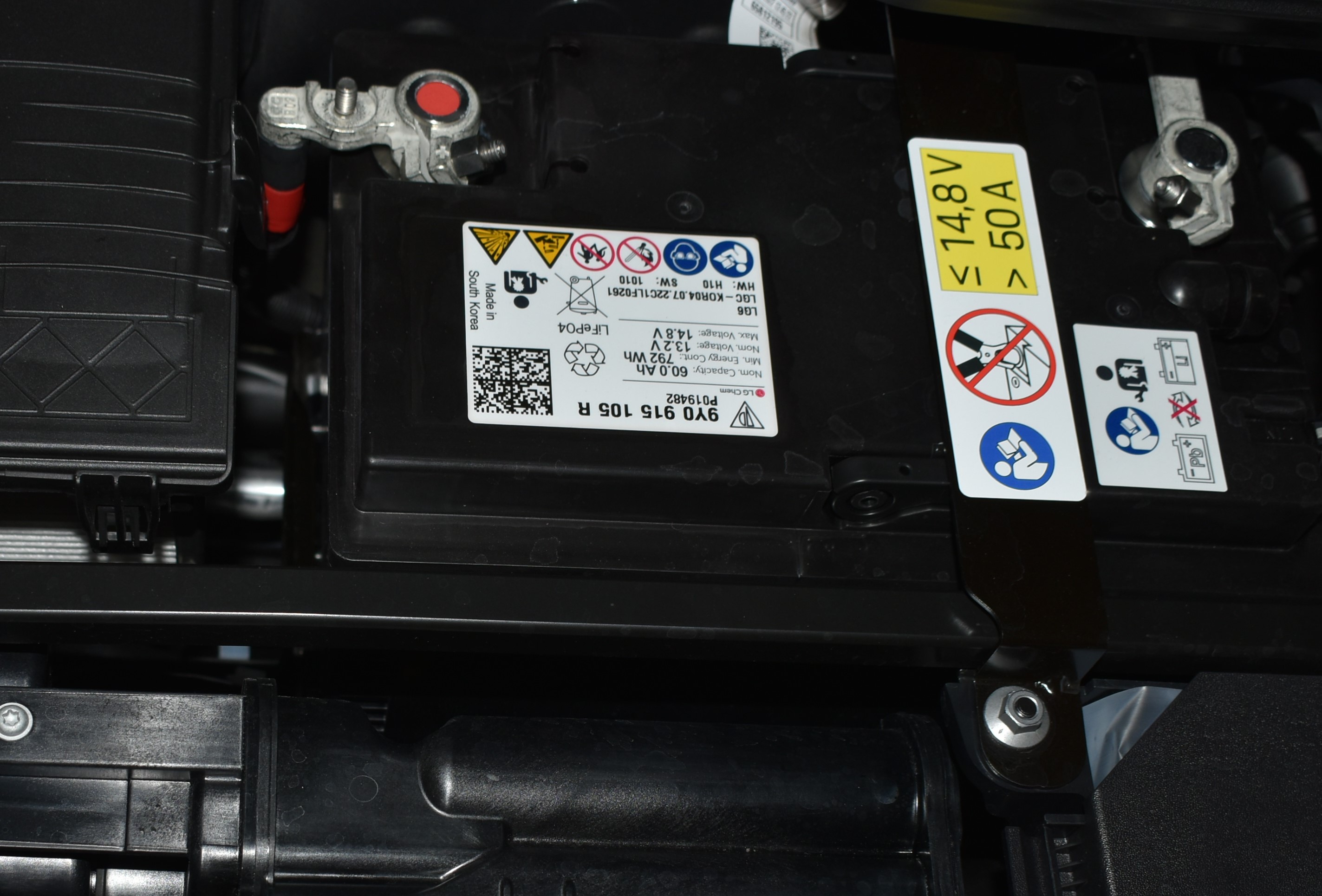

Thanks for the reminder. The battery is made in South Korea.

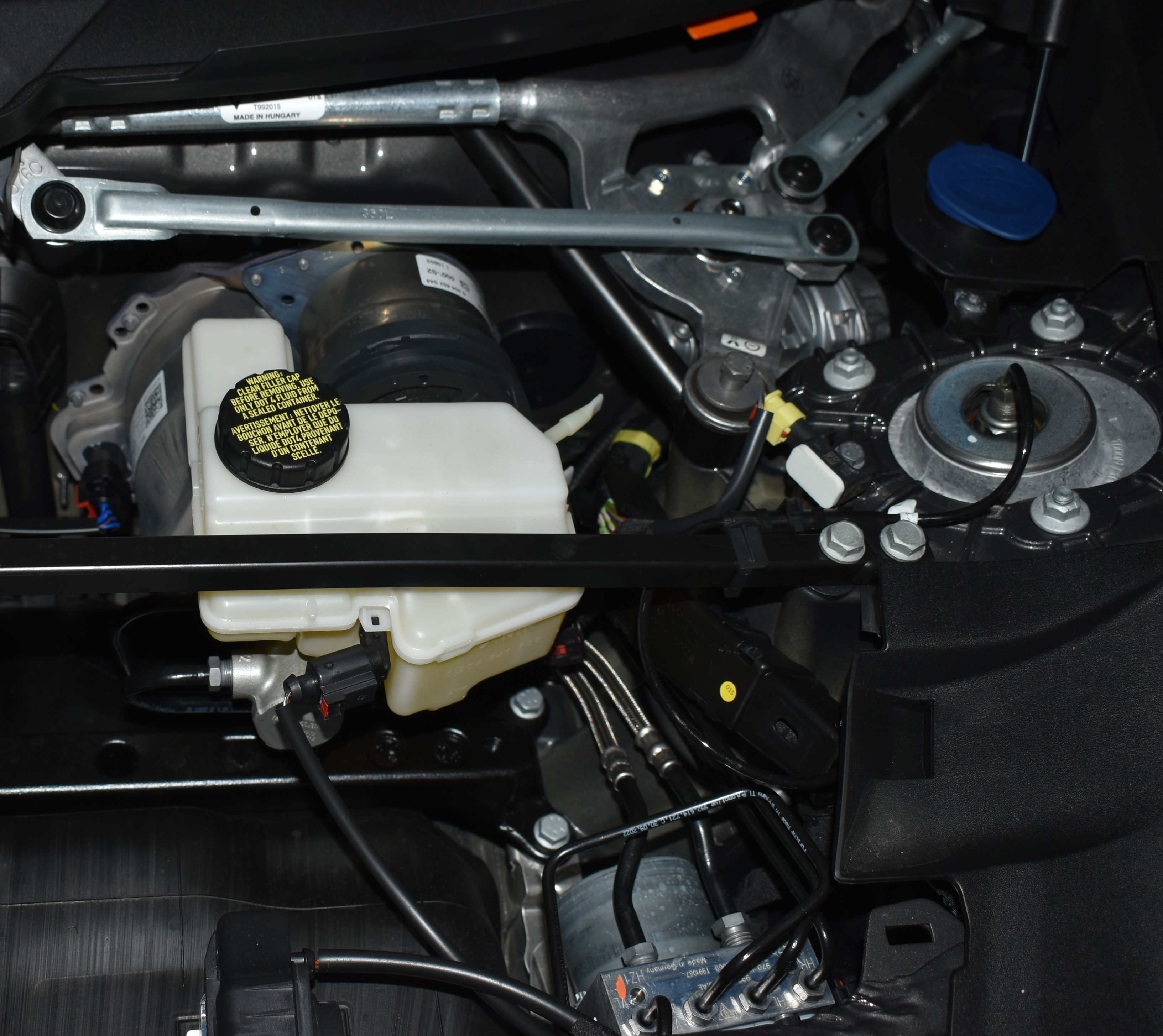

Here is the other (driver's) side. I noticed wiring going into the top of the front struts. I guess this for the suspension? It sends a signal to stiffen the fronts?
This is a change from the 2020 Carrera. I remember going away for a month and attaching an old-style trickle charger to the battery. It worked well.
