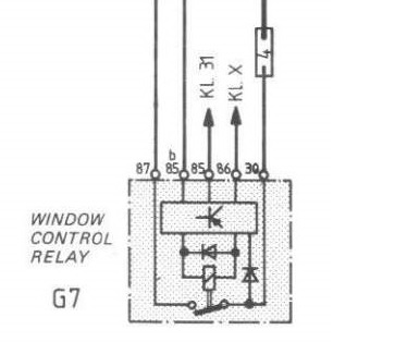

Well mystery solved.... Is there anything special about the power window relay or is it just a standard relay?
Re: Windows work with ignition off
Posted: Wed Jun 24, 2026 9:20 am
by soxnail
Richey ,
When a relay has the transistor symbol in it, it means that there is some control logic built into it. So no its not just a general purpose relay.
