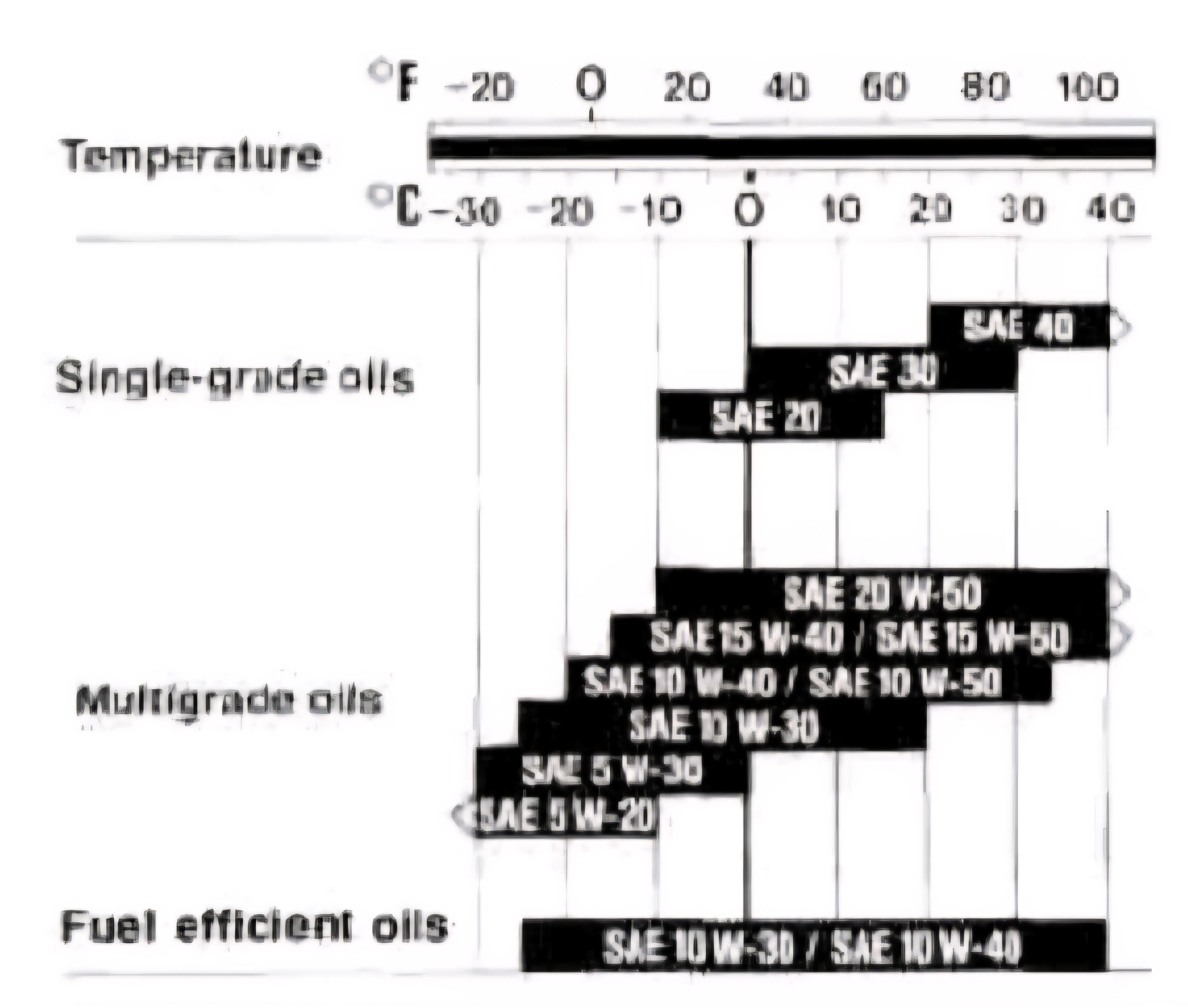

I don't think anyone mentioned but climate plays a role: I am not sure if 15w is too thick for my winters 😂
Actually.. according to that Porche chart.. I shouldn't even be using 10w40 in February 🤣

I was concerned this past winter. I had 10w40 in the engine and we were getting down into the -10's at night in NY. I even drove the car on a day it was -6F when I started it. Drove 6 hours that day and had no issues.
We also got up to 100-104F a couple times last summer... So Im really using the full range of that oil.
I also dont break 3000 miles a year, so I usually change my oil once a year... but Im considering putting 10w30 in it this fall, then back to 40 in the spring.
