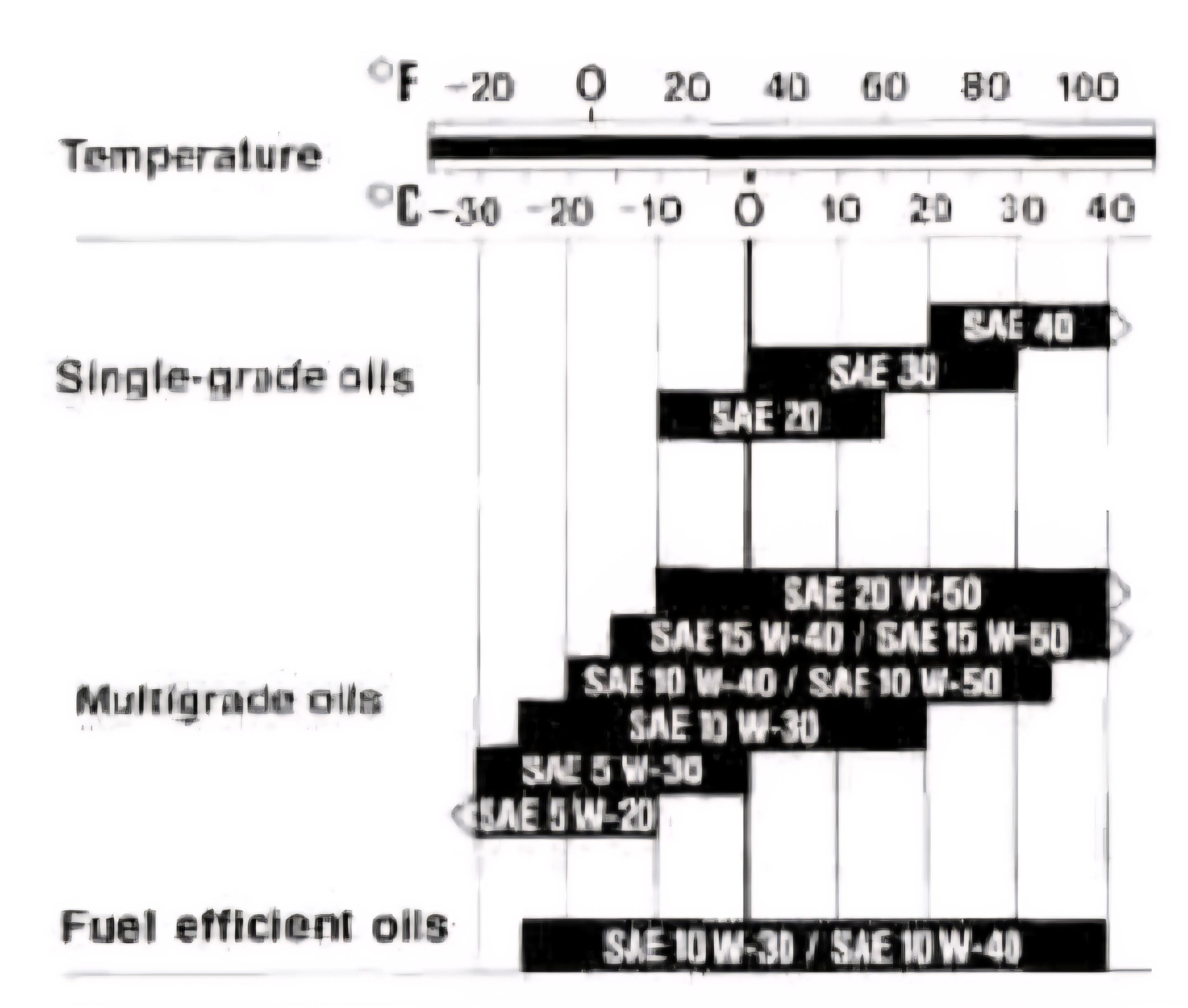

I don't think anyone mentioned but climate plays a role: I am not sure if 15w is too thick for my winters 😂
Actually.. according to that Porche chart.. I shouldn't even be using 10w40 in February 🤣
