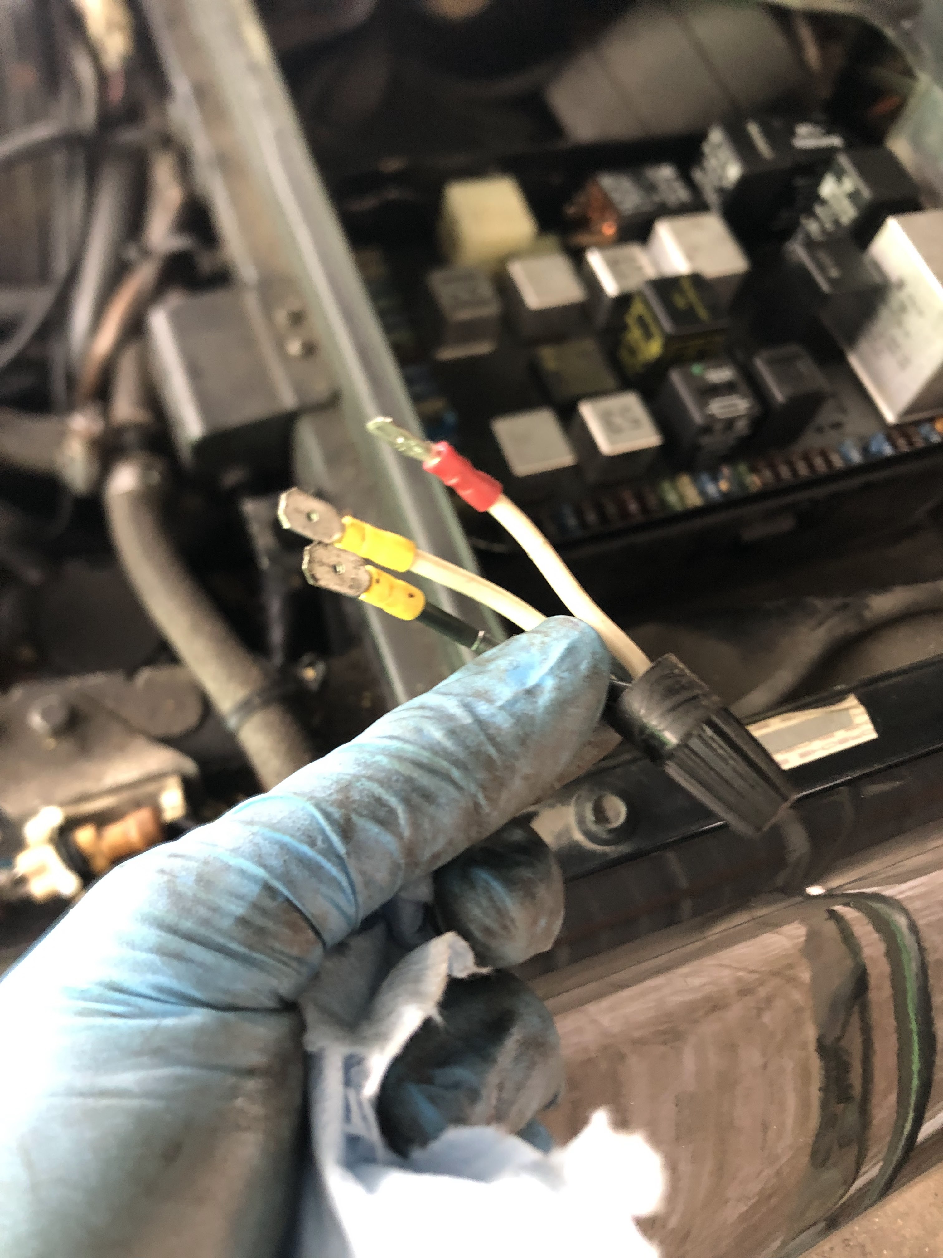

I found a pic... but I can't remember which terminals they are! What's funny is this adapter I made sits in my car and the wires are so stiff, they keep their orientation so when I use it, is just lines up with the terminals :lol: :lol:
I took a look at that write-up on Clarks.. man it's complicated

The carpokes version tries to make it more visual and less complicated. :angel: And our version points out that the socket has 3 wide slots and 3 narrow slots. You can bypass the relay by remembering to jumper the 3 wide slots. In fact if you make your jumper with wide spade connectors, you can't do it wrong. :)
