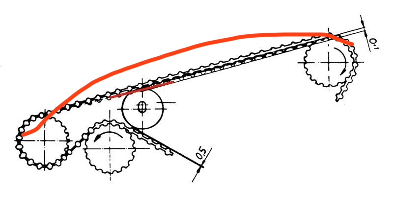

1st start after 1st time doing timing belt.
danmartinic
Posts: 302
Has thanked: 27 times
Been thanked: 46 times
In reality, looks like this
Richey
Posts: 62
Joined: Tue Jul 01, 2025 7:18 am
Been thanked: 9 times
I got home and messed with the belt and I've got it loose enough that I'm afraid to go any further and the pitch has not changed at all. If anything it sounds like it's louder at 2k rpm. For testing is it safe to just remove the idler to see if the sound goes away?
I also changed the tension in small increments on the accessory belt just to see if it would change pitch incase that's the source and that didn't change either.
At this point I'm confident I'm not too tight and likely on the looser side of things.

I don't know if they every go completely quiet. Your warm engine video sounded very quiet. Also, the cover really quiets things down too once its on. So comparing to other cars or videos - that's a challenge.
I've been around a few well tensioned cars (apparently with the porsche tool) and they have all made a bit of a whine - so I'm not sure what's correct but I feel like you must be pretty close to excellent.

The balance shaft belt tension is not super critical. Over tighten it will wear the balance shaft bearings in the long run as well as making the classic (and annoying) belt wine. When running you can see the belt ‘bounce’ a little during rpm changes – that’s why Porsche used a roller to stop too much bounce.
It would have to be seriously loose to jump a tooth.
