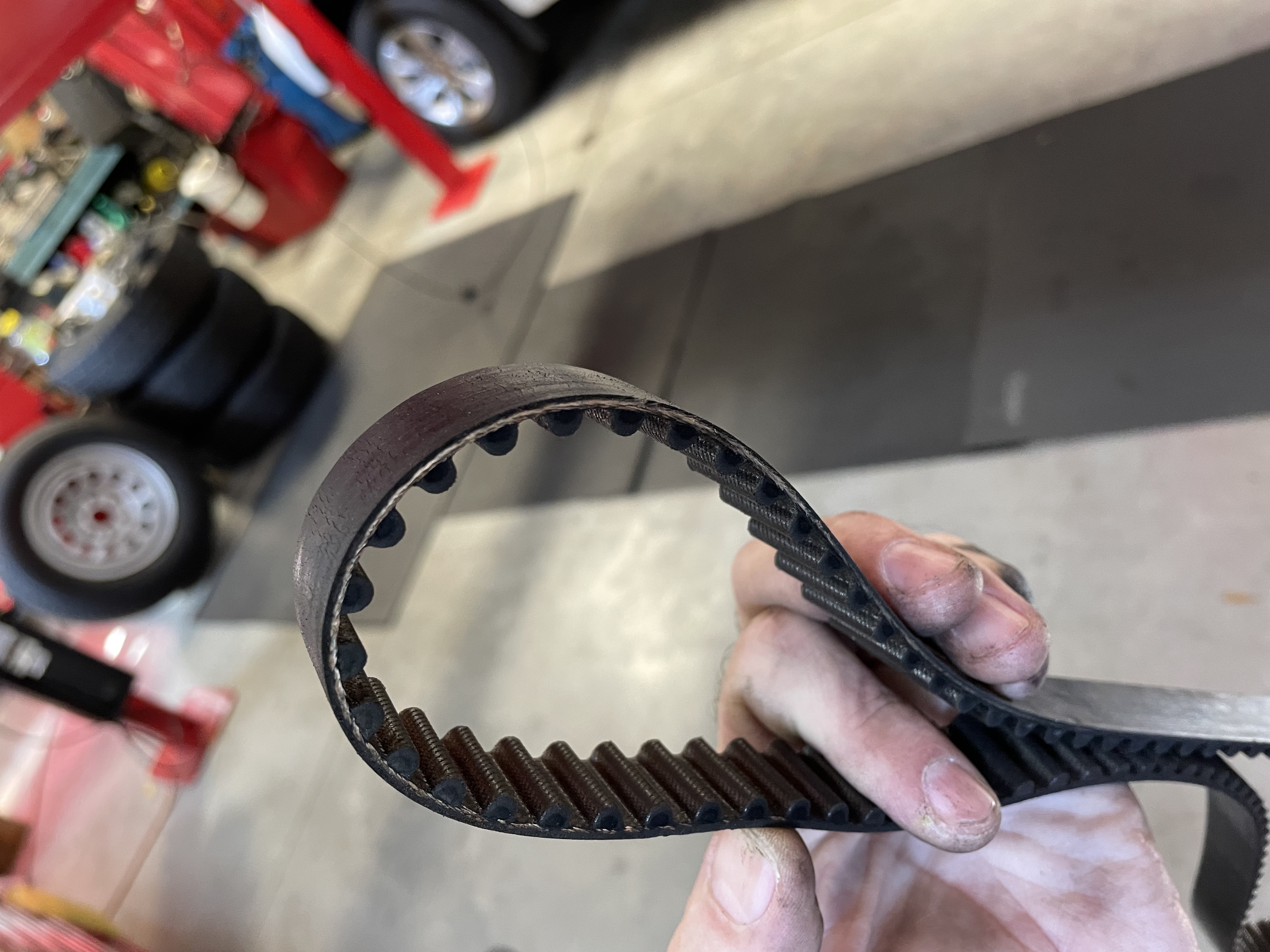

So next up was replacing all the belts and most importantly the cam timing belt. Once I removed the timing covers I found the original water pump and none of the updates that accompany a new water pump so it was confirmed that everything on the front of the engine was original. Here are photos of the original cam timing belt and water pump.
In the second photo you can see that the timing belt was extra crispy with strands hanging out of it and certainly would have broken had I tried to turn over the engine using the starter before replacing it.
After making sure the tensioners and pulleys spun freely and smoothly I replaced the timing belts with new ones, removed the spark plugs and gave the starter a try using a remote hand switch so I could be under the car to watch everything as it spun. To my relief the crankshaft spun smoothly with no bad sounds coming from the engine and it built full oil pressure after about 10 seconds. Next I put the spark plugs back in and ran the starter again listening to the compression pulses and everything sounded normal so I was pretty sure the engine would start if it had fuel and ignition. Little did I know that those two things were going to be difficult to obtain.

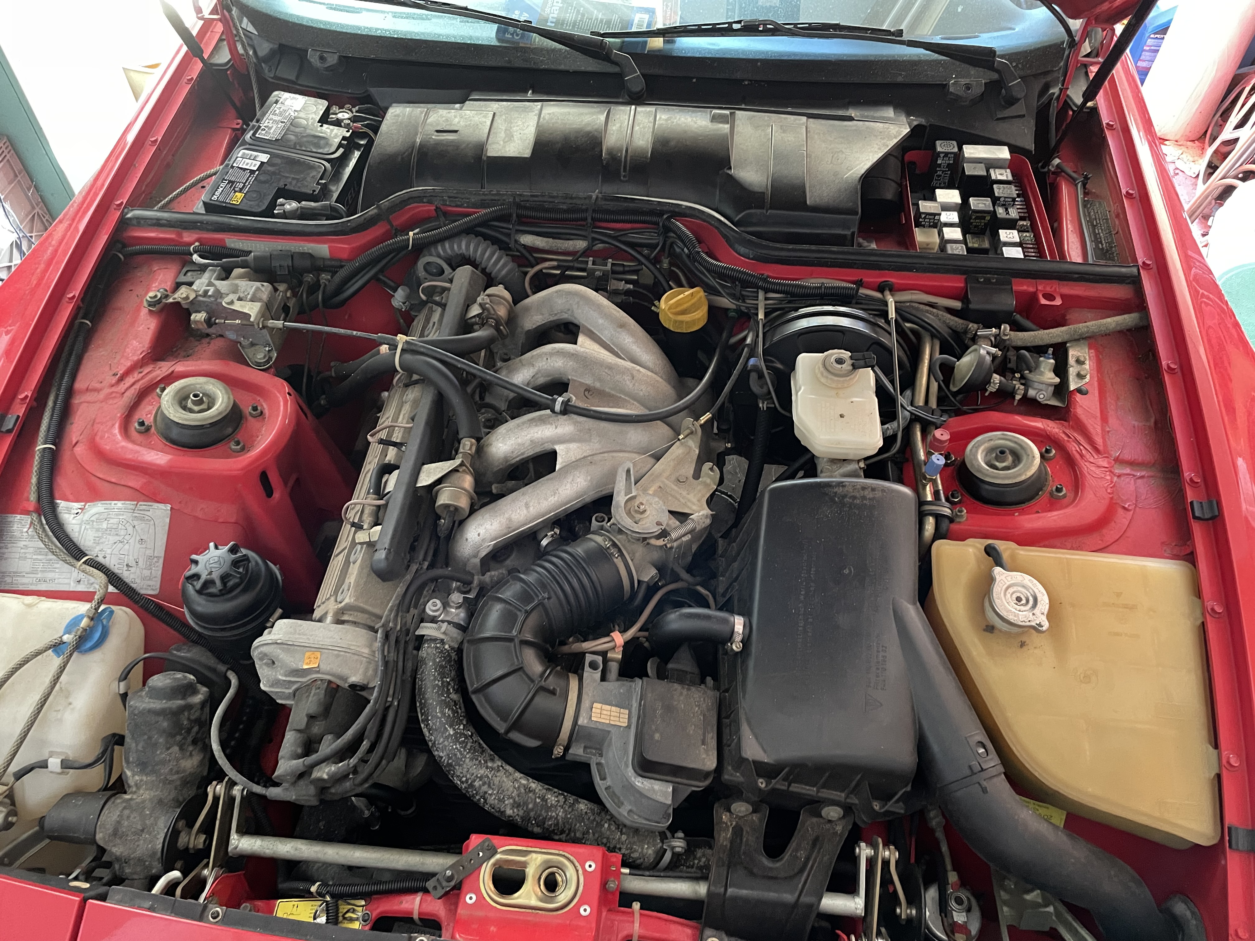

Is that an oetiker clamp I see in your picture (see arrow below)? I'm suddenly wondering which of my many worm clamps were originally oetiker clamps. Have any more overall pics of the engine bay. Who knows what else might jump out. :)

Here's a photo from the hoarder's garage of the engine bay the day we were finally able to open the driver's door enough to get at the hood release lever.
The odd wiring and black switch bracket by the hood release and running along the windshield washer hose are from a vintage Alpine alarm system that has since been removed (remember I mentioned ignition problems?). The 134a retrofit fittings are also not original which has led to my current A/C problems but more on that later. The battery is not the original and the missing fuse/relay box cover and battery cover in this photo were found next to the car and reinstalled before I brought the car home.
By the way, that is a moldy radiator hose, set of ignition wires and headlight motor cover!

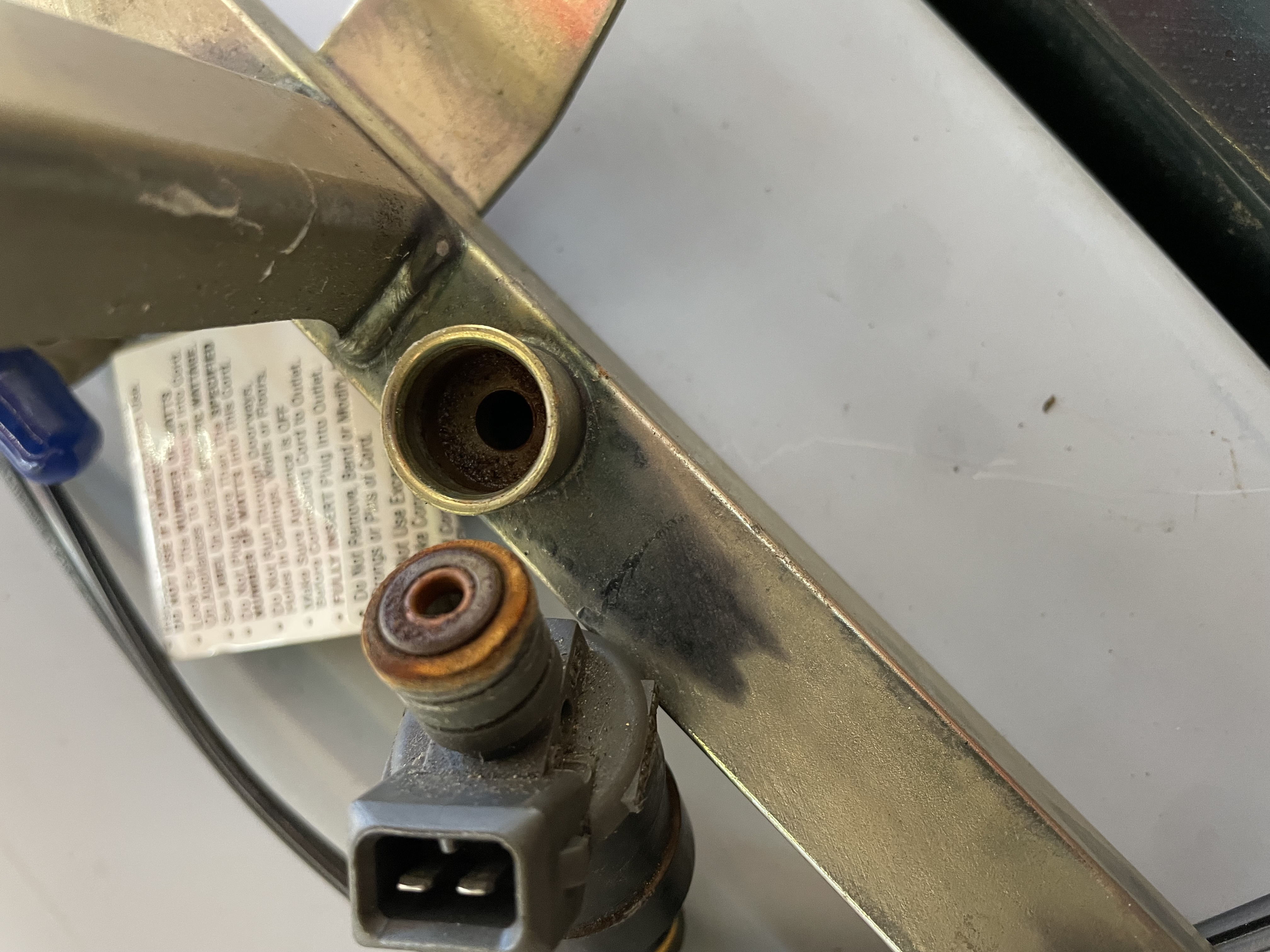

Considering the sad state of the fuel system, I'm sure you already ordered a new strainer and in line fuel filter, but I would pull the injectors. There's o-rings and hats on them, plus a little filter. They very easy to clean, I do it with carb cleaner.

Yes, I replaced everything from the filter back to the tank and in the end pulled the fuel rail and injectors only to find them packed full of rust. The fuel rail had rusted internally and filled the injectors with rust so badly that they wouldn't even click when 12V was applied to them. I ended up filling the fuel rail with the injectors still attached with Evapo-Rust and letting it sit on my work bench for a day. The Evapo-Rust removed and dissolved all the rust in the rail and the injectors and then I ran pressurized carb cleaner forwards and backwards through the injectors while tapping their contacts with12V from a battery until they started making nice a nice conical mist pattern again. Here's a photo of the rust after pulling the injectors from the rail.
After treating and cleaning, the rail was silver metal internally again and the injectors were functional again. Evapo-Rust brought the fuel system on this 944 back from the dead!
