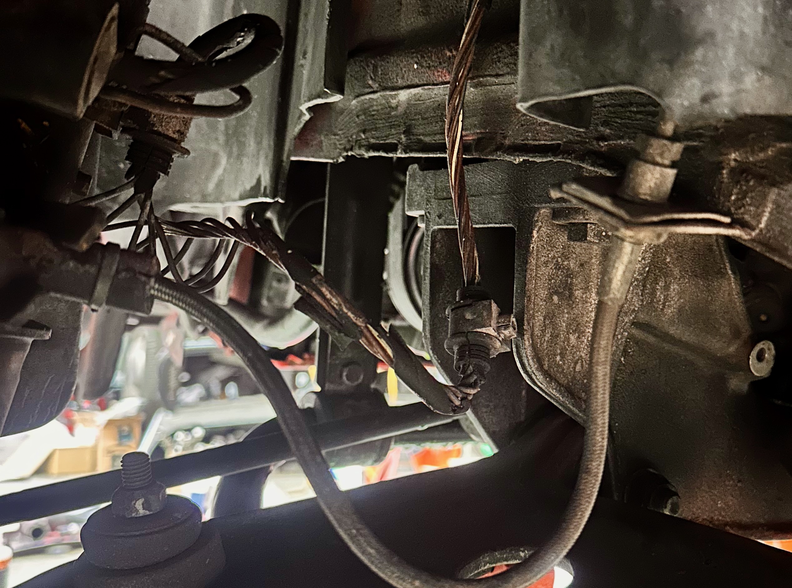

Bumping this thread to get a little advice on my decaying harnesses in the wheel well. This image is the front drivers side wheel well from the back. The sheathing on the harness is completely gone, but for now the insulation on the individual wires seems intact, and I don't have any warning lights.
I'm assuming the only functions here are ABS and brake wear? My plan is to just rewrap the wiring in high temp cloth tape and go on about my day, but I want to confirm there isn't anything safety critical if it fails, nor any readily available new or NOS wiring that I can plug in at the front two corners without having to dig deep into the full body harness.
Any other recs for a fix on a car that needs to be safe and reliable but not concourse ready?
