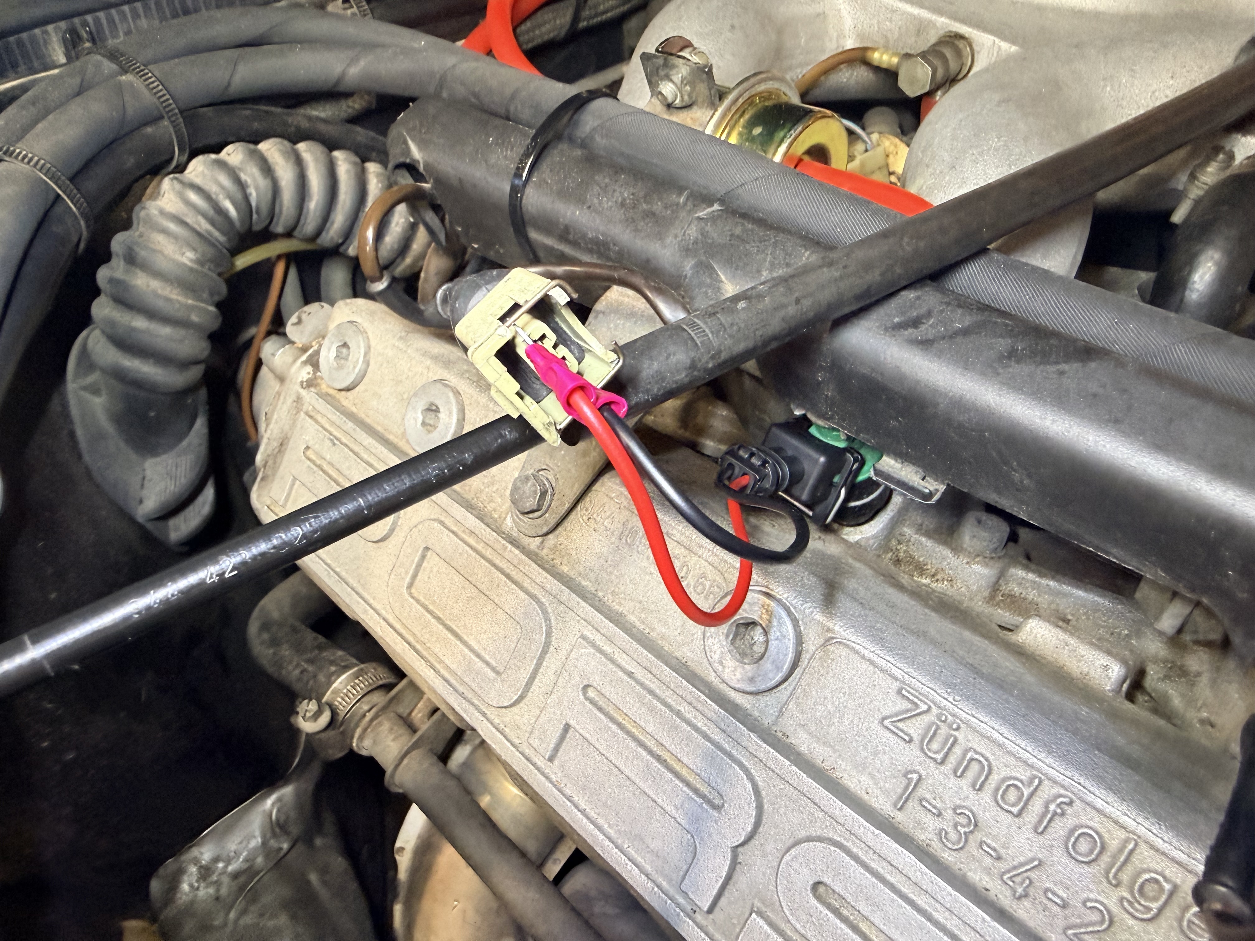

I decided to grab a couple of the aftermarket EV1 connectors that I had laying around. I did a very crude test and plugged 2 of those connectors to the injectors and pigtailed them to the OEM connectors.
The car started fine after I did this and idled fine for a while. I pulled the pigtails off and plugged the old ones back in and the issue persisted.

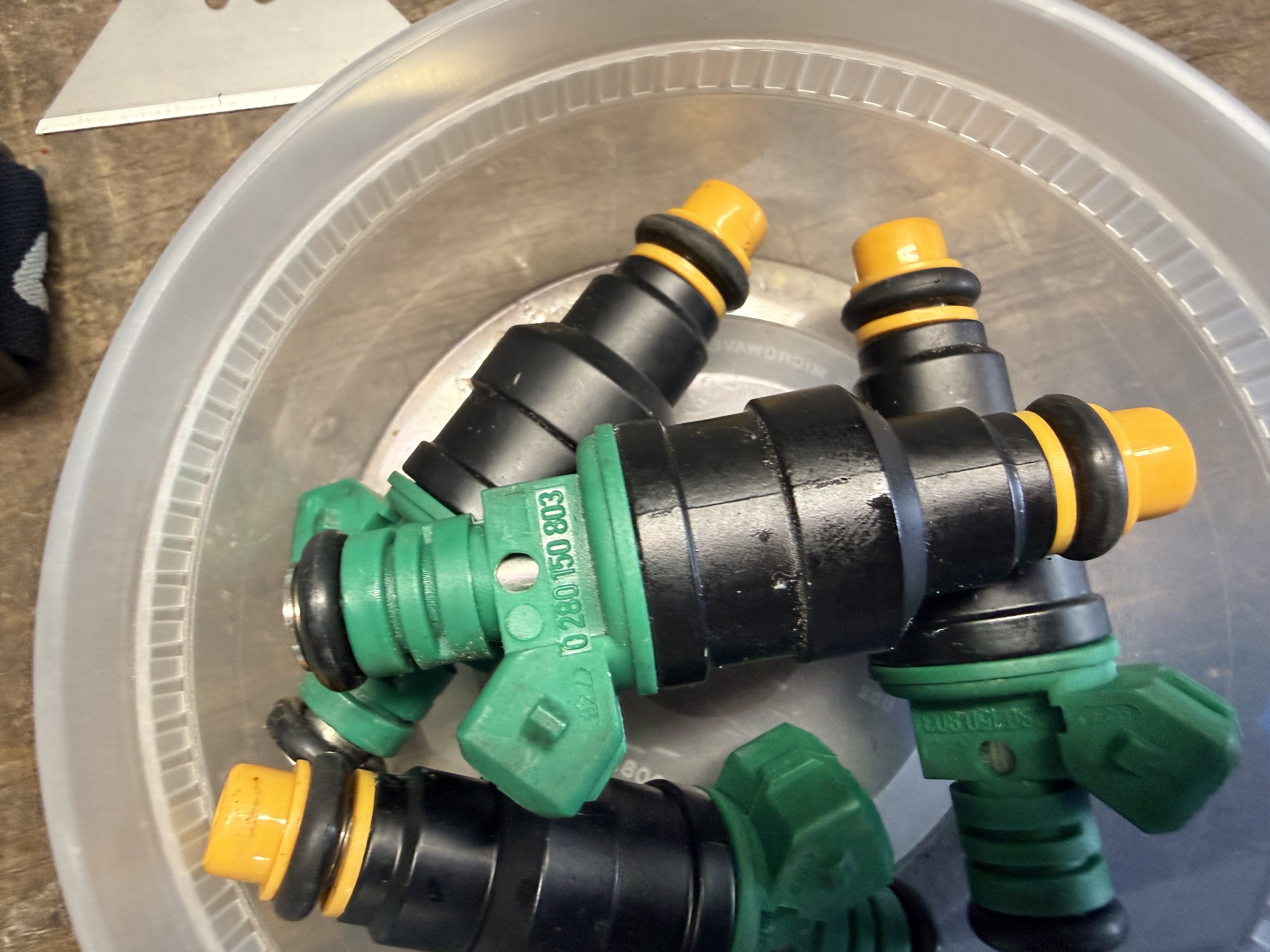

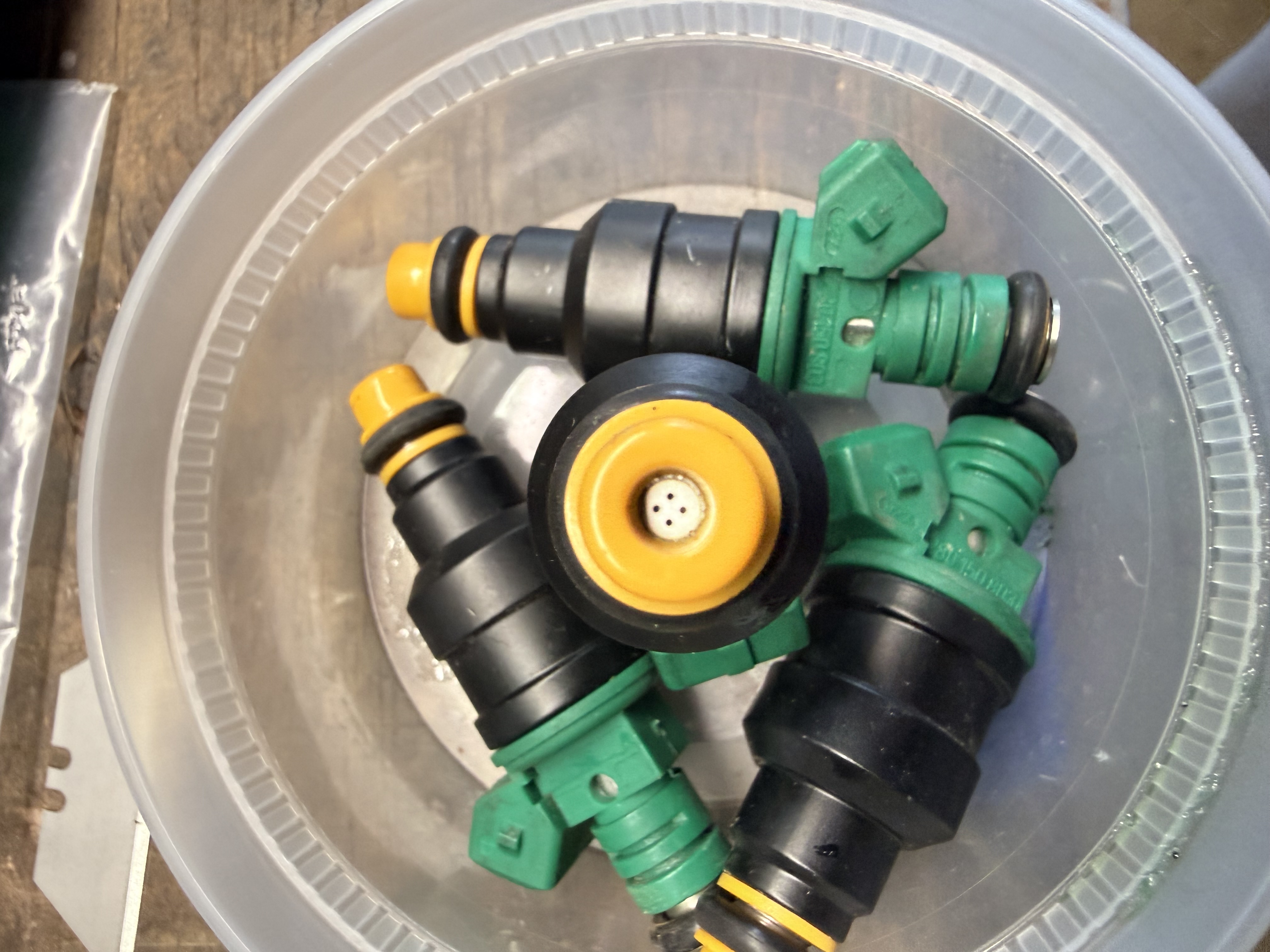

Update: Solved! after sourcing a set of OEM Bosch injectors, the car is now running beautifully. I did want to post a couple of pics of the fake injectors so others might know what to look out for. You will notice that the nozzle looks a little different on these. And as Tom mentioned, they were missing marks and were a brighter green color than the deeper green that the OEM injectors have.

Did you get a chance to weigh one? I may do an official PSA in the 944 Handbook about them. Great picture of the spray holes -- that may be the easiest way to tell at a glance they are fakes...

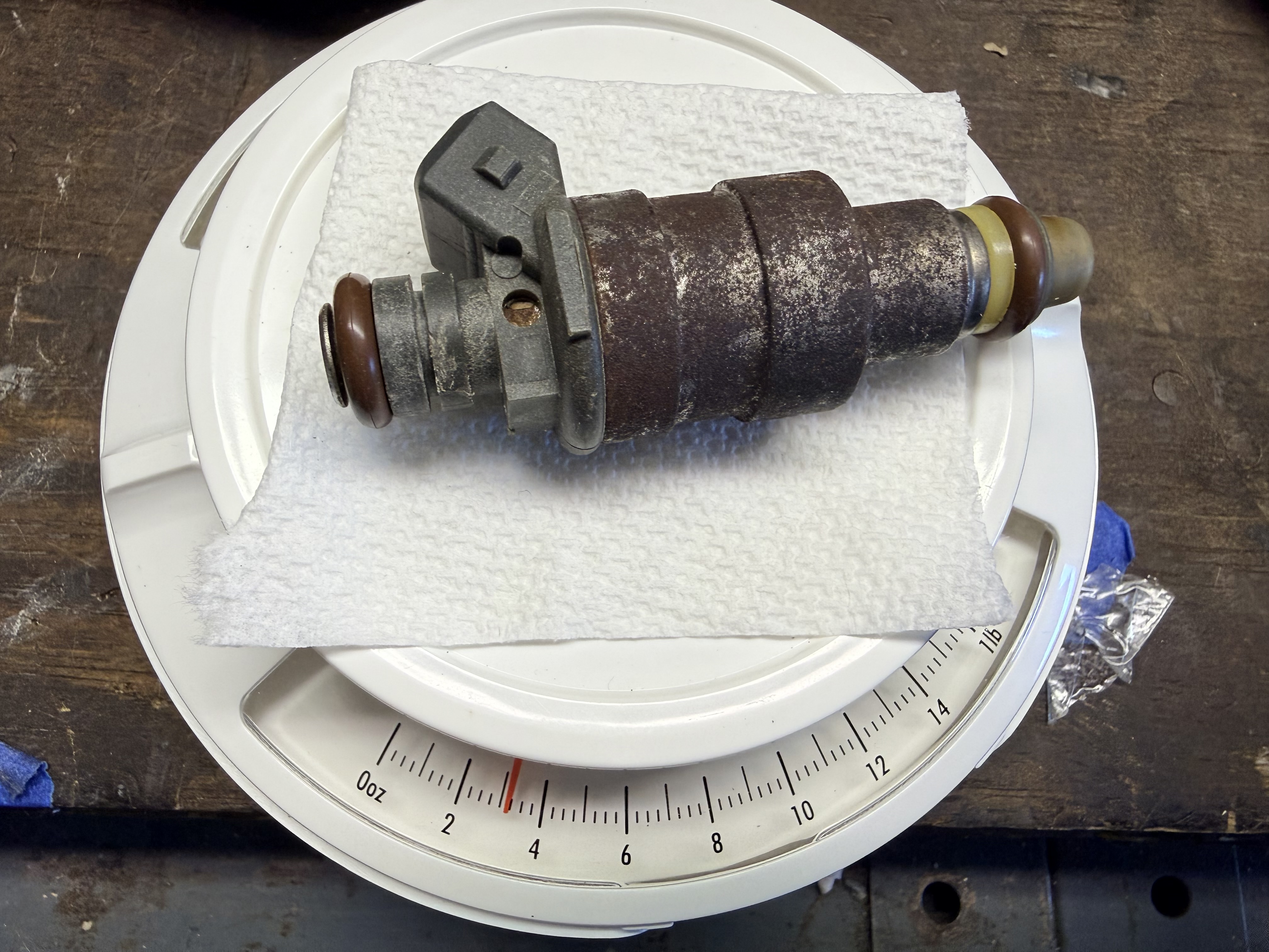

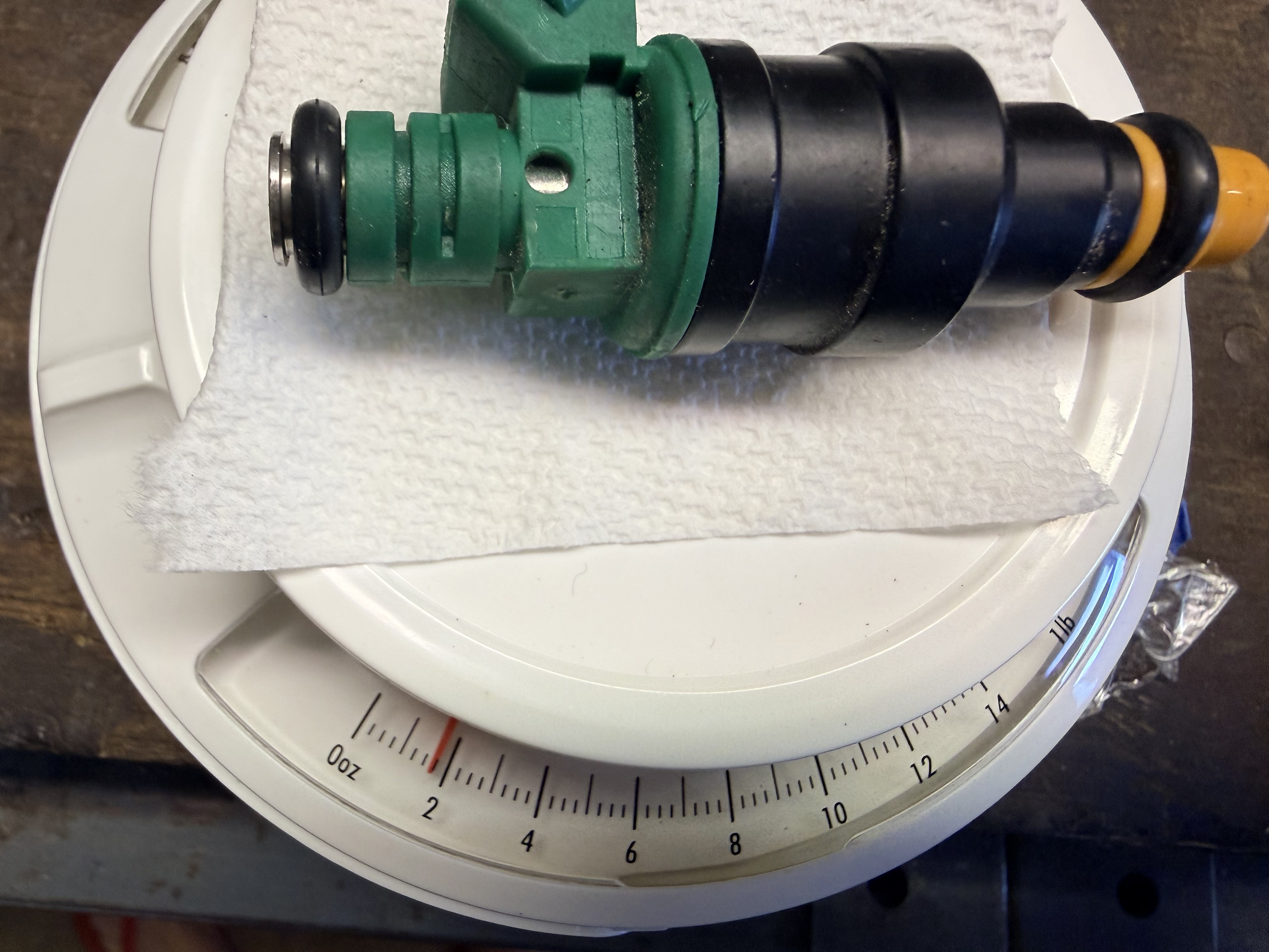

Looks like the fakes are approximately 1.75 oz. I weighed a NA injector (0 280 150 168) that I had around and it is roughly 3.25 oz. Pics attached. Not sure if the turbo injectors are the same. I was too excited to get the new ones installed and didn’t weigh those.
OEM Bosch 944 injector weighs 3.25 oz.

Fake Turbo injector. Weighs considerably less than oem. 1.75 oz.
