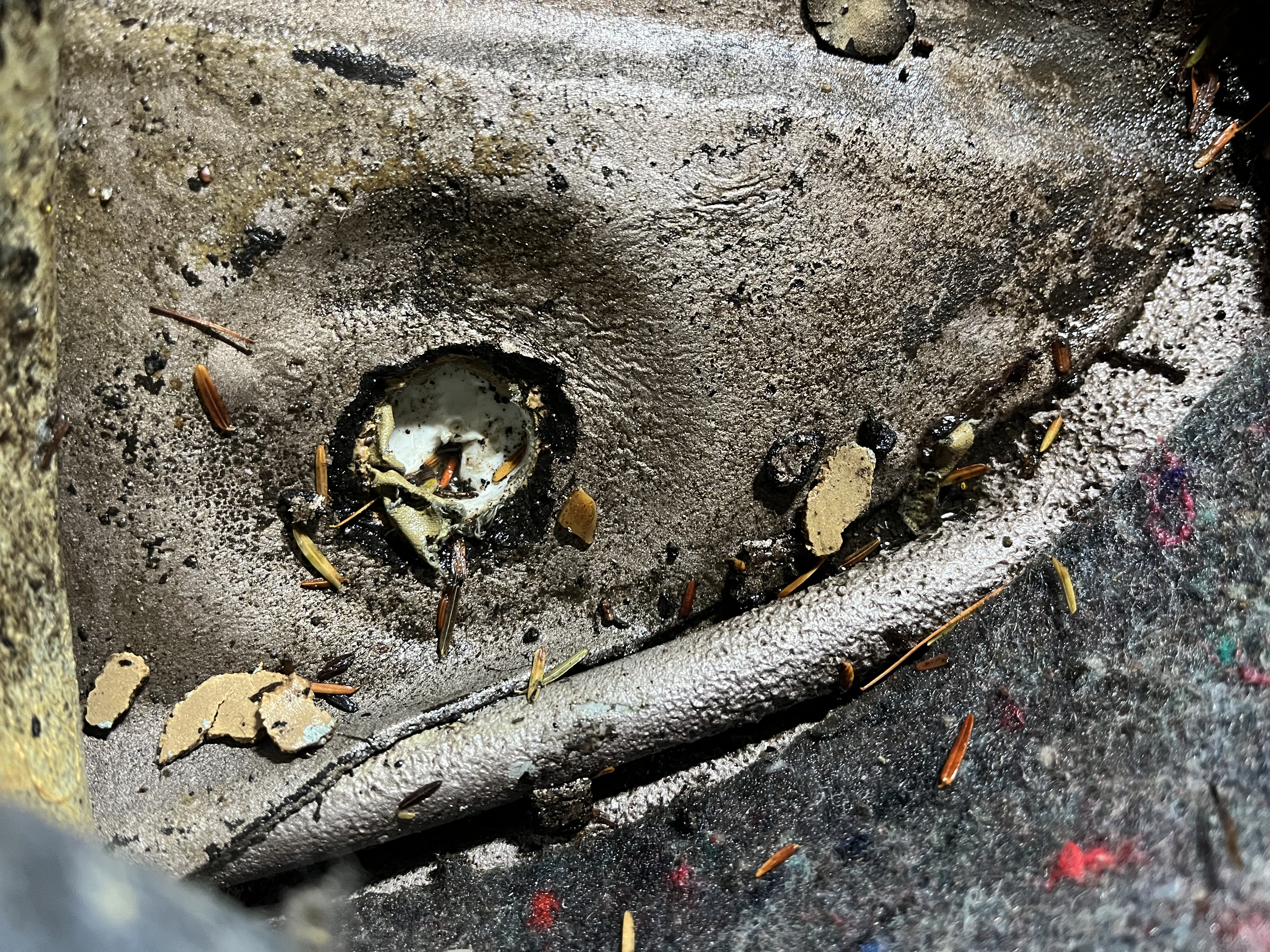

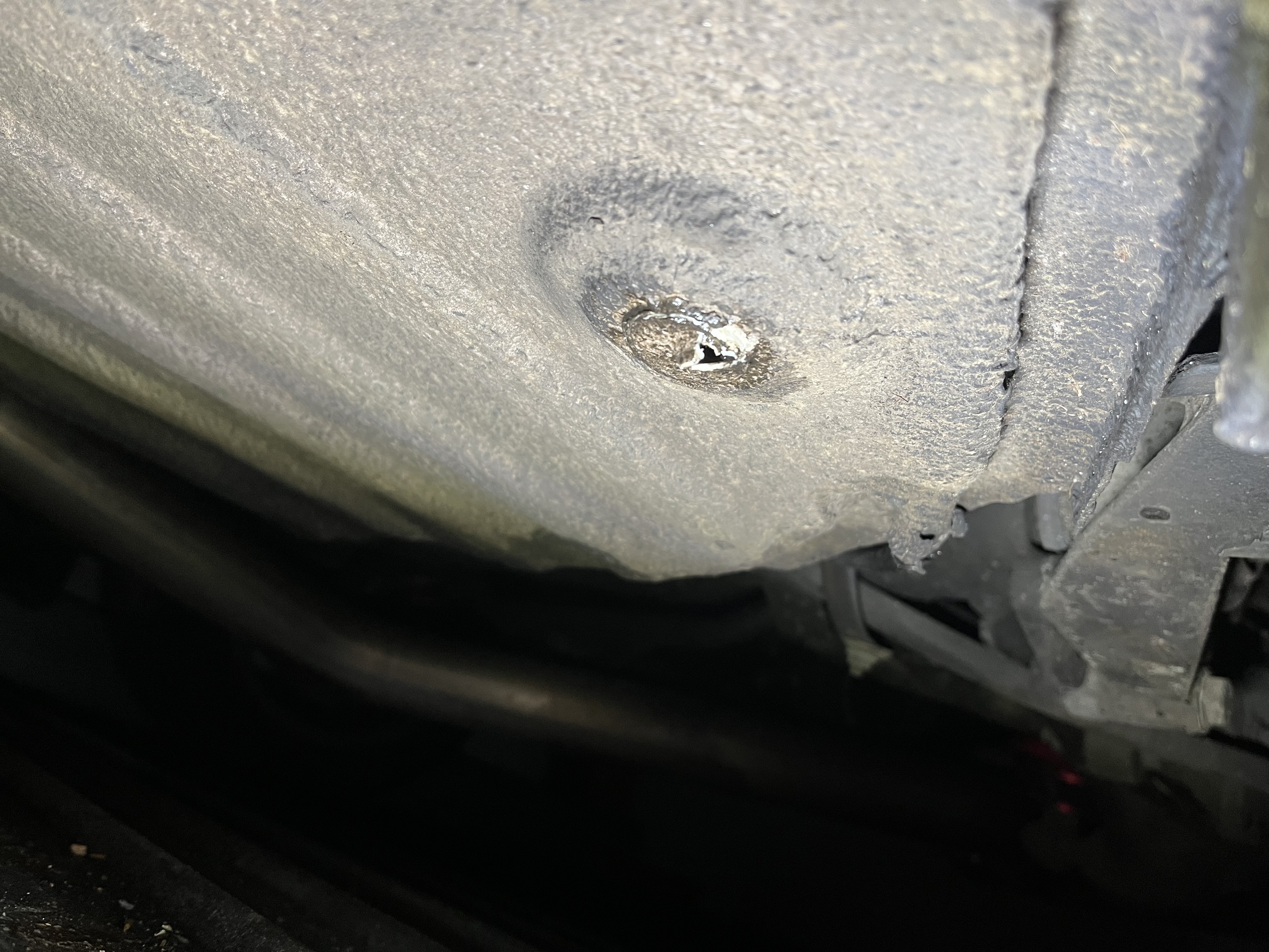

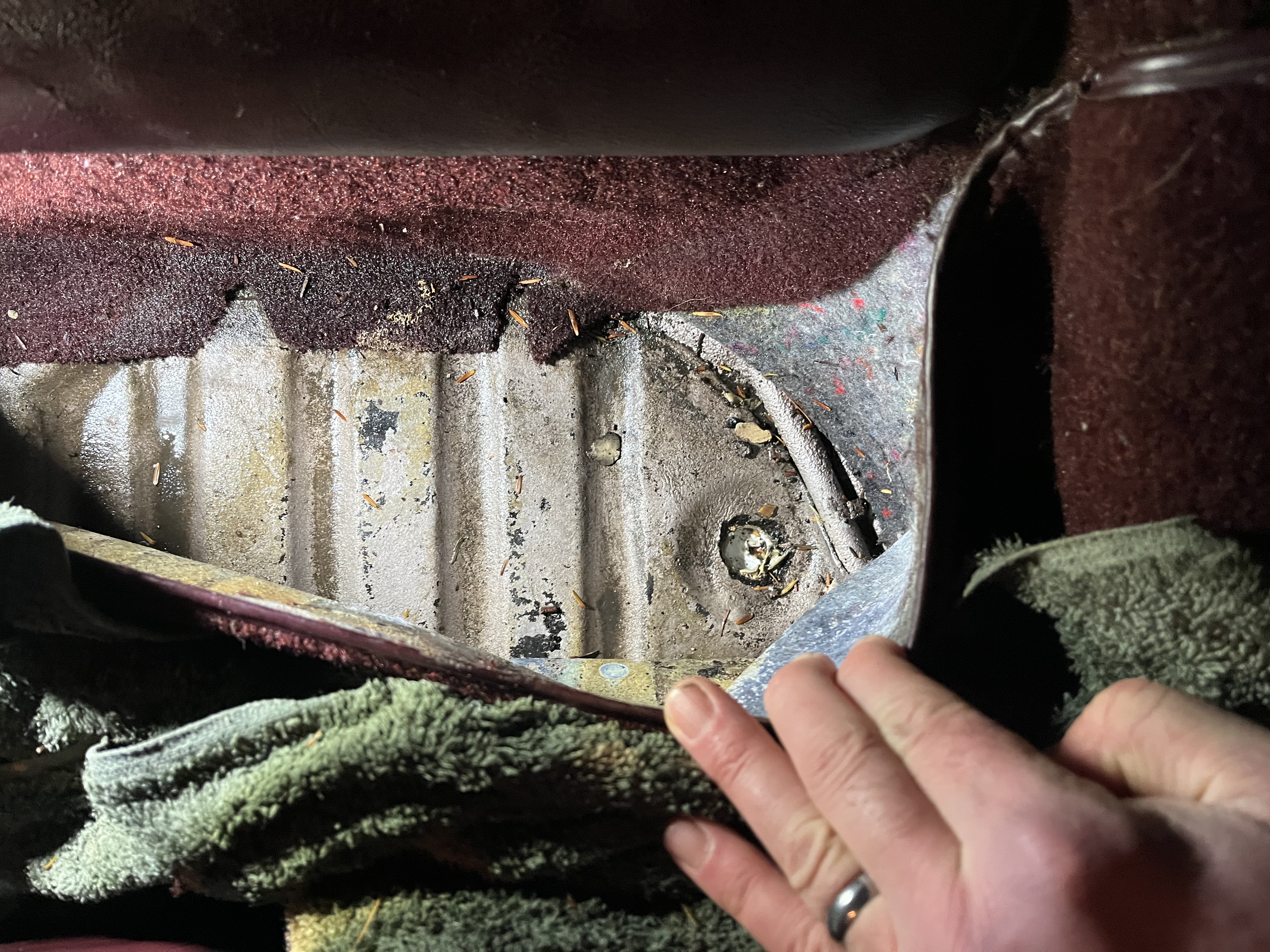

Some photos of the area behind the driver seat that seems to be an emergency drain cap embedded in undercoating, etc. I poked a small hole in the white plastic which can repaired, but wondering if this is a cap which can/should be replaced and then covered back with waterproofing material on both sides.
Photos are from behind driver's seat. Two inside and the last is looking up under the car.

Ah, that's not the panel I was thinking of. Let me see if I can figure out what when in there in no one chimes in on it... Anyone?
