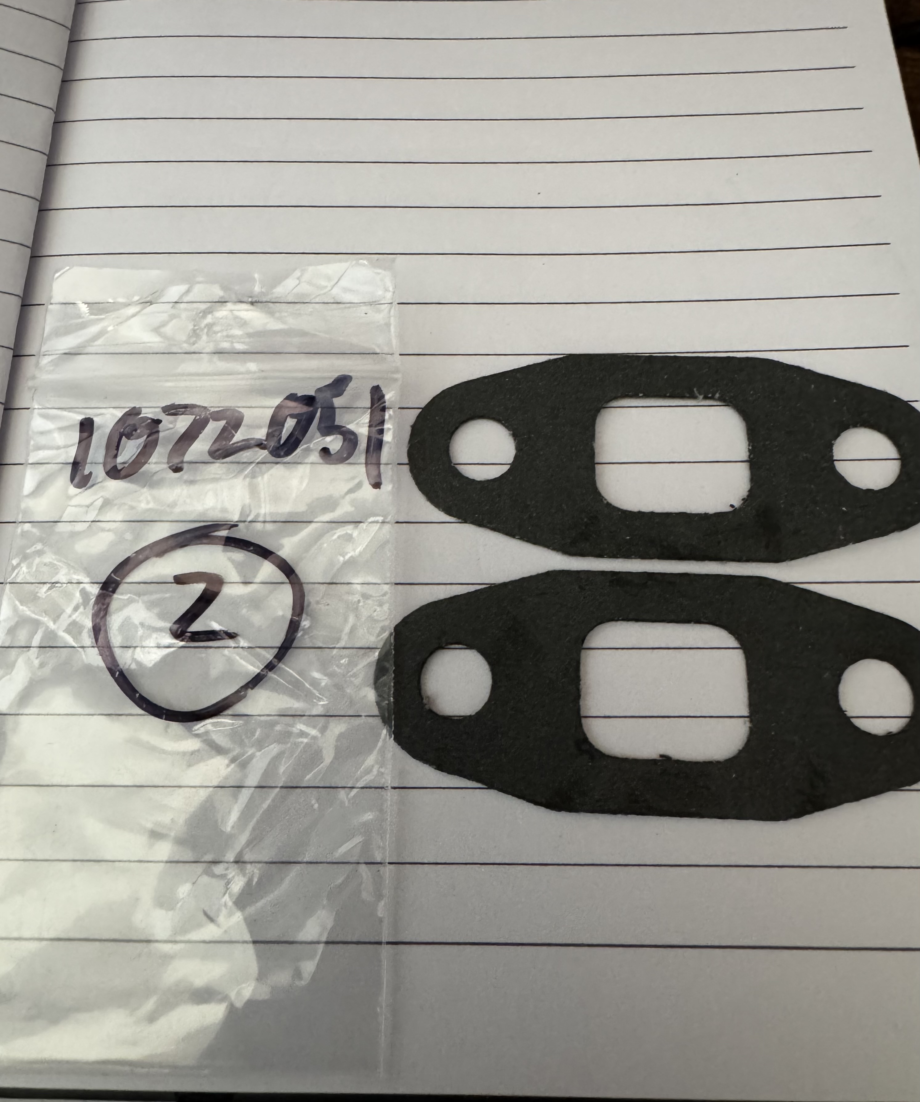

Fast951 wrote: Sat Feb 14, 2026 9:29 am To the OP.
The paper gasket, in your posted picture, is damaged or someone modified it. Examine the shape of the drain hole.
Yes, that looks weird John. As if they're trying to fit a square peg in a round hole??

Thanks Tom and John. I ordered them off LN Engineering. Different color than pics on-line but same dimensions as old one.

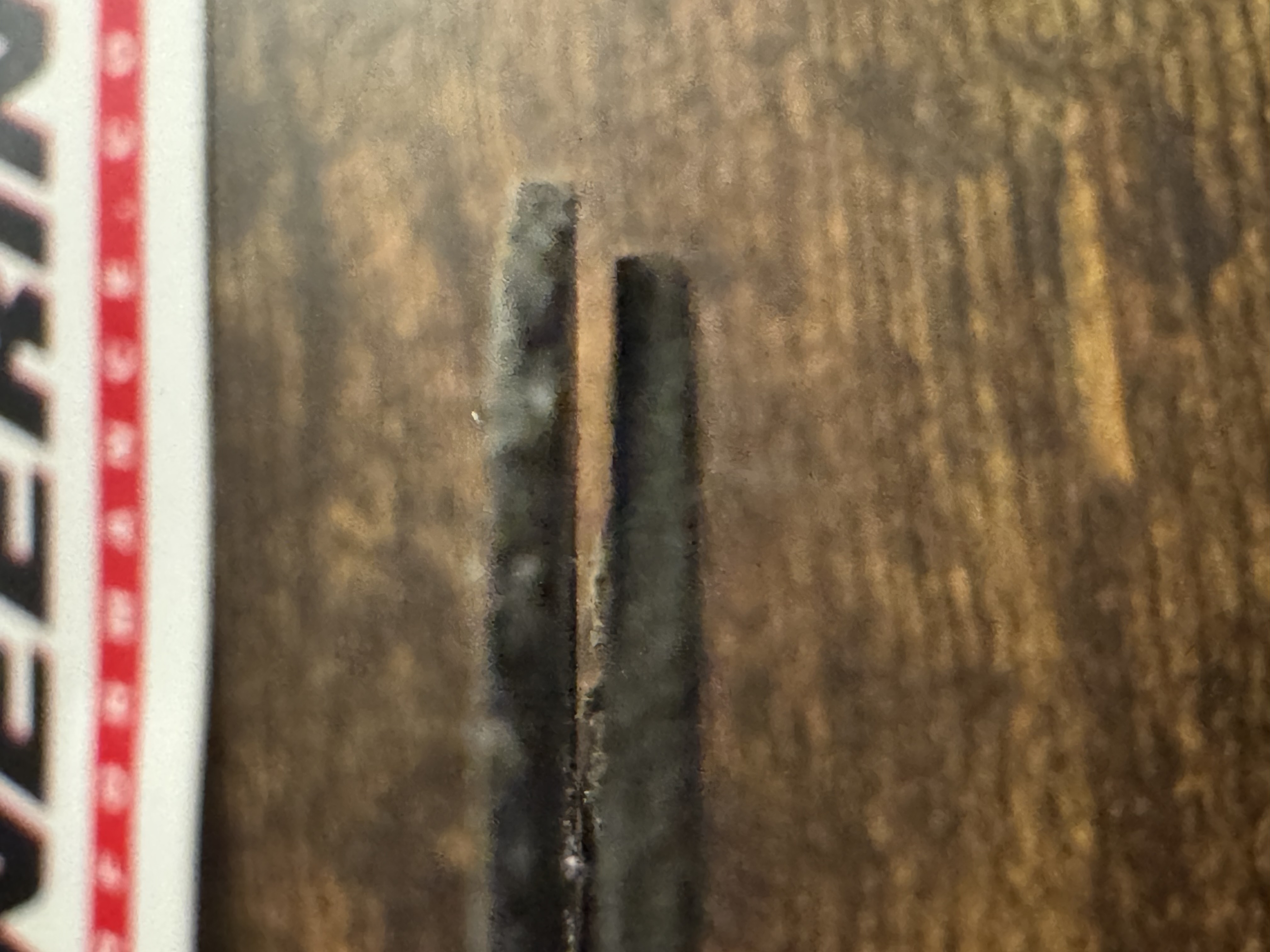

How thick are those? The original white ones seemed thicker. I have an original I'll measure if I can find it...

Roughly 1mm. New one on top… used one on the bottom.

Dlr944 wrote: Wed Feb 18, 2026 7:17 pm Roughly 1mm. New one on top… used one on the bottom.
Annoying that they posted a picture of the thicker one and sent you that. Hopefully it still seals fine... Please report back either way, as I'm sure this will come up for others...
