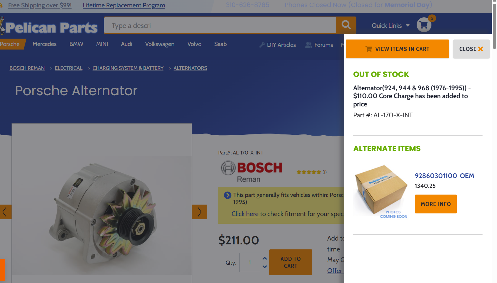

FWIW, I found the Bosch-rebuilt AL-170X (OEM fitment for my 928) on Pelican today for $211 plus $100 core. As much as I love and respect a good home enterprise effort, my wallet suggests the Pelican option at least today as I share this.

Do note when you go to Pelican to buy this alternator - as noted by Dr. Bob - you will find it's 'out of stock.' But, they do offer an alternate (yes, pun intended) for $1,340. So, there's that...
Actually, for anyone that has really chosen to follow or research, these have been out of stock for more than a year.
