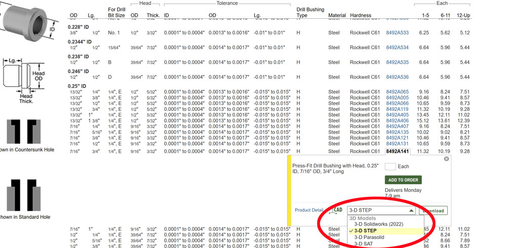

What insert am I looking for at McMaster?

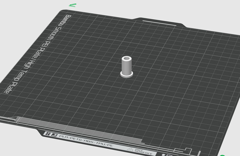

It depends on how you plan to repair the threads. You want the inside diameter to match the size of the drill bit you plan to use. I'm a believer in good old fashion heli-coils for things like this. They are stronger than the original threads, remove minimal material, are available everywhere, and allow for a second chance with a time-sert if something goes wrong. For an M6 heli-coil, you would use a 1/4" or 6.3mm drill bit (tungsten carbide if you can find it). For a 1/4" or 6.3mm drill bit, use McMaster 8492A141 (7/16" OD, 1/4" ID, 3/4" high). I'd get several to help ensure the jig is perfectly centered over the hole -- or otherwise be very careful to line it up perfectly. If you would prefer to time-sert it, or want to try a smaller reverse bit in hopes of backing out the stud, you'd want to pick a drill bushing with an inside diameter to match the bit.
If your friend can print in nylon-cf (or other very hard plastic), you can probably get away with printing the drill bushings using the free downloads that McMaster offers for these parts. Cheaper, with a chance for a weekend repair, though I've never tested it that way. You can download the drill bushing in STEP format from McMaster, which a lot of printers can use without any conversion (such as my Bambu printers). If nothing else, they'd be cheaper than the steel ones for purposes of registering the jig over the hole (with the steel one used for the drilled hole itself). Whether you order the steel ones or print them, you might want to JB weld the drill-hole bushing into the jig. Printers vary in dimensional accuracy, so if your jig is not 'just so' the insert can spin. Not the end of the world, but one less variable to worry about if you JB weld it in place. I'd also use a bit collar, like shown in the video, or electrical tape in a pinch, so you don't drill too deep and into whatever is behind the hole. Good luck, we're rooting for you.
If your friend can print in nylon-cf (or other very hard plastic), you can probably get away with printing the drill bushings using the free downloads that McMaster offers for these parts. Cheaper, with a chance for a weekend repair, though I've never tested it that way. You can download the drill bushing in STEP format from McMaster, which a lot of printers can use without any conversion (such as my Bambu printers). If nothing else, they'd be cheaper than the steel ones for purposes of registering the jig over the hole (with the steel one used for the drilled hole itself). Whether you order the steel ones or print them, you might want to JB weld the drill-hole bushing into the jig. Printers vary in dimensional accuracy, so if your jig is not 'just so' the insert can spin. Not the end of the world, but one less variable to worry about if you JB weld it in place. I'd also use a bit collar, like shown in the video, or electrical tape in a pinch, so you don't drill too deep and into whatever is behind the hole. Good luck, we're rooting for you.![]()
