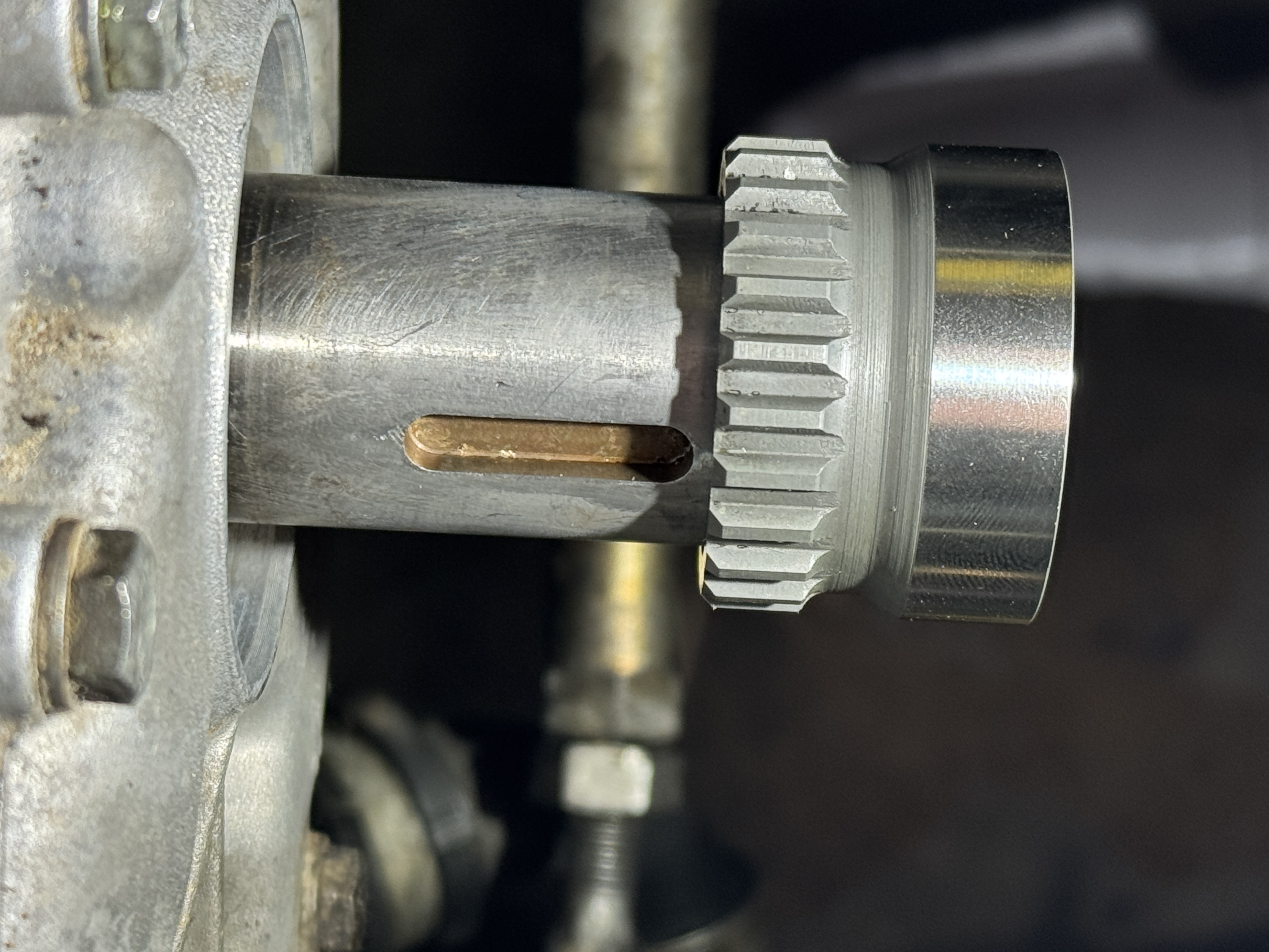

Oil Pump Gear
I tried sanding it this evening to make sure there are nor burrs. I lined it up and tired to slip it on. It gets this far and gets stuck. It becomes very difficult to get back off. I just can't see it supposed to be this tight.
It's not a keyway issue because I can't even get it to the keyway.
To say this is frustrating is an understatement because I've spent more time on this than the rest of the project so far.
I've searched and searched and searched for any documentation on the updated gear and I can't find anything. The few videos I've found on this shows the new style gear slipping on just like the one that came off the car.
At this point I'm out of ideas. I'm waiting to hear back from 944Online where I bought the gear to see if they are any help. So far it's radio silence but I was also directed to email someone else since Ian's email has an auto responder to contact someone else.

- IMG_2956.JPG (1.72 MiB) Viewed 569 times

Paging Steve at @944online... I once had a main bearing in a Porsche box that was defective, so it can happen. Seems unlikely they'd machine it in the wrong size though... I'll rummage through my old parts tomorrow and see if I have one I can measure for you...Richey wrote: Tue Jan 13, 2026 8:02 pm I tried sanding it this evening to make sure there are nor burrs. I lined it up and tired to slip it on. It gets this far and gets stuck. It becomes very difficult to get back off. I just can't see it supposed to be this tight.

I did those too. They slipped on with issue.O875 wrote: Mon Jan 12, 2026 10:09 pm I replaced the one on my car a few days ago. I thought I had cleaned up the crankshaft but the new drive would jam after maybe 5mm and was a struggle to get off. The crank needed more work with the emery paper than I expected before the new drive would seat in the oil pump, despite careful cleaning and oiling. The new one was a Porsche article.

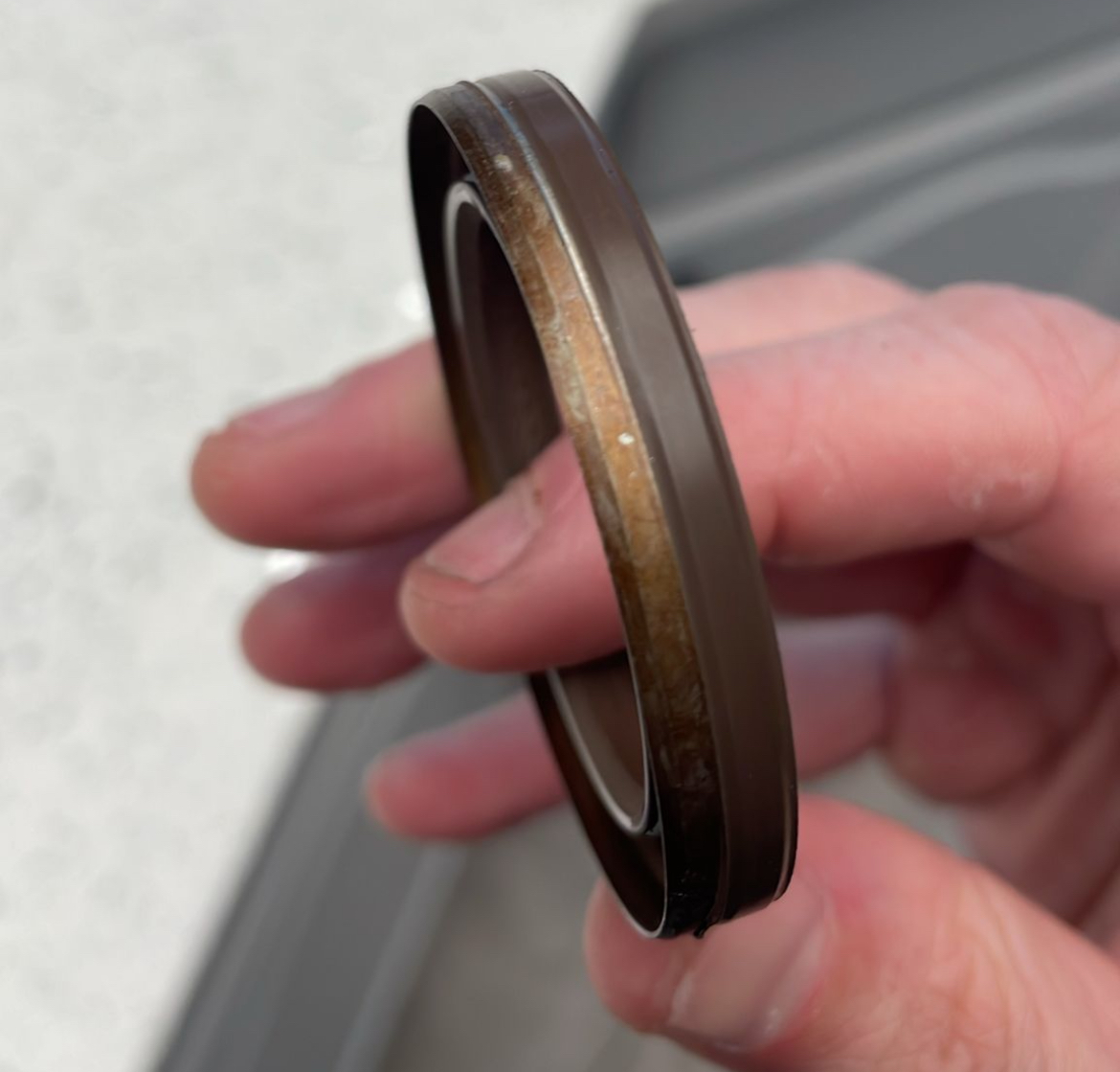

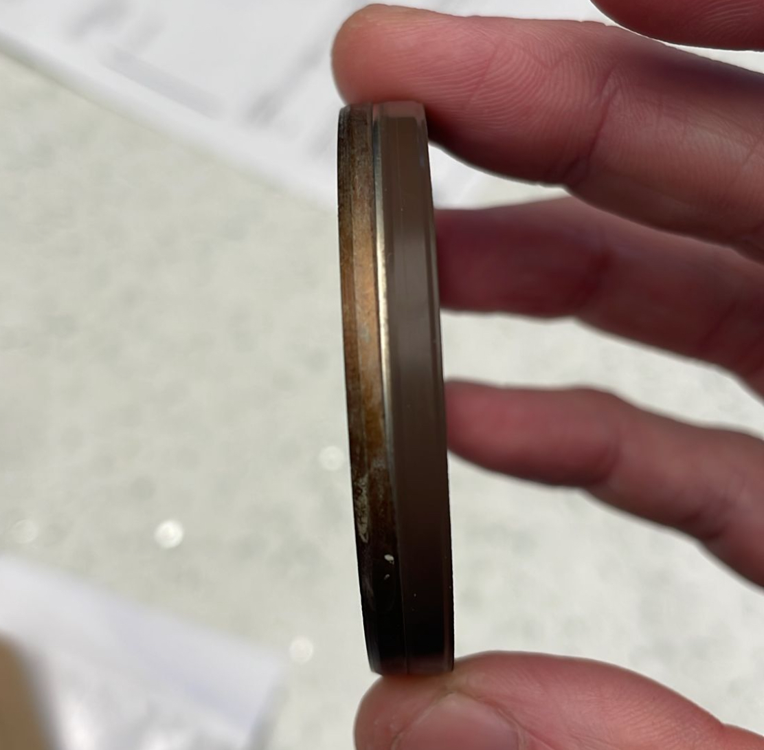

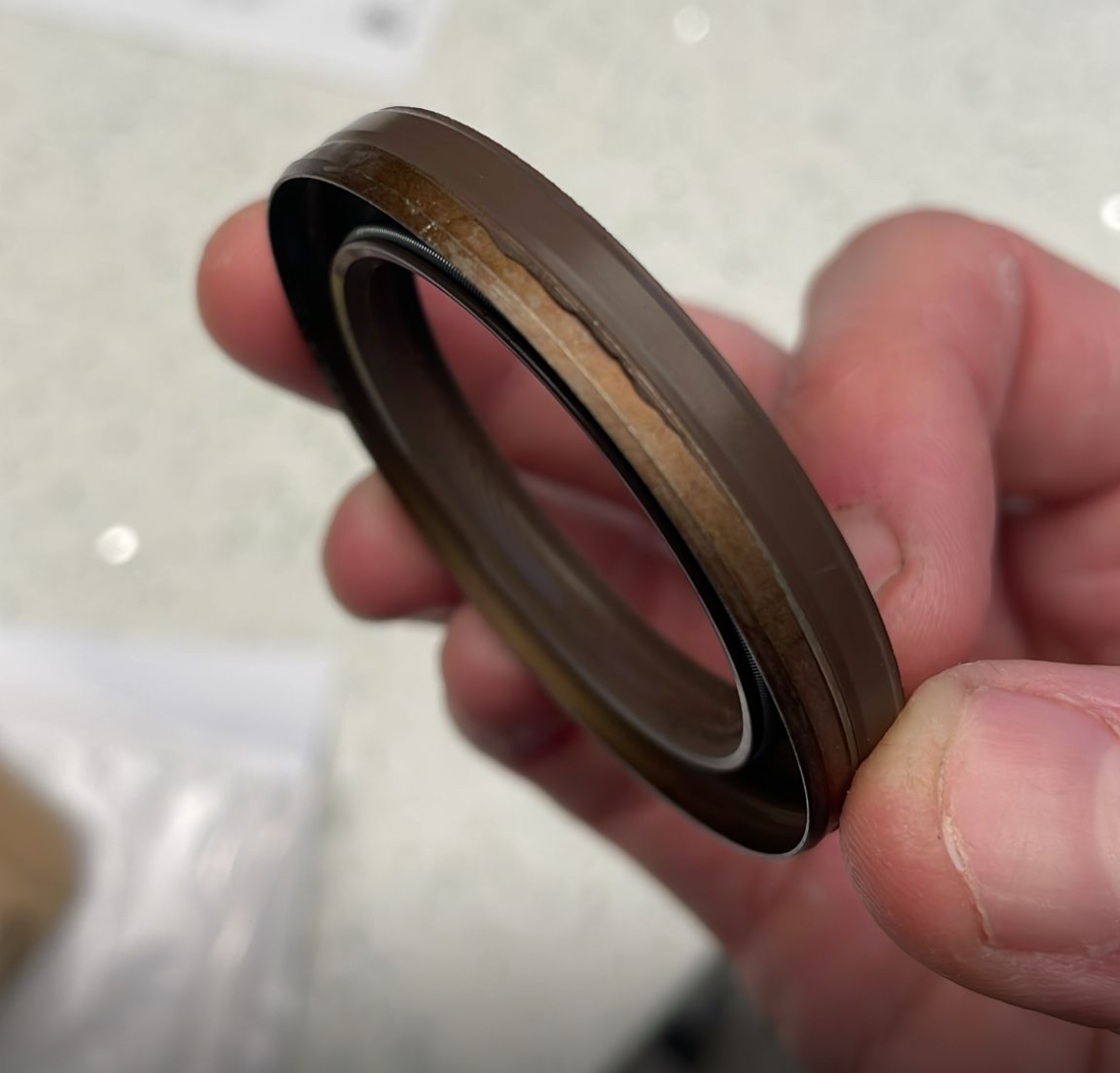

This was my poor quality VR front main from the dealer. The outer seal was really inconsistent in its coating. If oil got to the edge, I wouldn’t trust it not to leak through.
- IMG_5294.jpeg (476.44 KiB) Viewed 510 times
- IMG_5293.jpeg (535.89 KiB) Viewed 510 times
- IMG_5292.jpeg (595.02 KiB) Viewed 510 times
