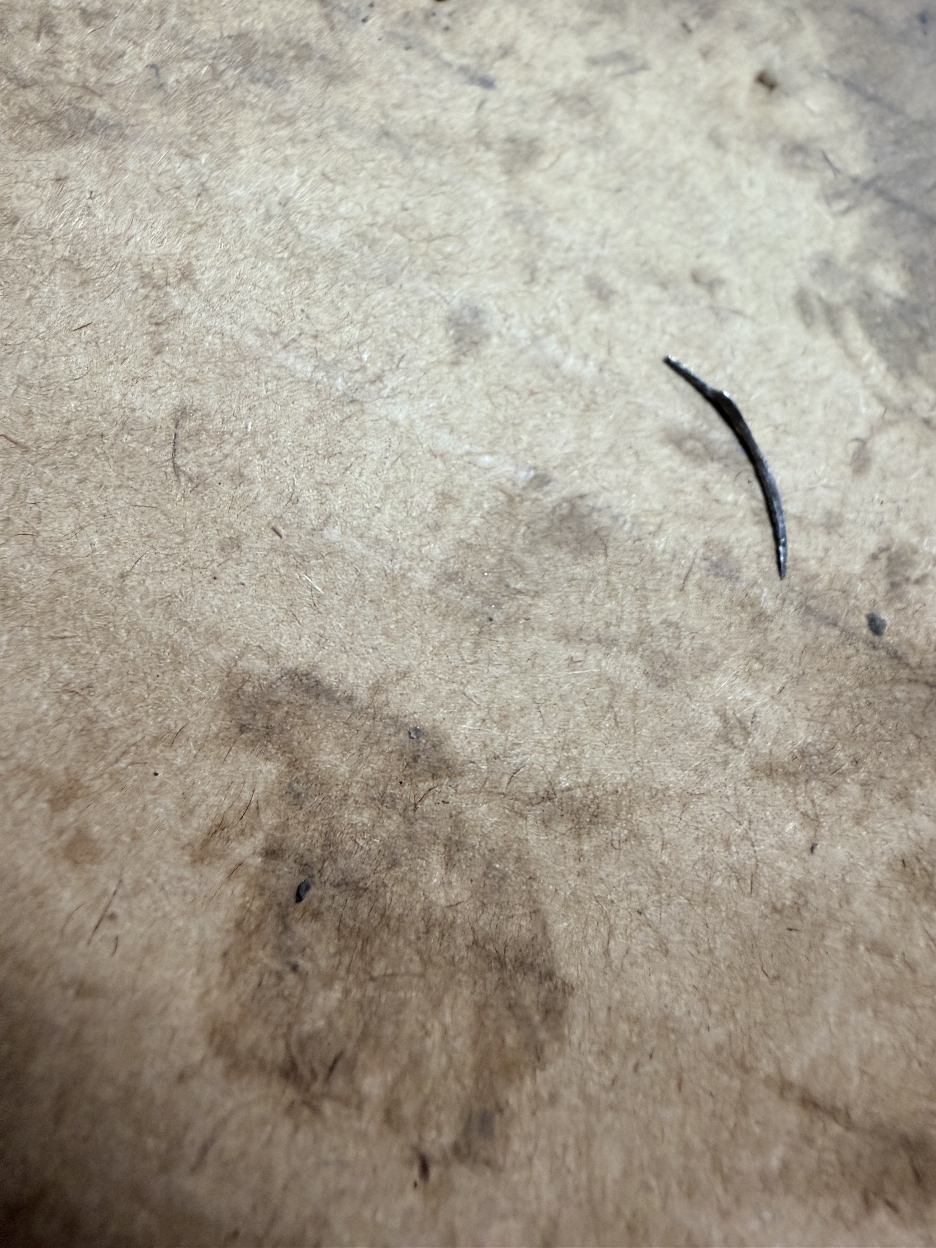

Just decided that I had time t0day, I disassembled the rack and ordered the Rennbay reseal kit.
Blew air through all the hoses (no issues).
Rack assembly came apart - only odd thing that I noticed is that it wouldn’t pull through all the way. Rather than force it, I pushed the main pinion housing back the other direction and a sliver of thread dropped out (see pic). That was odd. I'll take a close look at the tube threading to see if it might have come from that.
Will also replace the reservoir to pump hose.

Tom. What you mean "chunks" ?
- Posts: 8967
- Has thanked: 942 times
- Been thanked: 4028 times
Just meant to be on the look out for signs of any gears or internal rack parts that may have broken/shattered, etc. -- i.e., signs of internal mechanical damage resulting in chunks of whatever in the fluid...
