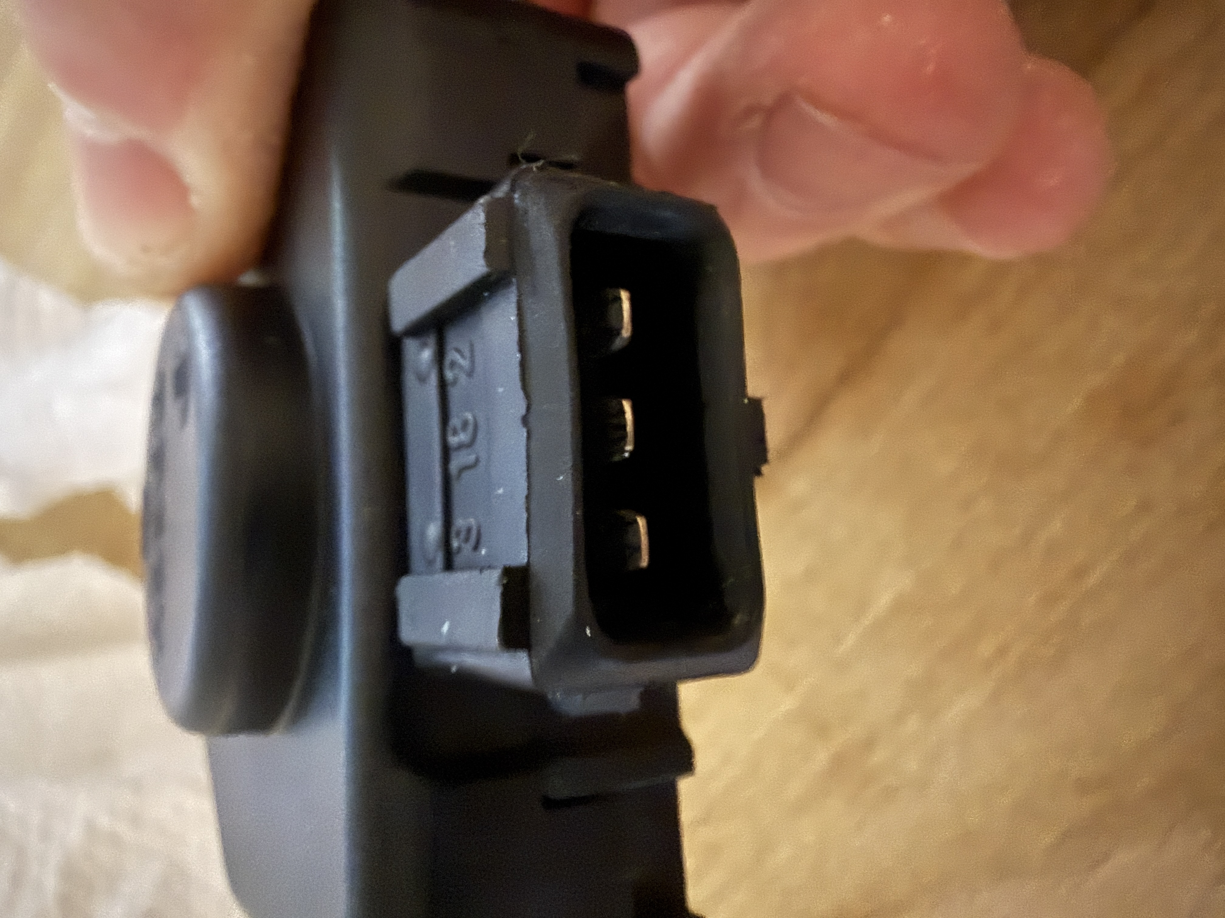

I think you are correct. I retested the TPS at the throttle body following Clarks. I made some videos:walfreyydo wrote: Thu Nov 06, 2025 5:38 am Here is the testing procedure for the TPS, if not seen already:
https://clarks-garage.com/shop-manual/fuel-06.htm
The NA 8V (and 16V) actually has three fuel maps in the DME: idle, part throttle and WOT. So when testing the TPS we test for idle connection and WOT, knowing that when the DME doesnt read either of those states, its using the part throttle maps. So its important that the TPS is working correctly to identify idle and WOT or the DME will be defaulting to the part throttle map.
Pin 2, Idle "With the throttle closed, the ohmmeter should read zero (0) ohms. With the throttle open, the ohmmeter should read infinite (∞)."
https://vimeo.com/manage/videos/1134255056
Pin 3, Open "With the throttle closed, the ohmmeter should read infinite (∞). With the throttle wide open the ohmmeter should read zero (0) ohms."
https://vimeo.com/manage/videos/1134255113
So from what I see, Pin 2 is stuck saying "open throttle", even when closed, and even with an audible click.
And, Pin 3 is working as intended. So... the car starts and warms up and idles fine. First blip of throttle puts into a stuck "open throttle at idle" situation?

Or I don't know because I just performed the same test on another throttle body and TPS and got the same outcome.
Edit/update: I have a throttle body and several salvaged position switches. Swapping them out and testing them, all the same. Pin 3 seems to test as the procedure says, Pin 2, infinite only. I can hear all the switches double click... I must have something wrong.
Update/update: Am I crazy, watching my videos again the resistance measurements seem flipped, no? Testing terminal 3, I see 0ohms closed and infinity when open..,
I have my pins backwards like a goon

I think I solved it...
So measuring resistance correctly... My WOT was correct, but my idle was not going to infinity consistently.
I stepped back and loosened everything... I mean the cable and the stop set screw. Assuming it was untouched, that turned out to be it. I was able to back it off and readjust it. TPS now switches idle correctly and car is idling as it should be.
Thank you all.
