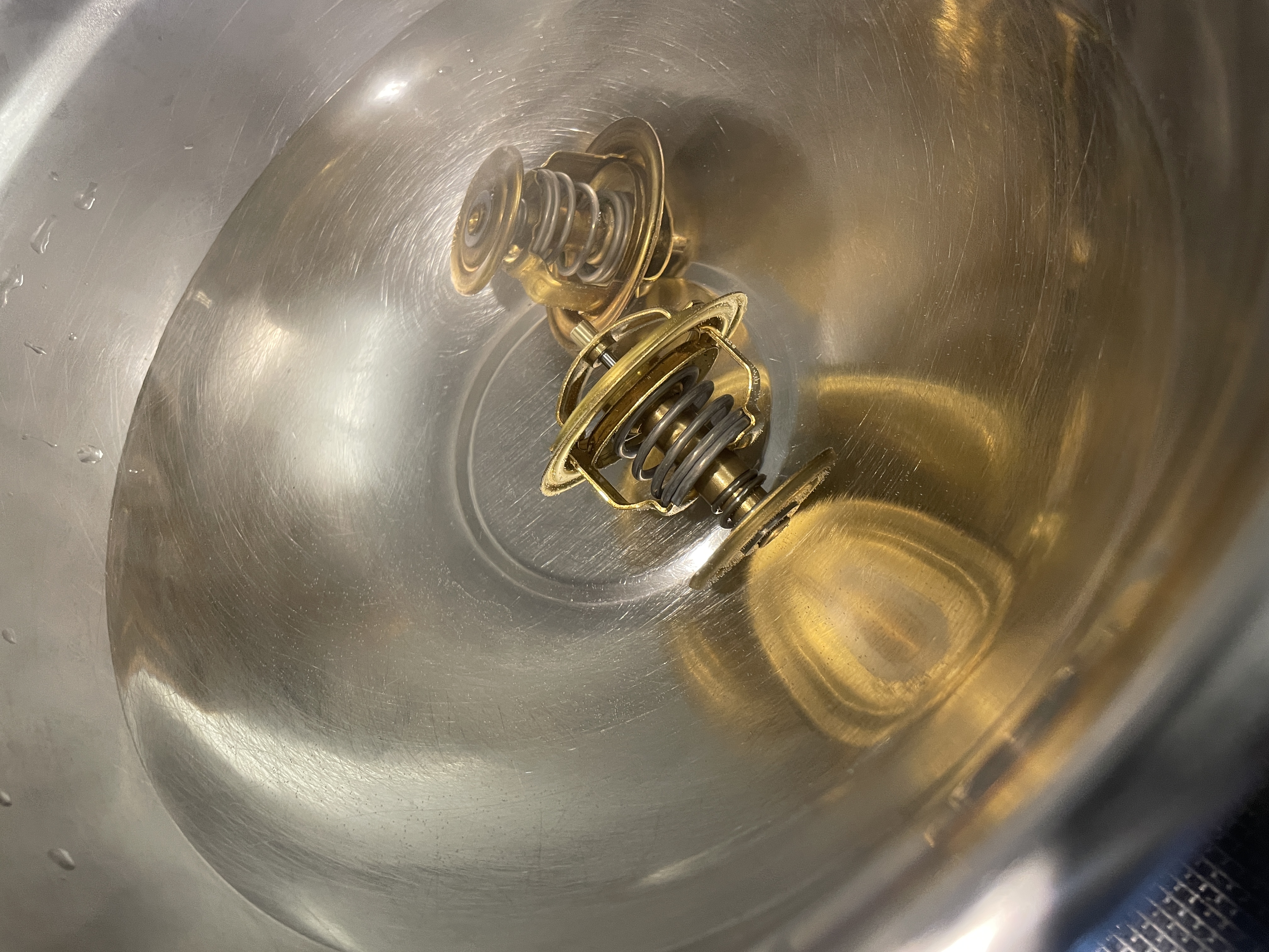

I tested two thermostats today.
Both of them are 944 106 019 00 (83 degree unit for updated water pump design).
One of them was a Wahler stamped "made in Germany". It was produced in 2020. The other, was a Wahler stamped "Made in Brazil" produced 2022.
The results are staggering.
1) The made in Germany Wahler (sourced from my dealership), opened just below 83 degrees. It opened proudly with lots of room for flow. As it cooled off, it stayed open for a longer temperature range.
2) The made in Brazil Wahler - was just barely open above 90 degrees. It closed up very shortly after it began cooling as well. Way too high a temperature and definitely didn't open enough for adequate flow.
Check your thermostats before installation.
The German made unit is on the left and can be seen open. The Made in Brazil unit on the right. Both in the same water, same temperature, same duration of time.

t36 wrote: Sat Nov 01, 2025 4:00 pm I tested two thermostats today.
Thanks for posting this! It supports my fears about the 'new' Wahler units unfortunately. You can stamp Rolex on a Casio, but it's still a Casio. :( I'm hoping Porsche holds their suppliers to a standard, and that they wouldn't put a part like that in a PCNA box, though I suppose time will tell. Unless/until a new standard bearer emerges, I'll be testing like this before putting any t-stat in my car. Thanks again for the post!

Was the one from the dealership in a Porsche box? That might suggest their quality standards are protecting them from the lesser parts....?

Just a Porsche bag. The classic sealed one. Clear on one side and white printed back with barcode.
