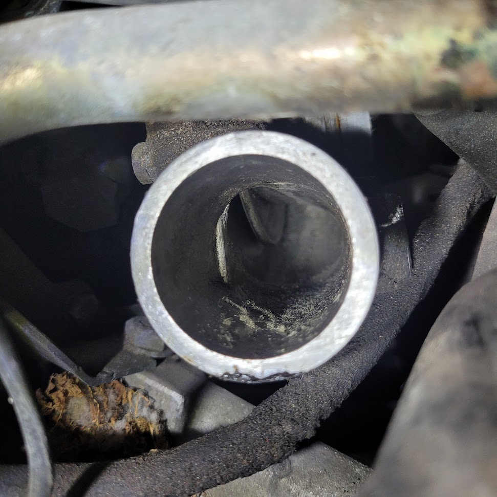

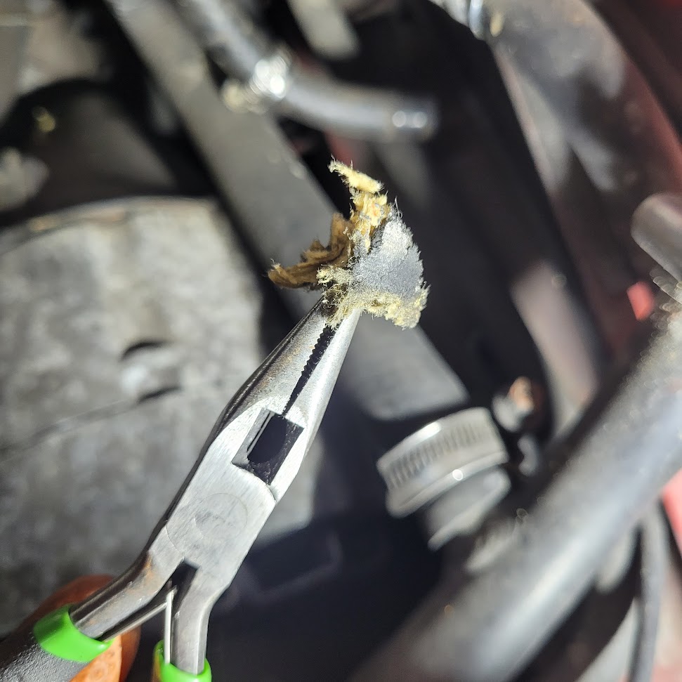

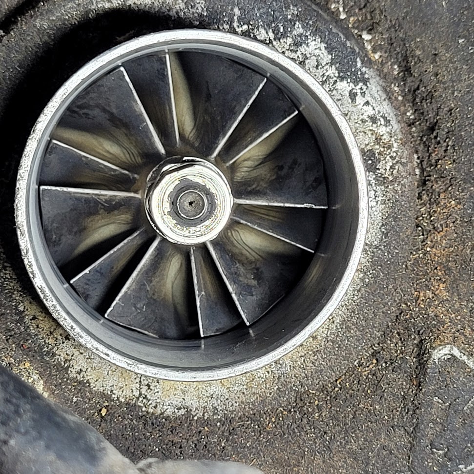

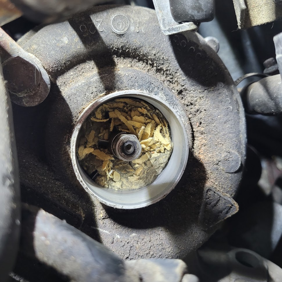

I pulled the j-boot and started picking the paper out carefully with a pliers. I noticed the turbo could still spin easily so I don't think paper got wedged between the ends of the blades and the tube (I can easily imagine that causing damage).
It was packed in there densely and getting pretty hot by the looks of it.

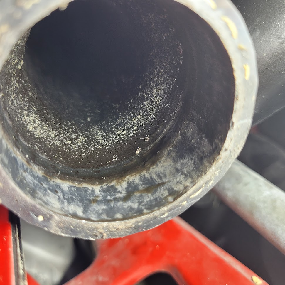

That second last pic is the rubber turbo->intercooler pipe. It looks like the paper was turned into lint. I had forgotten about the intercooler until I started tearing it apart. Then I realized anything that gets into the engine would have to be small enough to pass through the intercooler, so it might have sacrificed itself to save the cylinders. I'm not sure how to tell.
All in all the impeller blades look fine. I vacuumed it at the end to get the last few bits out and it spins freely. I think I am going to just button it all up with a new filter and drive, and see what's up. Any real damage must have been done already.

Pump a leaf blower or compressed air into the intercooler from the throttle body side to see if you can blow anything out... If anything is in there, my guess is it's packed up in the inlet side tank. But the amount of material missing from the filter plus what you got out of the turbo makes me think there isn't a ton of filter material floating around still... I'd check the throttle body side i/c pipe, blow if out from that direction, and unless you see signs of it getting up toward the TB, I'd fire it up myself...

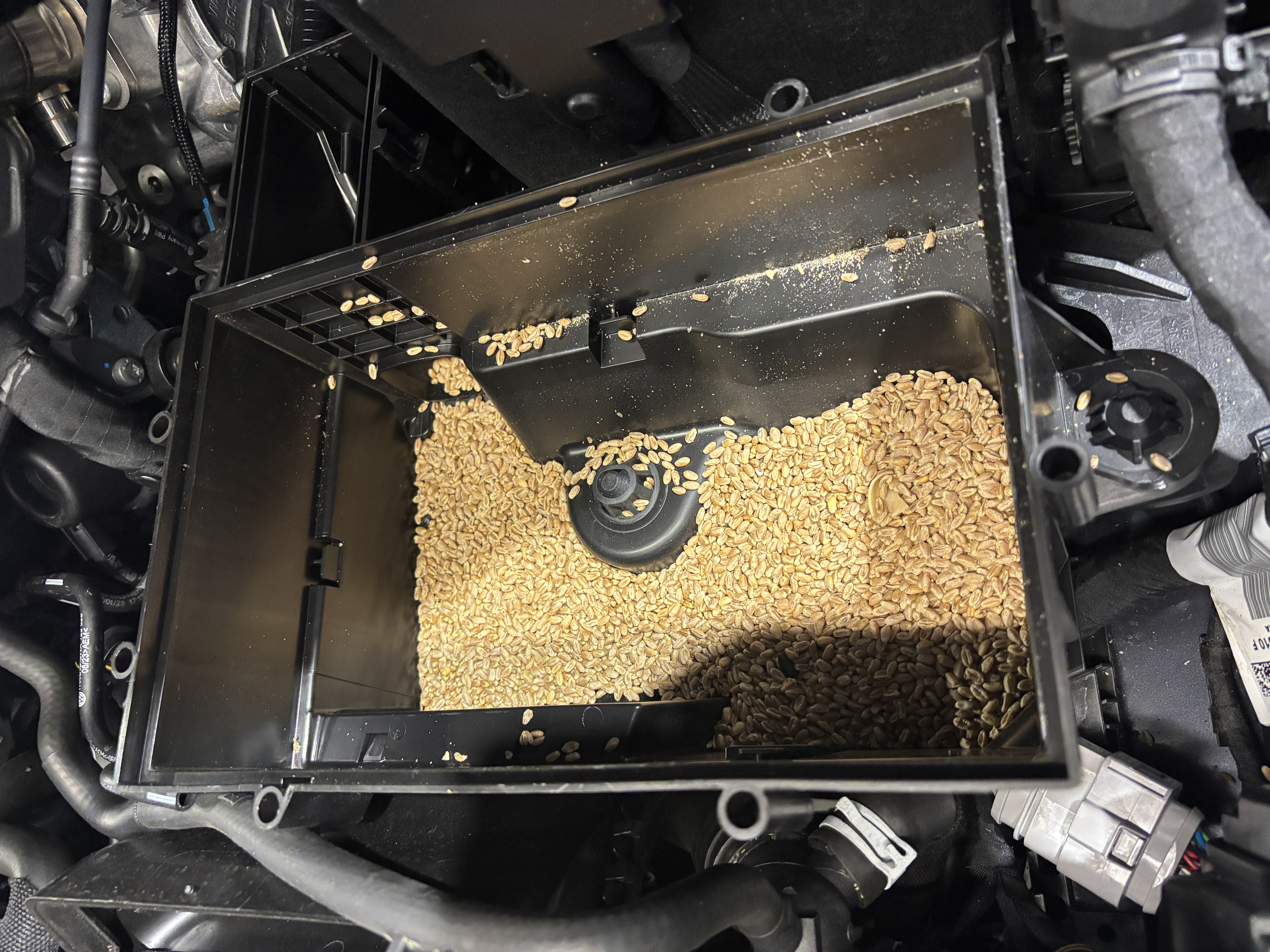

This episode with mice is similar to what happened to my 2023 VW Golf R. During the installation of my APR intercooler at 4,317 miles, the shop found the airbox full of some type of grain. Since my car came through the port of Houston, I can only guess there was grain storage nearby and some critter used my car for storage. No harm, no foul as it never made it past the air filter and it ran fine. Weird.
