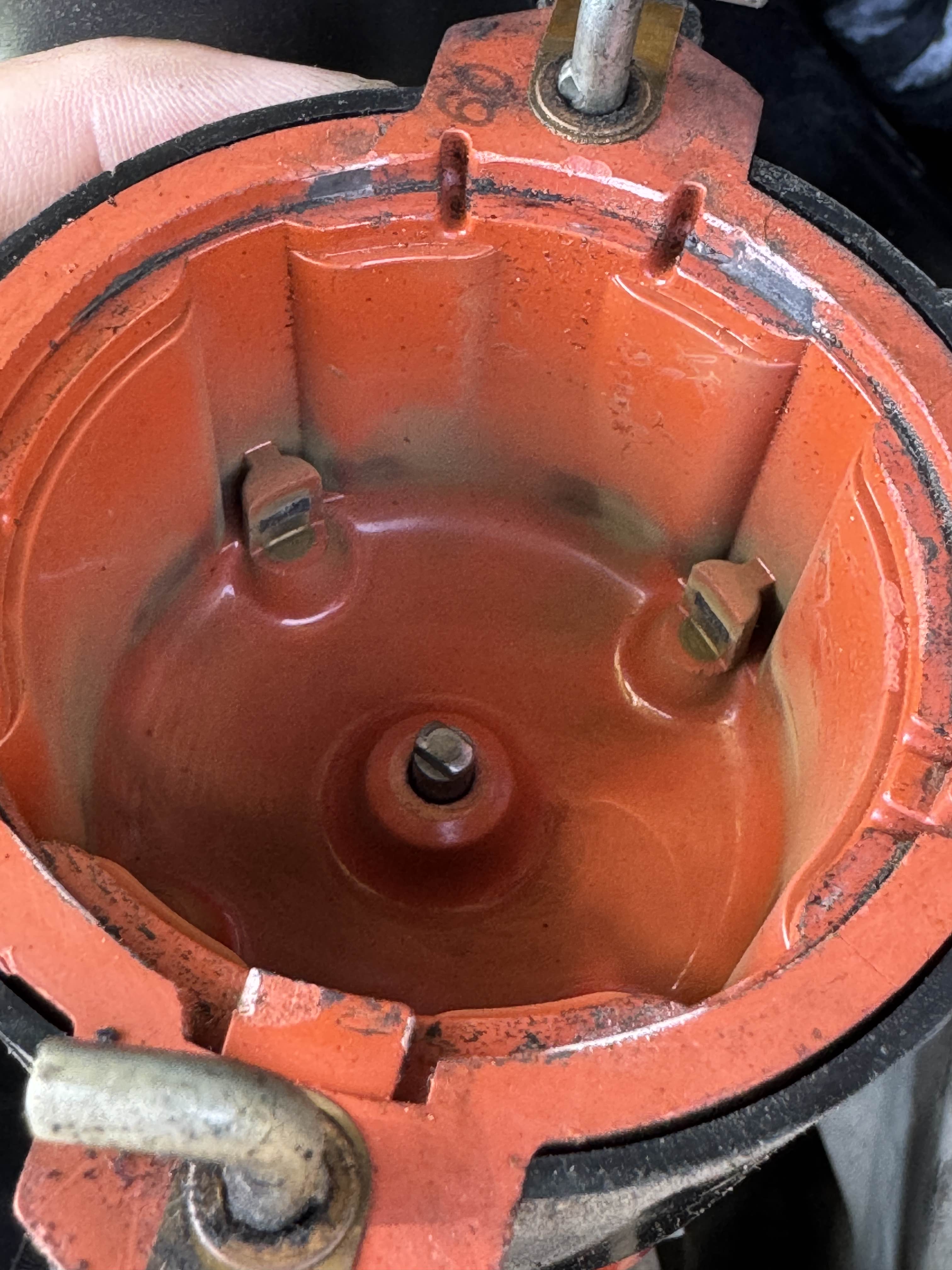

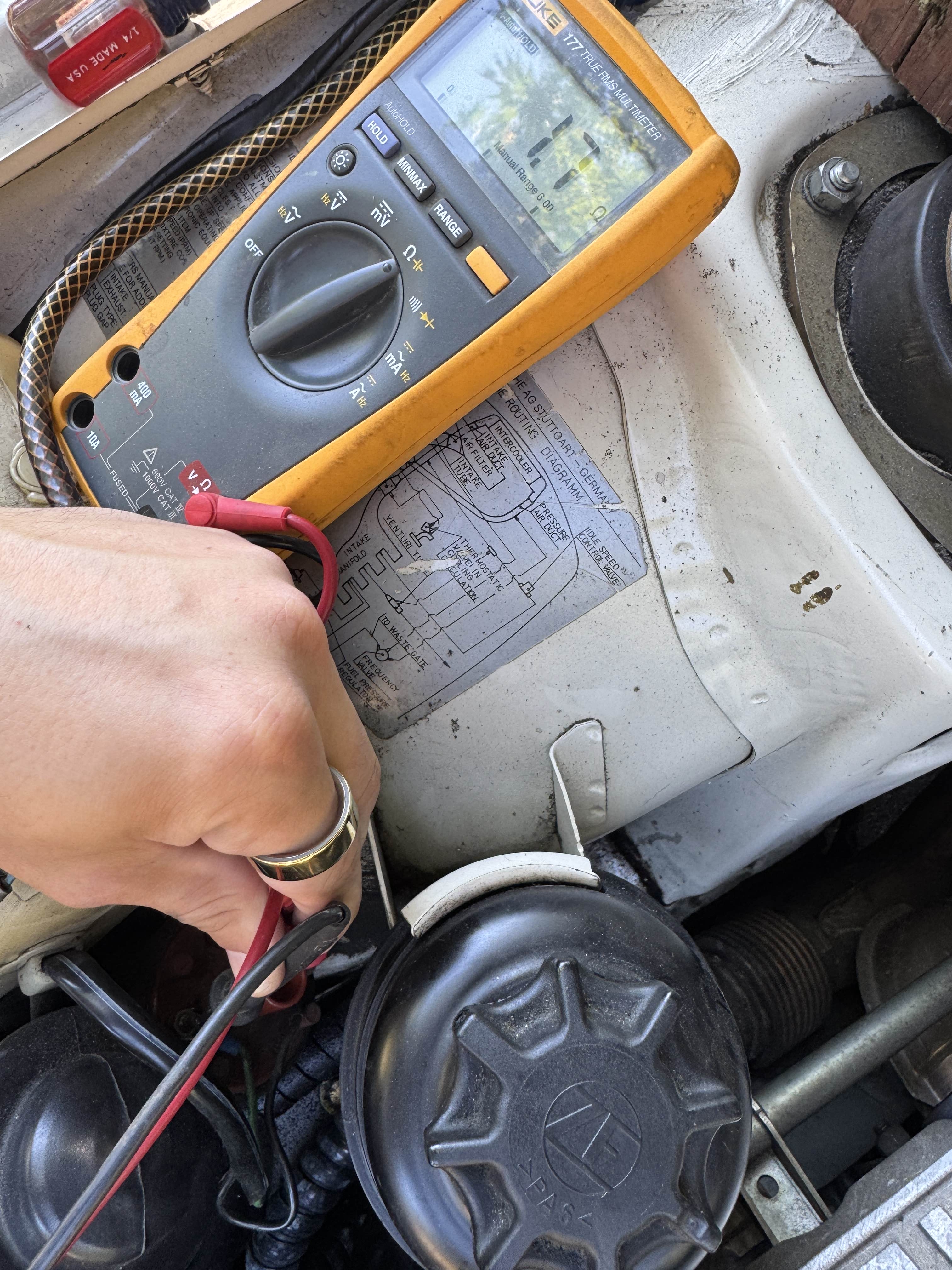

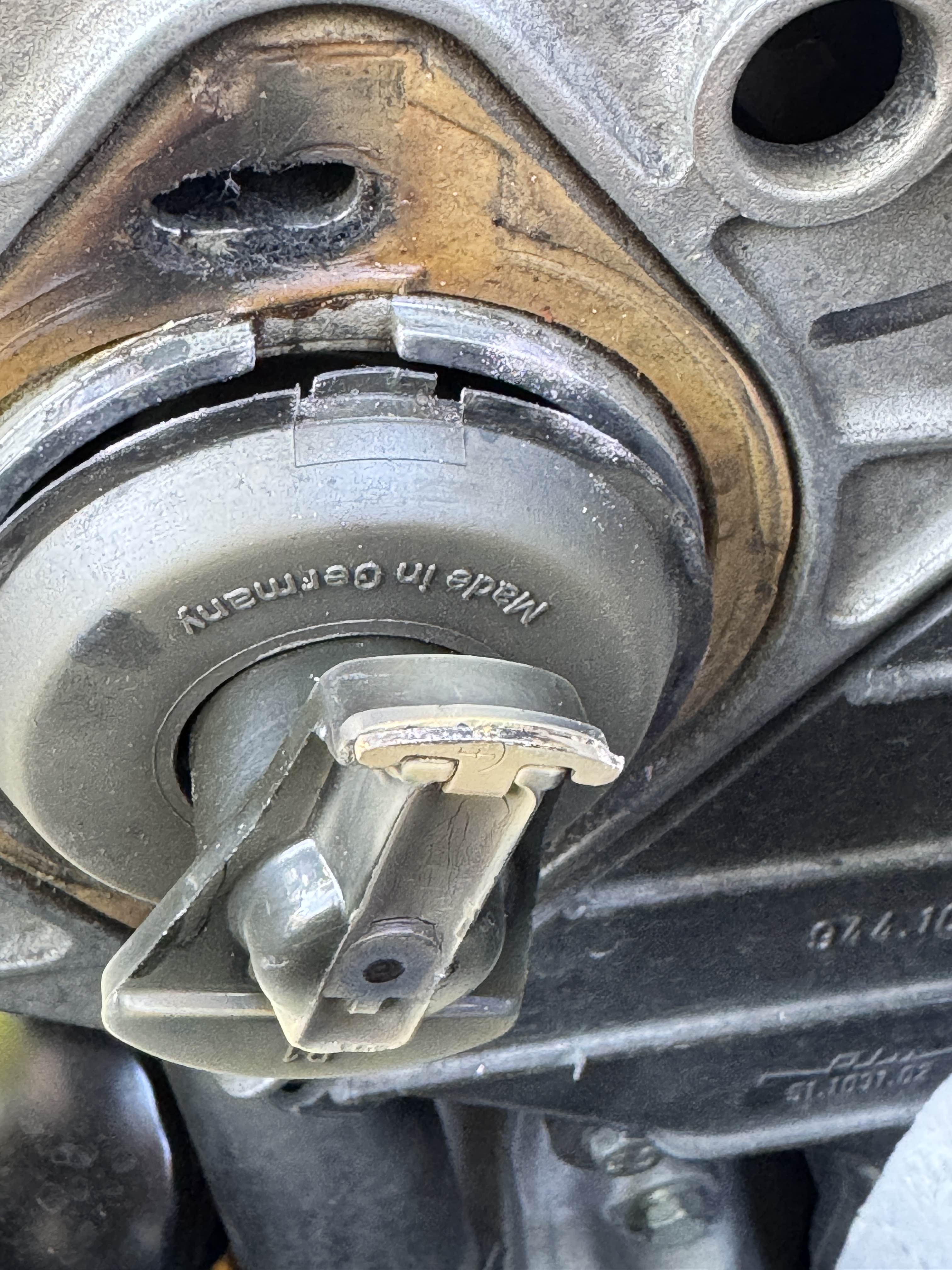

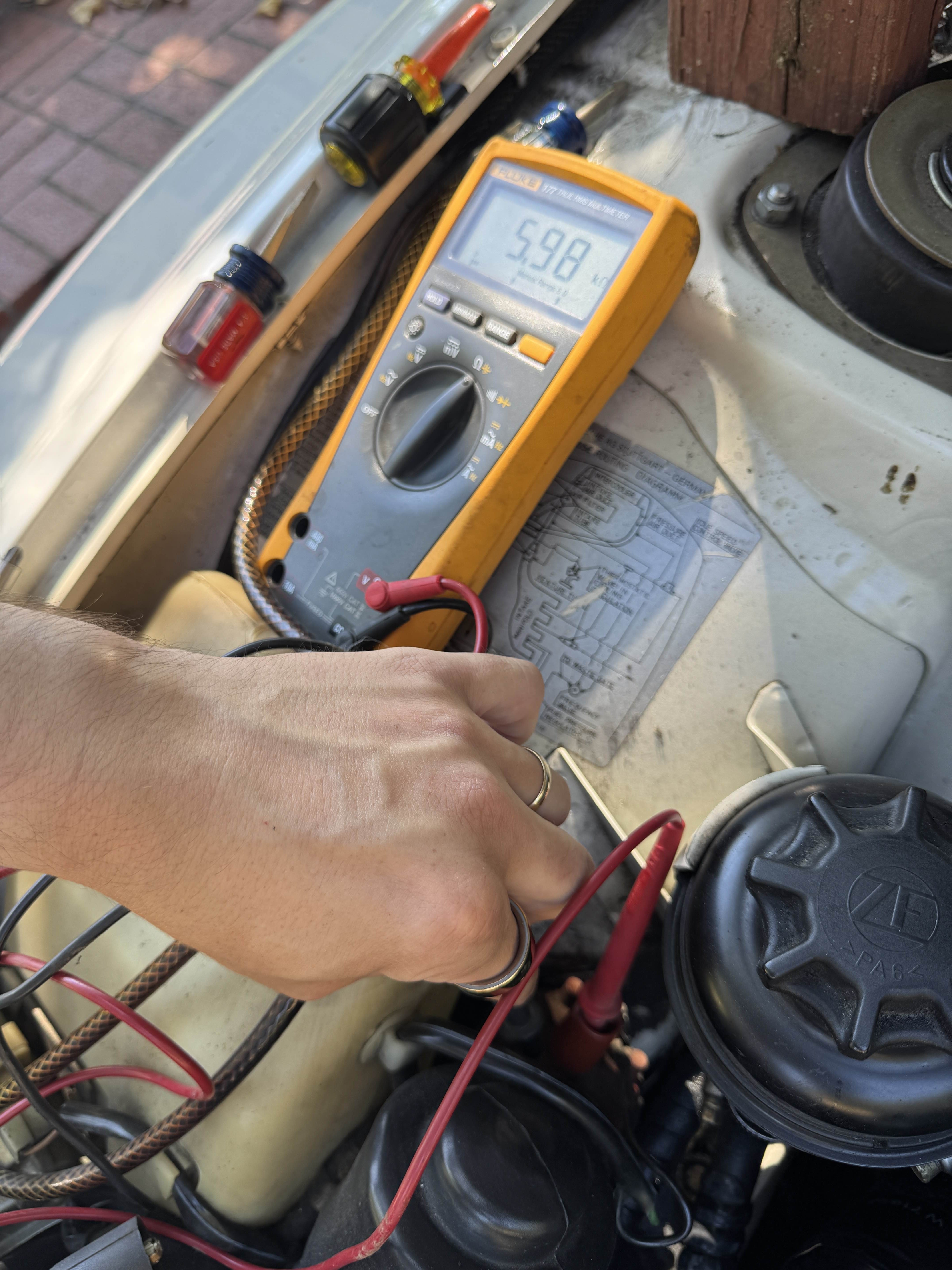

Hey all, after a quick visit to my wife in Canada I am back home and able to do a bit more troubleshooting. I watched and read up quite a bit with ignition coil and distributor cap and rotor issues. I attempted to use a multimeter to test the coil and believe it is bad based on the values I received (granted I couldn't get a value a couple of times when trying which was strange or a reason that it needs replacing).
I pulled off the dizzy cap and saw quite a bit of pitting on the connections and on the rotor. I'll try to attach some photos here.
Primary Coil test ~ 6kOhm

approx 1.7 Ohm
approx 1.7 Ohm
pos to neg terminal.jpg (4.01 MiB) Viewed 1241 times
First time looking at a dizzy rotor but I anticipate this requires replacing.
dizzy rotor.jpg (3.55 MiB) Viewed 1241 times
Same as rotor
Same as rotor
dizzy cap.jpg (3.07 MiB) Viewed 1241 times

Have you pulled a spark plug wire and checked for spark?

I bought a spark tester from harbor freight and checked each plug and they didnt trigger the test light.

Update: car runs now. After pulling off the distributor cap and reinstalling, I think the issue was because I didn’t properly reinstall in last time with the hooks. So I did the spark tester for all 4 plugs and had consistent spark for them all.
