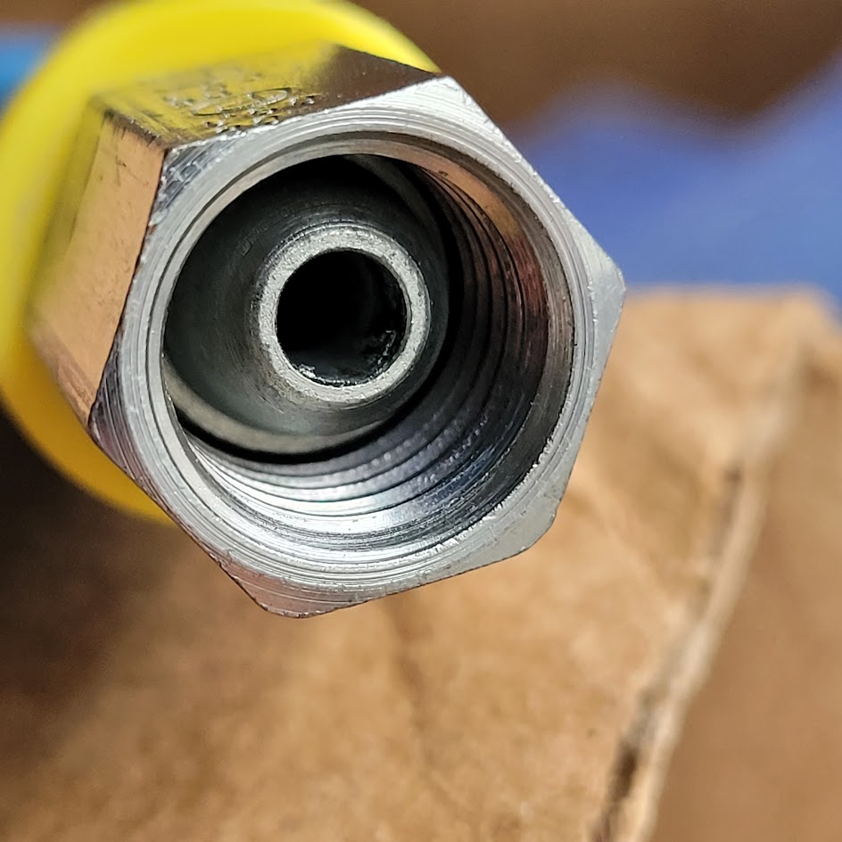

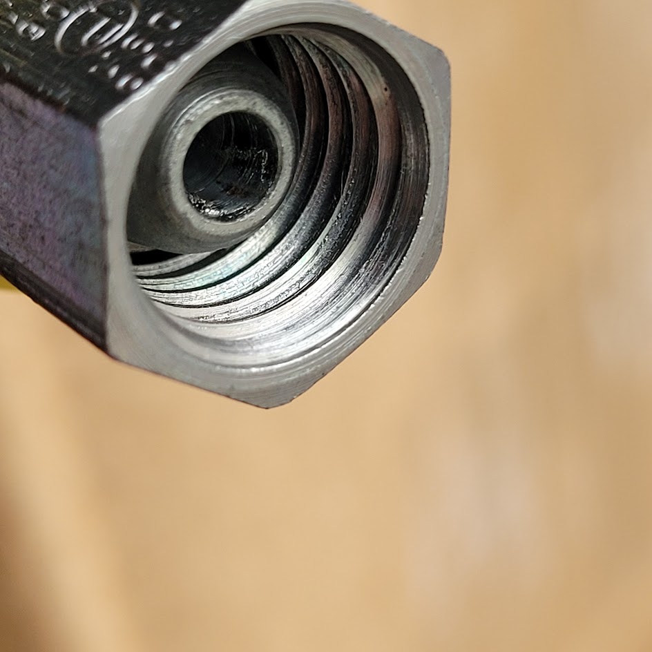

944m3 wrote: Fri Oct 24, 2025 9:00 pm I purchased the Vibrant M12 adapter fitting so that I could bolt it on to the end of the stock fuel rail and keep the fuel regulator in the stock location. Unfortunately while torquing it down to the fuel rail the threaded end snapped off (the end of the fuel rail). Don’t know if I overdid it or the rail was already weak or maybe corroded. I took it as a blessing in disguise and purchased kit from Lindsey including Fuelab regulator. Really nice piece in my opinion.
Should have installation done by this weekend including fuel pressure sensor. Looking forward to getting the car back on the road.
Yikes, sounds like you dodged a bullet there...a fiery bullet!
For what it's worth, the stock fuel rail is supposed to have a kind of spherical seal (like the ball bearing that's under the stock cap). I've heard it described as a "globe seal". The Arnnworx pressure tester I have has the perfect fitting but I don't think I've ever seen one anywhere else. I wouldn't trust anything else personally, although I am probably just paranoid.
I'll post a pic when I get a chance.
Re: Adding a oil pressure and temp sensor
Posted: Sat Oct 25, 2025 7:44 am
by johnb
It's hard to get a clear pic but hopefully these will show it clearly - this is what you want to get a perfect seal on the stock fuel rail:
