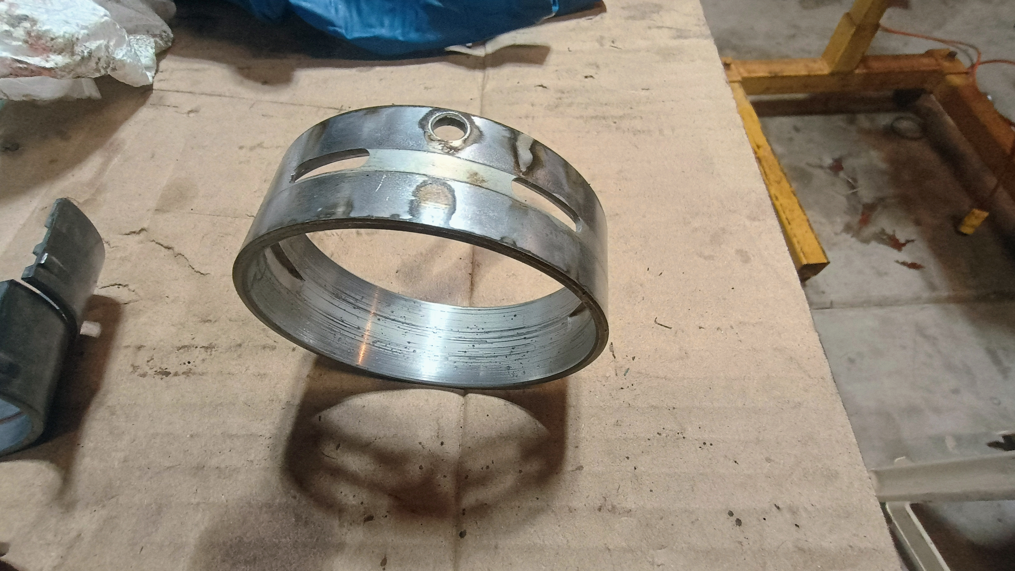

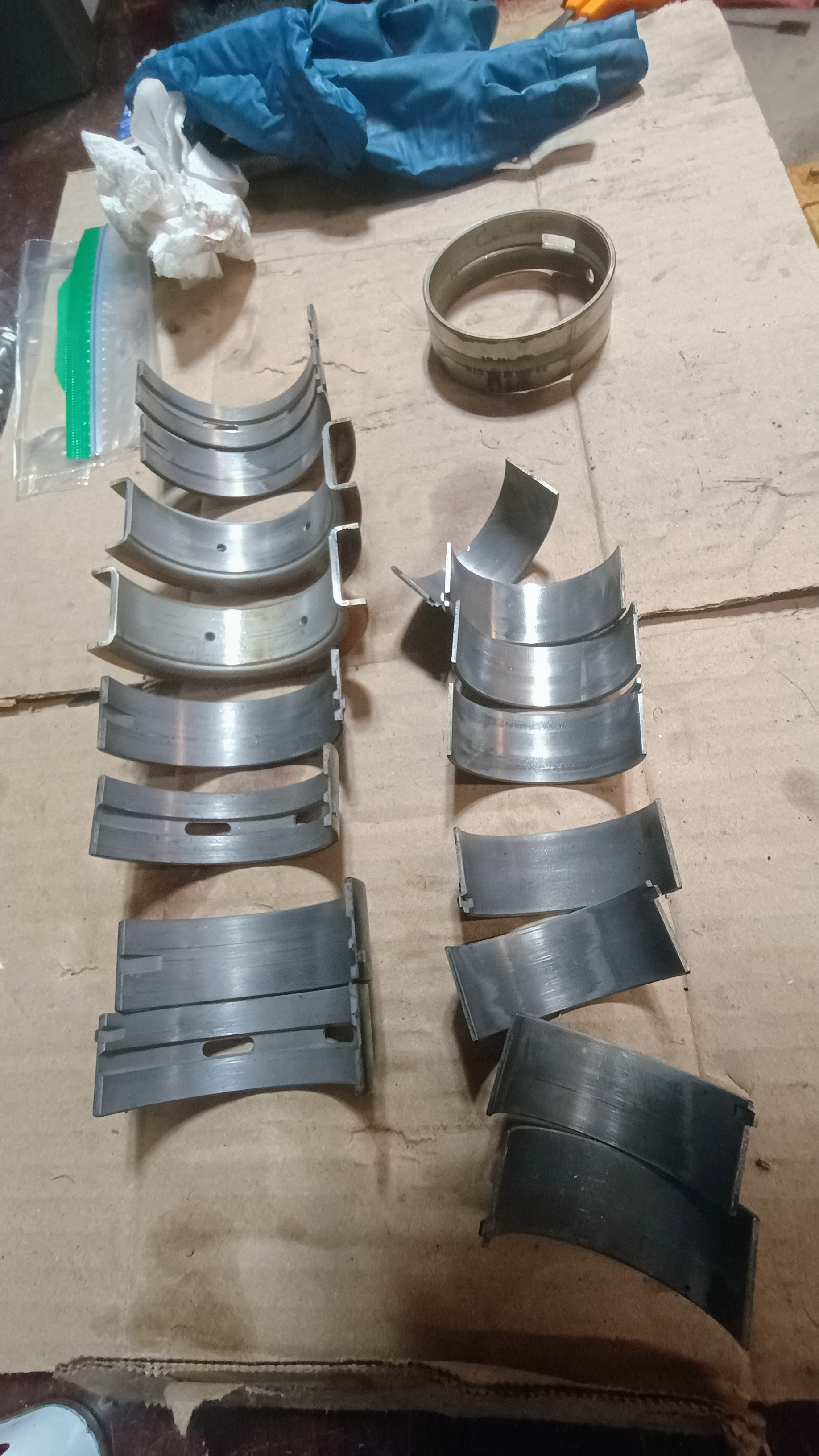

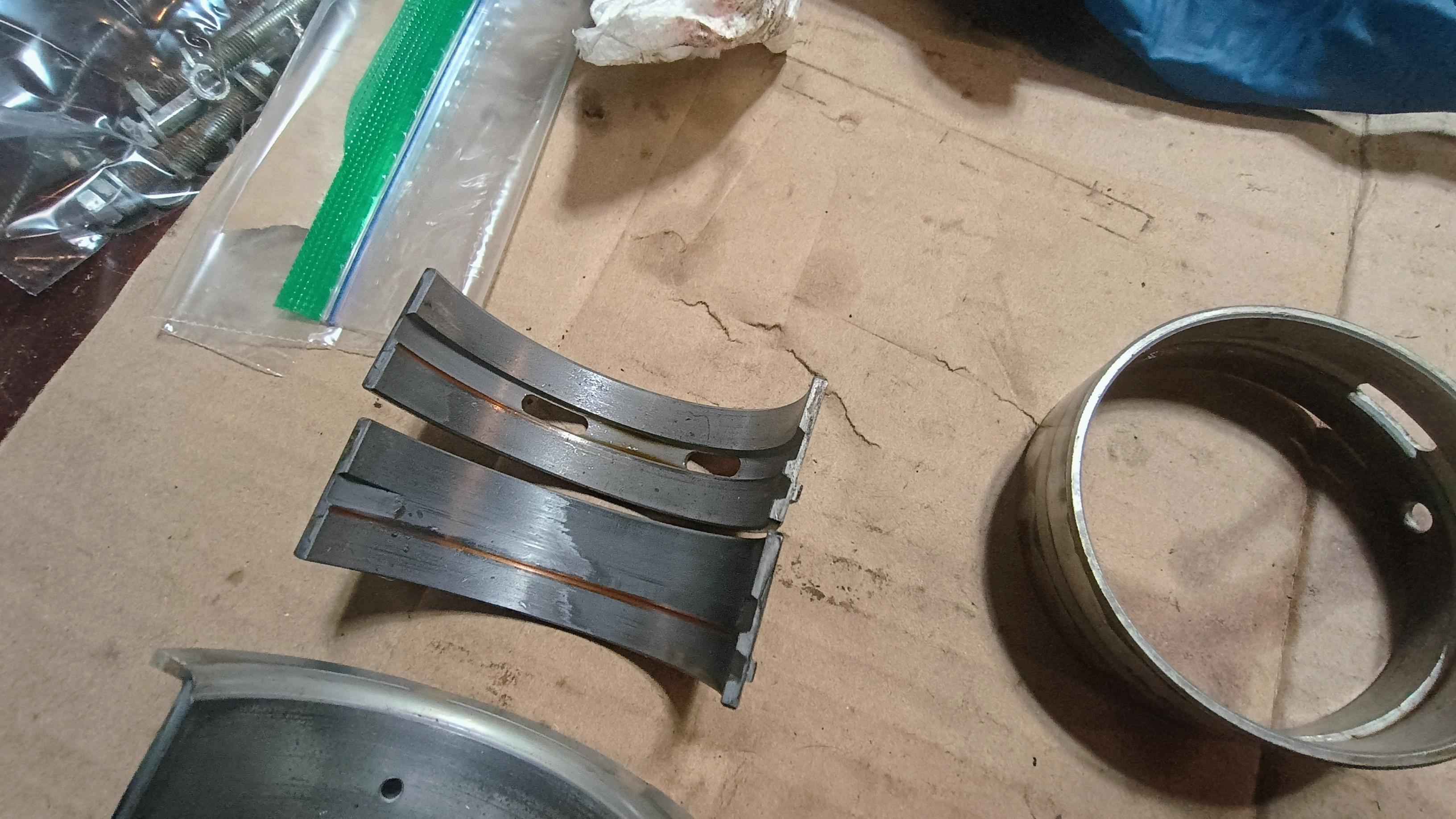

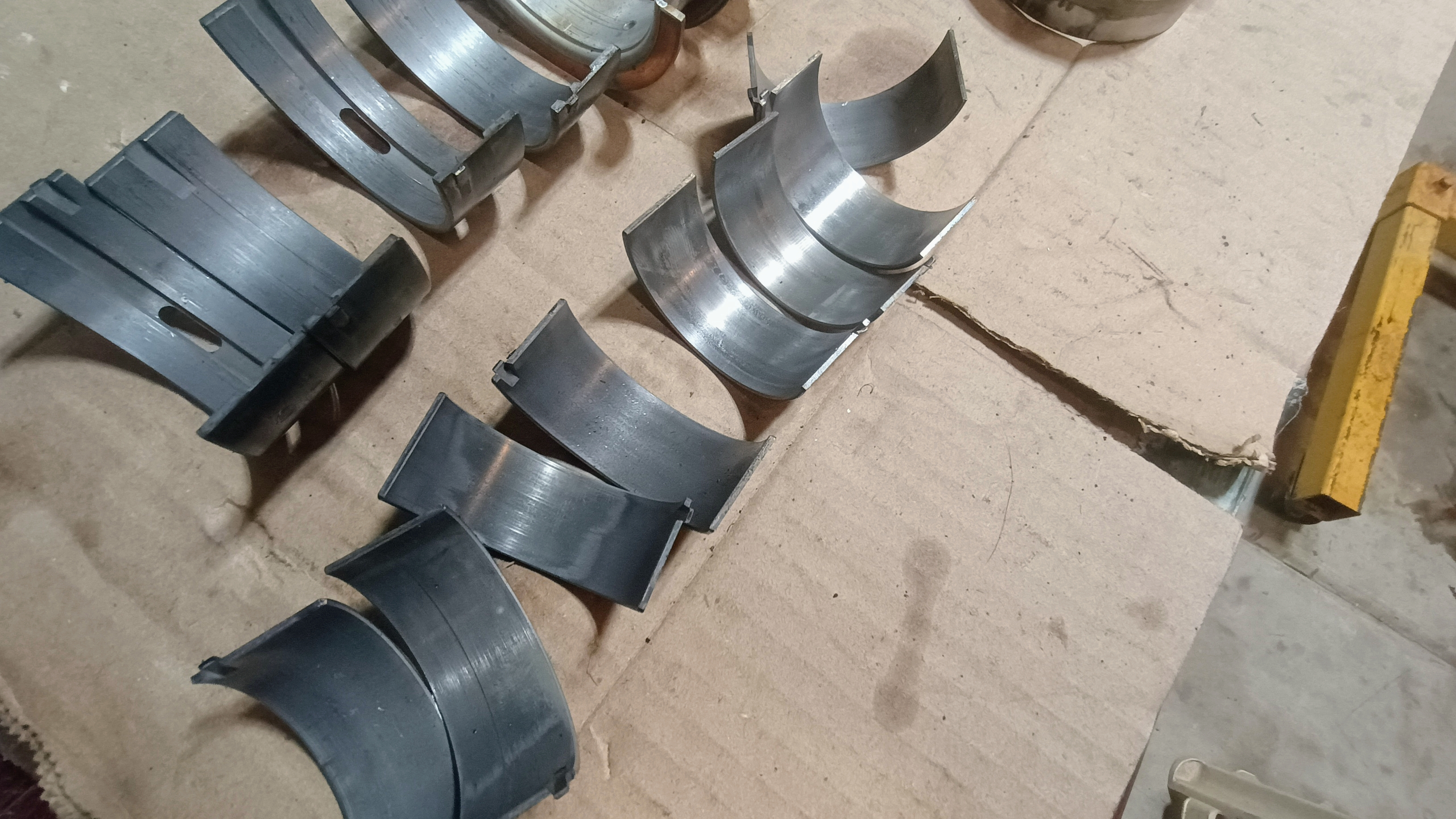

Been waiting on parts and stuff. Still can't figure out what failed. Broke a ring because I couldn't drive 10 minutes to the orileys, had to wait a week for new rings. The bottom end is back together. I polished the crank by hand, and the plasitgage said the new bearings have .002 +/- .0005" of clearance. The pistons had good deal of carbon on the top. Looked like a very low mile engine per the pistons, but the bearings were definitely run dry at some point.
