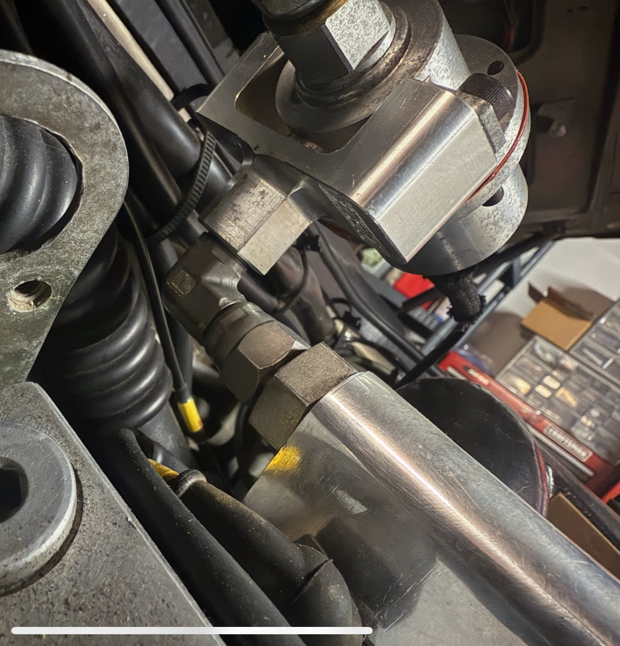

Fejjj951 wrote: Thu Apr 03, 2025 7:57 pm @Darwin
Maybe you already mentioned this but what was the issue with the FPR you were using? I have been using the LR one without issue but now that CW is doing my 3L turbo build, I am debating switching to something like the 1 you are using.
My old setup had the FPR+adapter supported only by a 90deg elbow. Originally it was an aluminum piece but I switched to steel. Ultimately I just wasn’t happy with the fit and potential for fatigue failure so I started searching for a different solution.
Old:

I’ll be changing the return line fitting to a 90 so I can get rid of the elbow and the gauge will only be on to set pressure.
