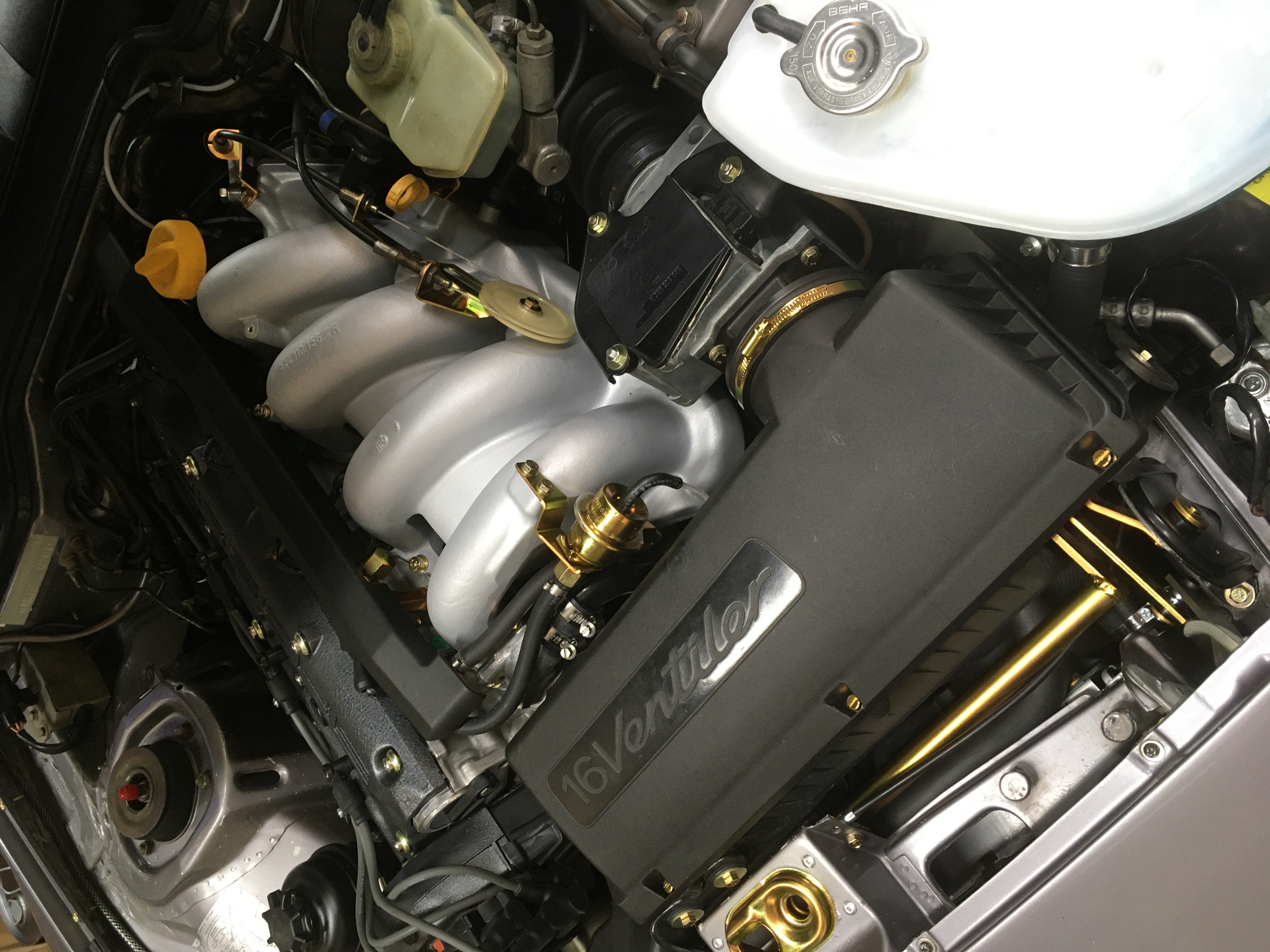

I think the easiest and quickest way to determine if your car has been done properly is to look for the single black-sleeved wire that runs down along the fuel rail, separate from the fuel injector harness, all the way from the 14 pin connector near the power brake servo to the power steering pump. The wire itself will be black with a yellow stripe, the sleeve that it's in is black. I have no quick way to put an arrow on this picture, but you can see it as it passes past the water outlet down the front of the block and joins in with the wire bundle going over the water pump towards the oil filter. All the cars should be wired this way, or very similarly, per the TSB, if a Porsche dealership did it.

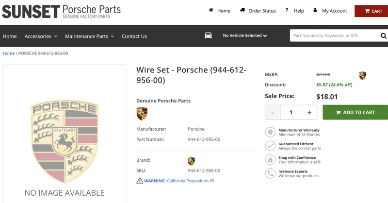

Gaspowered wrote: Tue Apr 22, 2025 6:14 am If you want to keep originality, you might give these guys a call.
They specialize in classic automotive wire.
https://www.narragansettreproductions.c ... opper-wire
Cheers
I just plugged the retro-kit part number into Sunset's site, and it appear to be available still, and only $18!

Tom wrote: Tue Apr 22, 2025 8:39 am
Better option than what I found.
