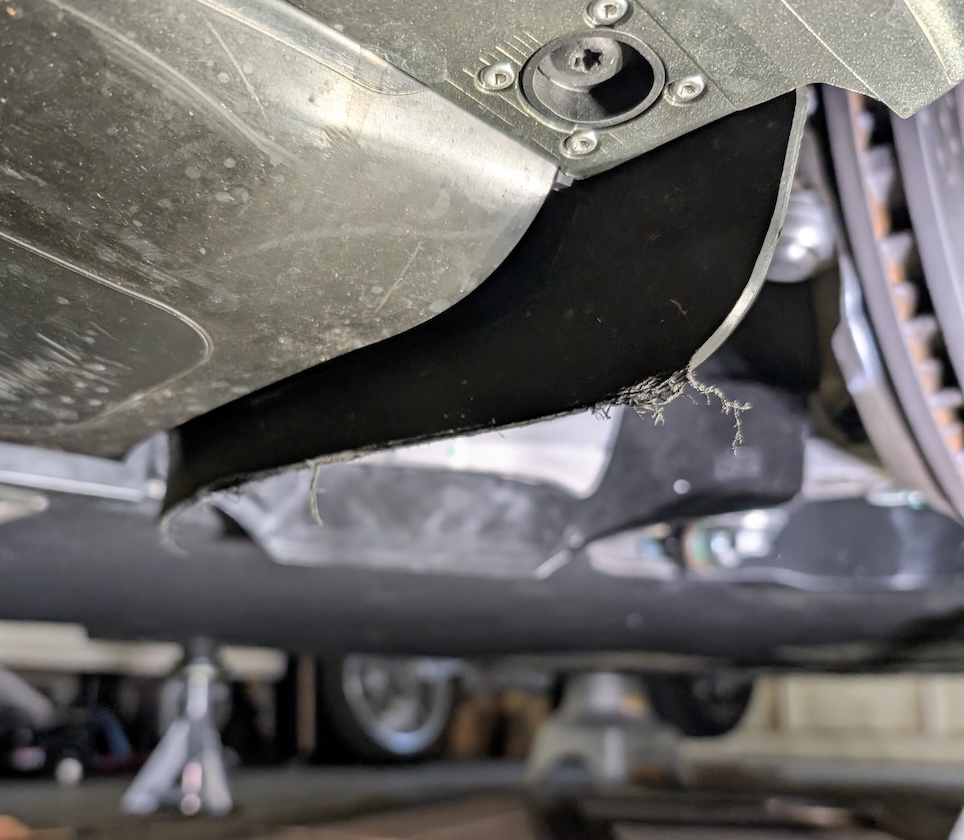

Note that the ride height difference does make a noticeable impact in a couple scenarios:
1) entry angle to driveways
2) scraping the wheel air deflectors when the car is loaded up cornering on undulating pavement. I heard this on a backroads run and was worried at first that it was more serious. See pic below:

Just in the off chance this makes you feel any better myself and many others have went to the GT4 size tires on our non GT4 718s and that has no trouble at all, they are well within the cars workable range.
In fact those tires sizes, especially in the rear, make the car look so much better. The 265s looked stretched on the stock wheels, I keep my stock wheels as my street wheels and bought a set of 19" as track wheels. Like Bill I also use the Bridgestone 255/35/19 front and 285/35/19s in the rear.
