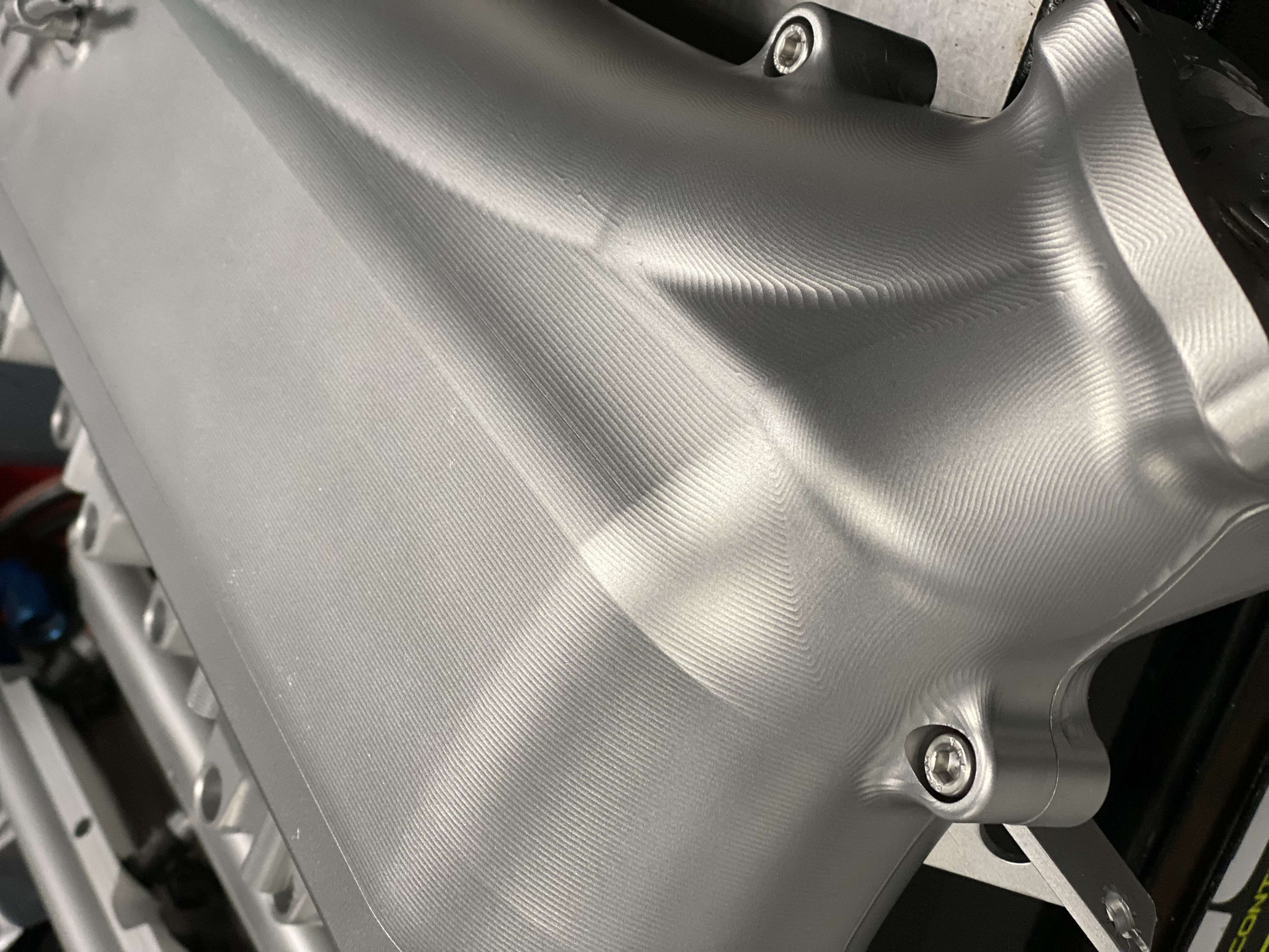

I think we're talking about 2 different items here? Michael wanted someone to produce the Le Mans valve cover but also mentioned wanting someone to 'CAD-ify' an intake design of his. In which case I made the suggestion that if he couldn't find anyone over there, the guy that made mine might be able to help. Although I know he's extremely busy. The finish is fantastic though. Although I think the cam cover needs to be cast for a faithful finish.

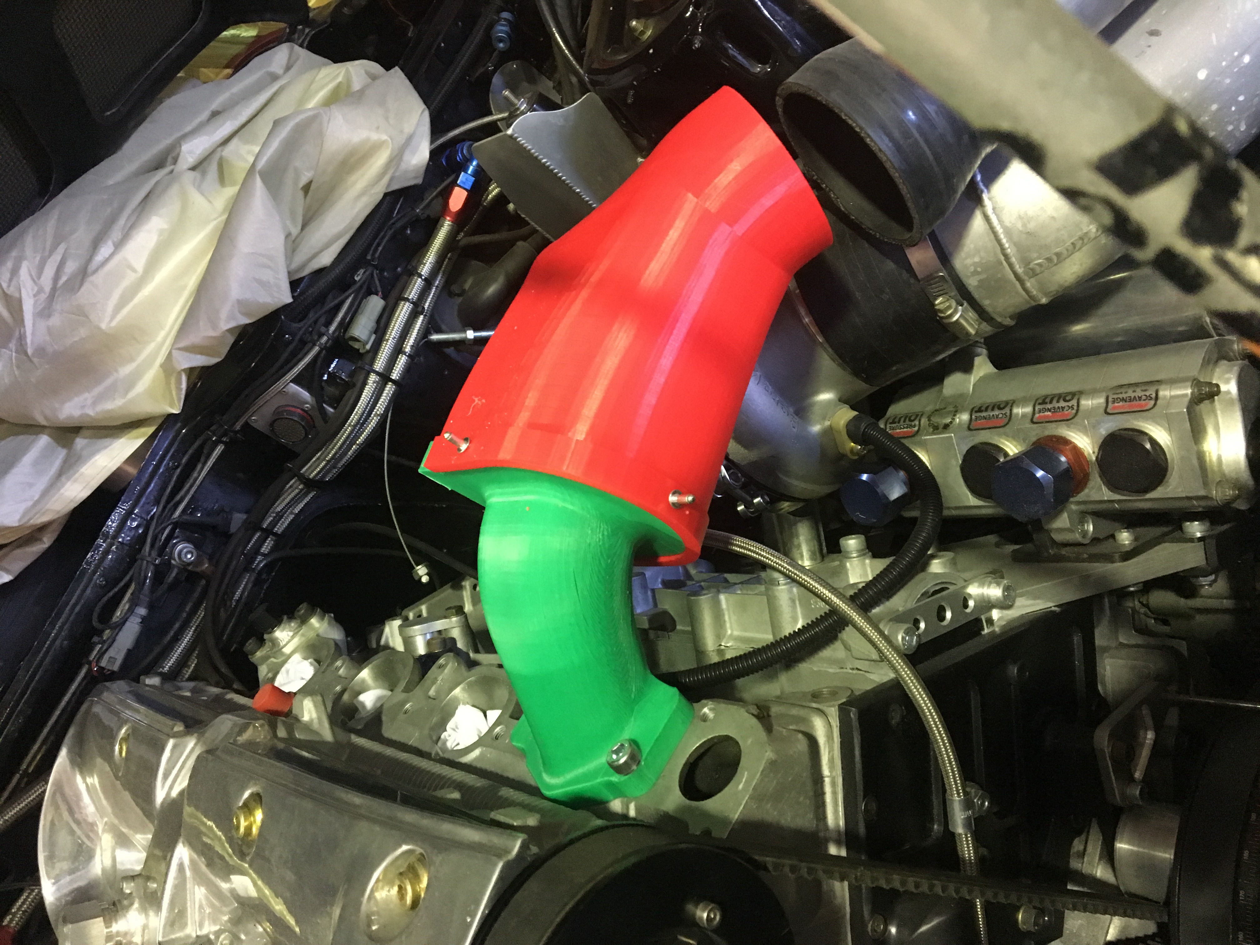

Is that a 3D printed intake?

No, CNC billet alu. Although he did do a few partial printed versions prior to pressing the 'Go' button on the big expensive machine to produce a masterpiece. Was a bit tricky fitting it underhood due to runner length and angles. Hopefully it won't be a further issue now that we're changing throttle body to something larger.

I've been experimenting with Bambu's PPA-CF, and am fairly sure it would hold up fine as an intake like that. Good to 440F degrees with a tensile strength that exceeds some aluminums, at least on paper. My first few prints with it suggest it's the real deal in terms of printer-to-engine-bay parts. That said, even though Porsche put a plastic oil pan on my 992 :shock: :shock: I still wouldn't want a valve cover in plastic. I assume that GTP valve cover has machined bearing races, with oil galleys, etc.?
