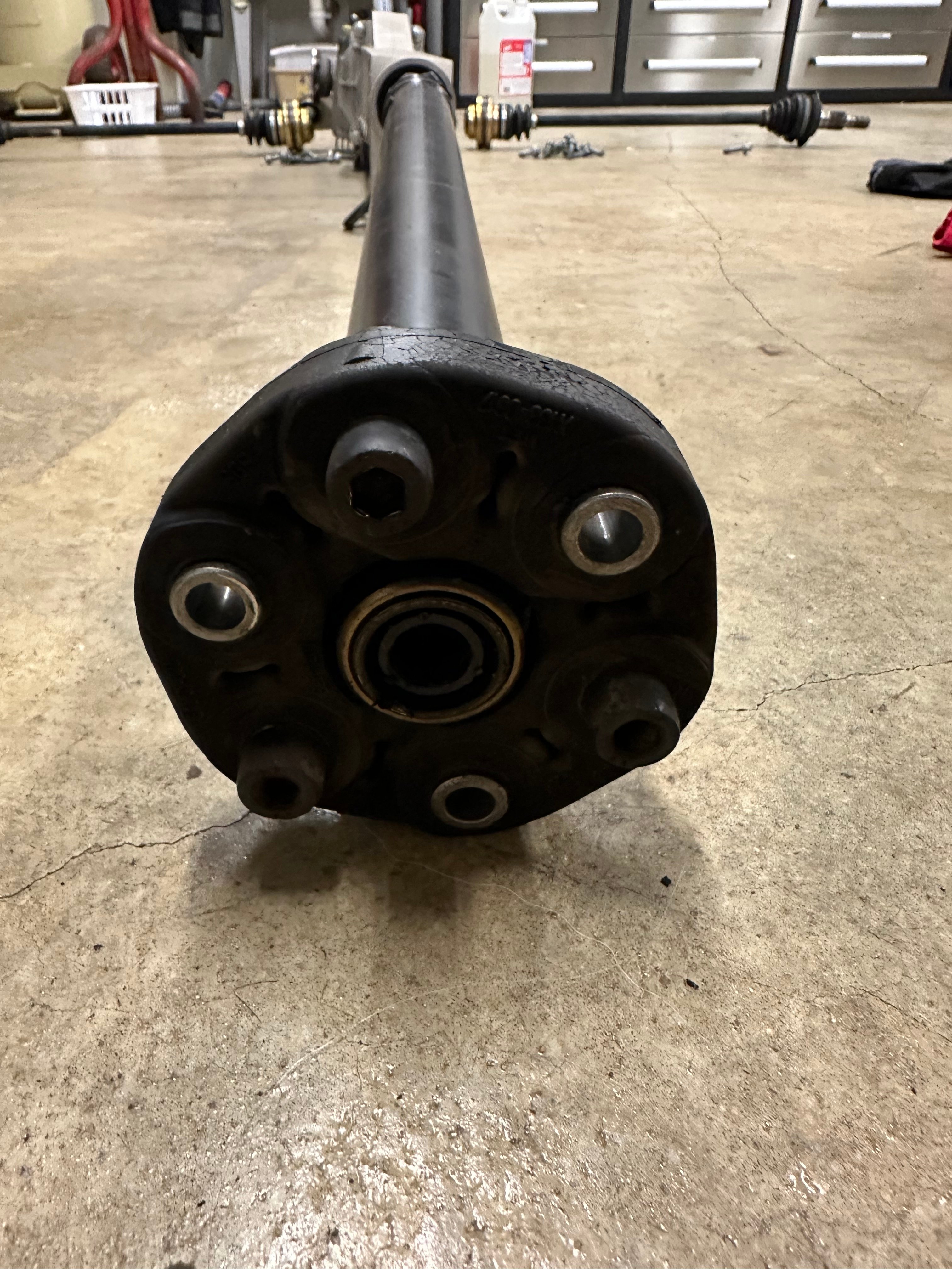

Very interesting - do you happen to have a pic? what about recreating the guibo? (minus the bolts there of course as those attached it to the driveshaft)

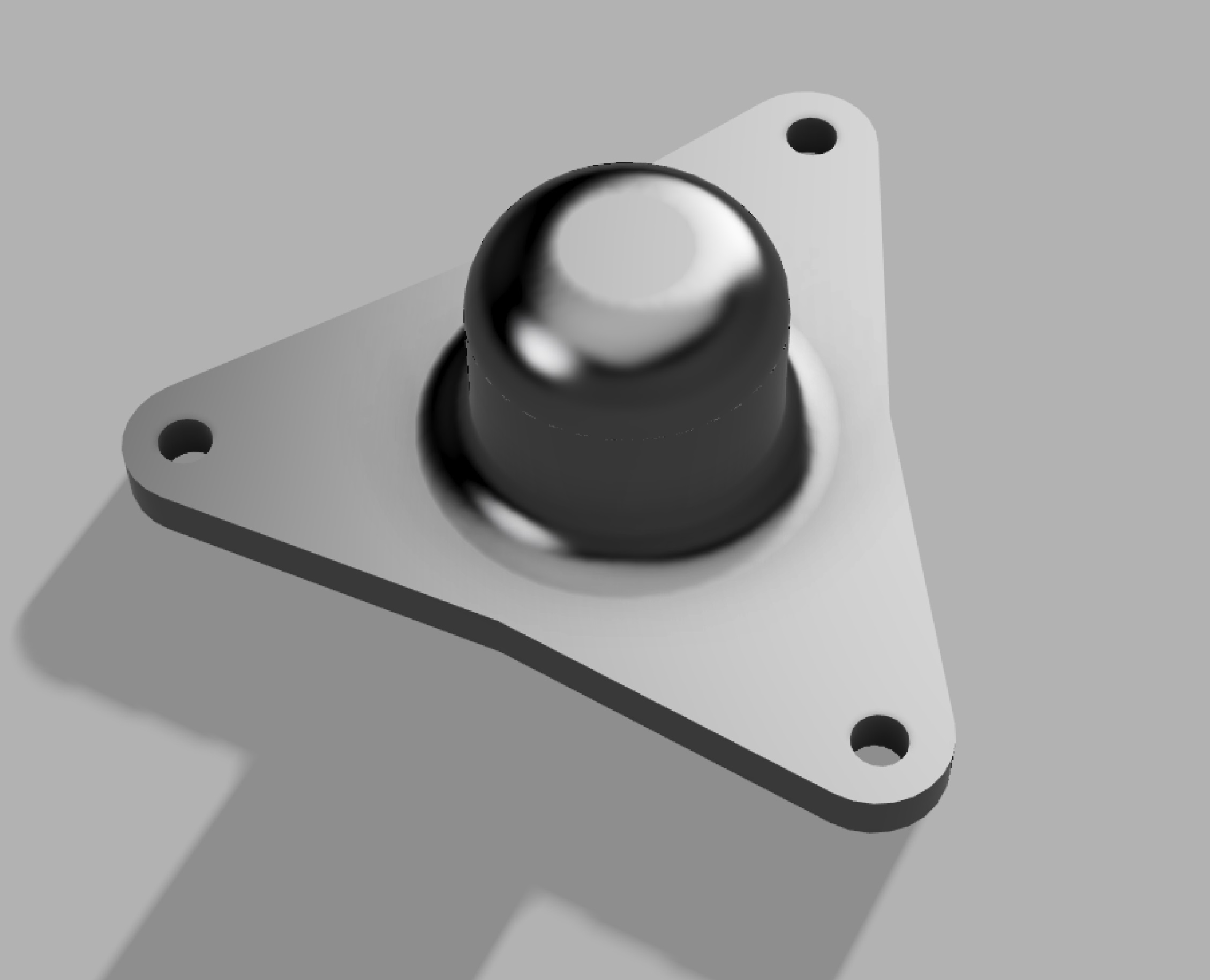

Makes me think that just recreating the guibo with just the three empty holes and then adding a cap where the rod can spin freely would work...
Re: 997.1 C4S RWD conversion
Posted: Sun Feb 02, 2025 5:28 pm
Maruscmn wrote: Sun Feb 02, 2025 5:18 pm Makes me think that just recreating the guibo with just the three empty holes and then adding a cap where the rod can spin freely would work...
Sounds about right to me. :)
Posted: Sun Feb 02, 2025 5:46 pm
Maybe something like this.
Posted: Sun Feb 02, 2025 5:49 pm
by Maruscmn
bingo!!
