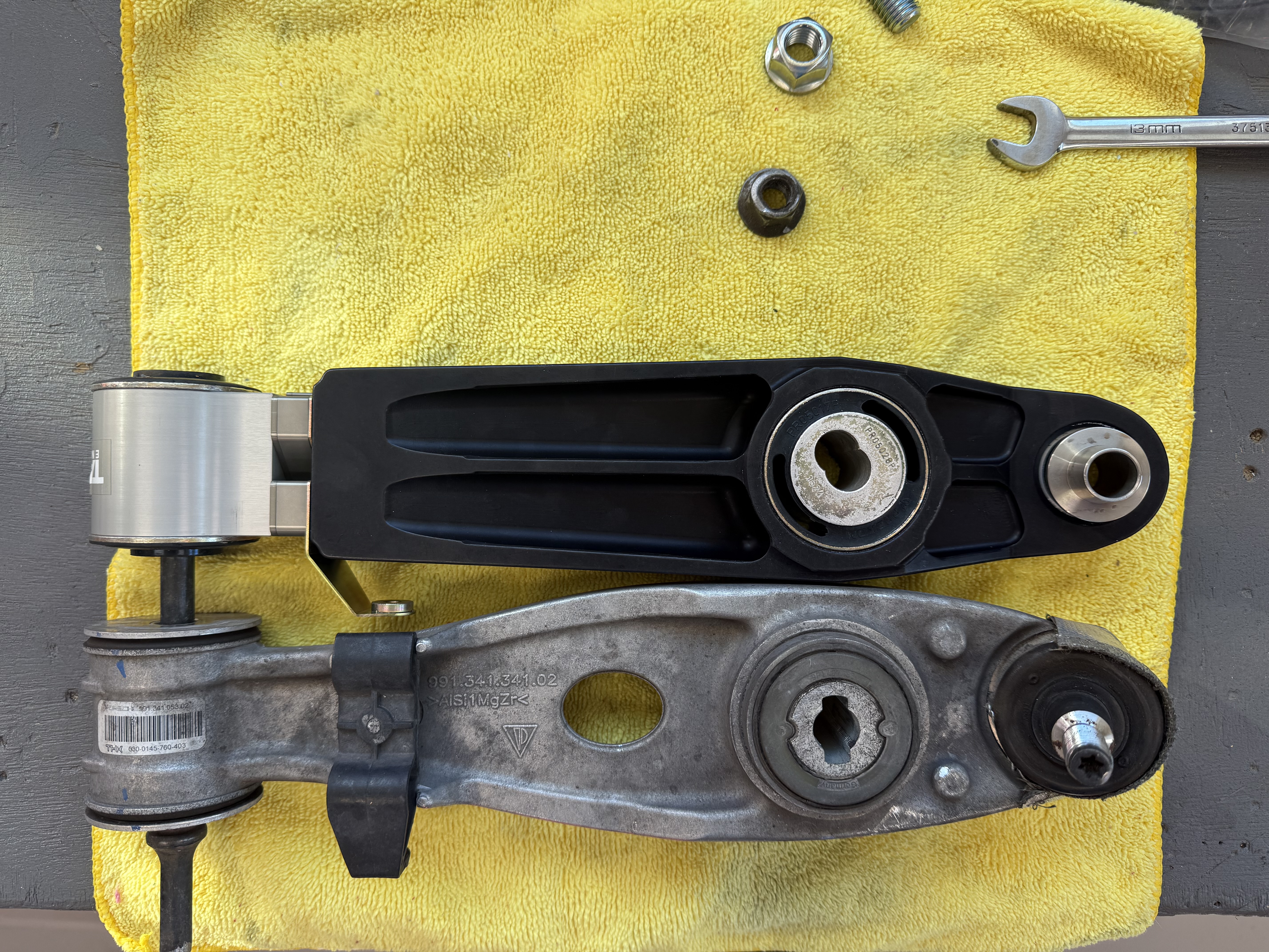

Regarding the front control arms and the bushing that the tension arms connects to, I wanted to add a picture for reference to better clarify what I was trying to explain. In this image this is the front right control arm and the direction of travel is to the right of the picture. This is my stock GTS arm vs the aftermarket arm, the aftermarket has two holes to give the user options. The center hole is correct if the user is going after low camber, more of a stock camber setting. The alternative hole is correct for a track alignment, more aggressive camber.
Edit: wanted to add that when you are installing the arms with your estimated number of shims, which holes to use might be somewhat obvious. In my case I tried 12mm of shim and when I was offering up the tension arm it the hole lined up perfectly with the alternate hole in the LCA. Currently I am at 10mm of shim as I started to be concerned with the tie rod thread engagement. Once I get the alignment close I will count the threads to be sure.

Thanks for the pic. That’s what I’ve read and understand as well. I will be bringing the car to Phoenix soon. My big garage and tools are still there. Hope to catch up with you if you’re open to it.J-Dub wrote: Sat Jan 11, 2025 12:13 pm Regarding the front control arms and the bushing that the tension arms connects to, I wanted to add a picture for reference to better clarify what I was trying to explain. In this image this is the front right control arm and the direction of travel is to the right of the picture. This is my stock GTS arm vs the aftermarket arm, the aftermarket has two holes to give the user options. The center hole is correct if the user is going after low camber, more of a stock camber setting. The alternative hole is correct for a track alignment, more aggressive camber.
