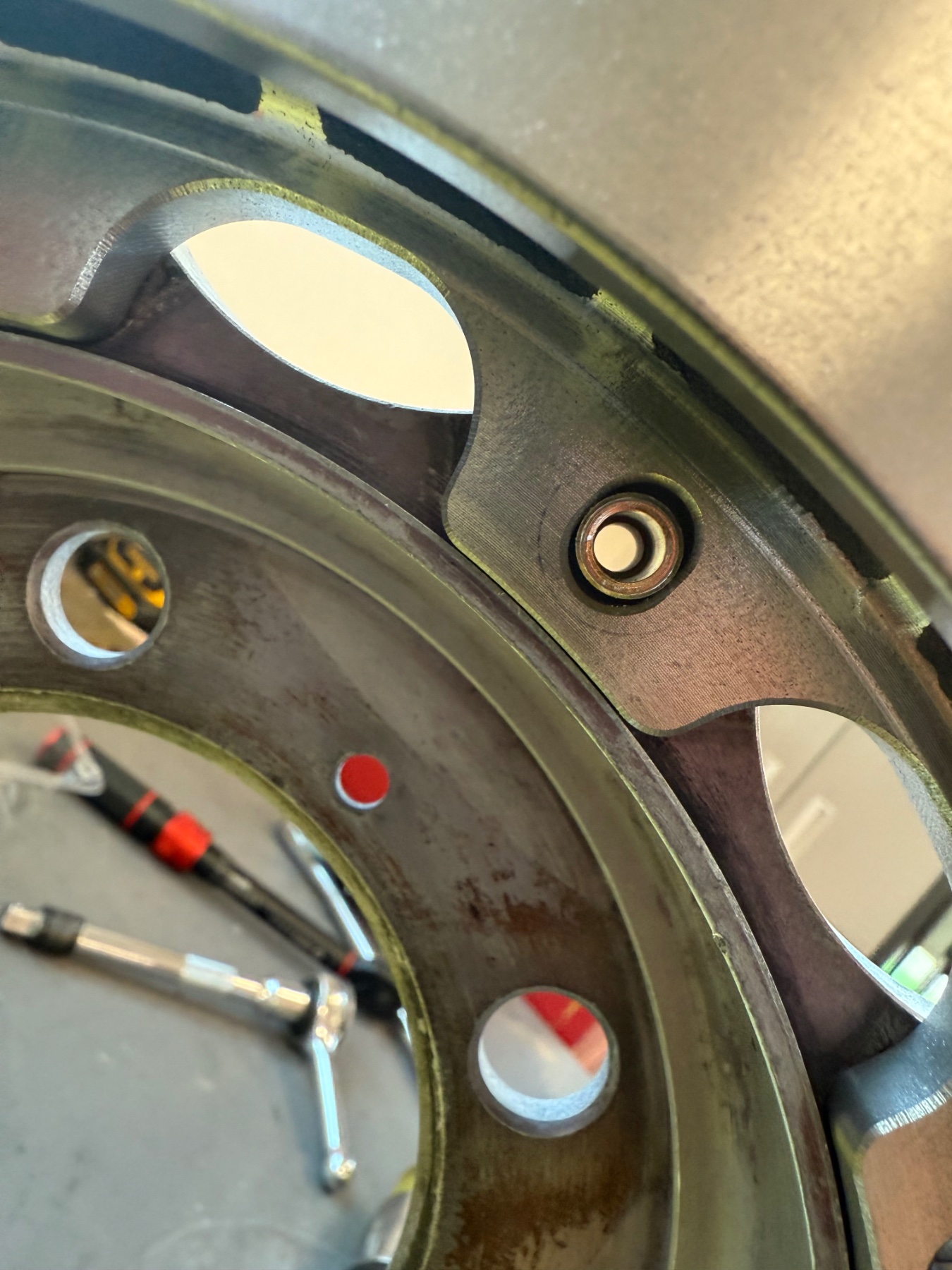

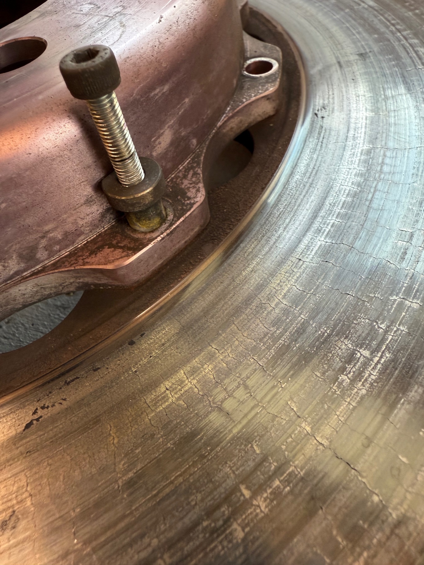

Today I replaced the rotor rings on my 2 piece, floating rotor, GiroDisc brake rotors. This is not a how to but just wanted to show you the overview of what it is like to replace, AP, Paragon and many others are going to be similar. Removal of the rotors from the car is no different than the stock one piece.
When you get the rotors on the bench you will find 10 fasteners. 5 look just like cap screws with washers, the other 5 are cap screws with a bridge and a stack of washers. GiroDisc instructions says that their kits have between 8 and 12 total fasteners depending on the size of the disc.
The captured nuts need to be removed. Here I have the screw in from the other side to pull it out but later realized it is easier to push them out while you are unscrewing the fastener.

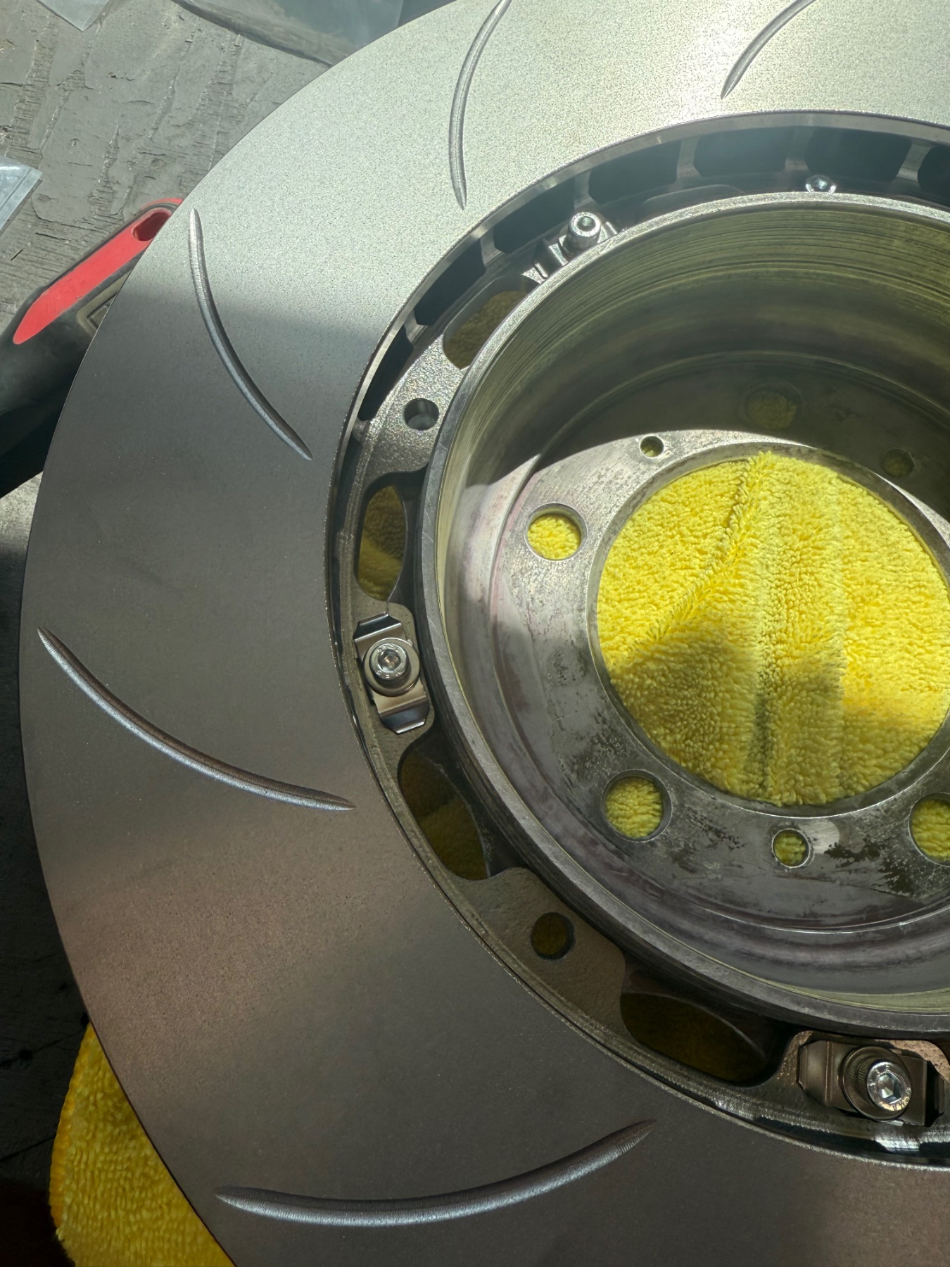

The replacement rotor rings include new hardware and are organized so you cannot mix them up. Notice there are two fastener types and you alternate the holes as you install them.
Cleaned up the hub and now starting to install the new hardware
Notice the the hole in the rotor is actually a slot so that the rotor can grow/move as it heats up and cools down.
The instructions say to use high temperature thread locker. I purchased this one but later emailed them and they said any red thread locker would work.

The washers used in the fastener kit is beveled, sort of cone shaped. This is so there is tension but the rotors can still move independent of the hub. It is important you do not over tighten the fasteners or the washers will be pushed flat and not be effective. They specify 60 inch pounds of torque, which is 5 foot pounds. The torque wrench I have lowest rating is 5 fl/lbs and I did not feel good about using that one as it at the edge of it rated range.
The fasteners use a 4mm hex head, which I have a 3/8" drive. All of the in/lb rated wrenches use 1/4" drive so I would also need an adapter to 3/8" drive. I ended up buying and liking this one.
https://www.amazon.com/dp/B0D3D41DM2?re ... title&th=1

New rotors installed looking fresh. Note that it is not important which way the slots point but it is important which way the internal vanes go so that the air is drawn in the center of the brake rotor near the hub and slung out the edges, the vanes effectively create an air pump.
These hubs are early GiroDisc where they used a blue anodizing that faded quickly, they now use a black anodize that is resistant to fading. They offered to re-anodize these for me but I did not have the time. I hit these with oven cleaner and scotch brite pads till they mostly are just aluminum.
