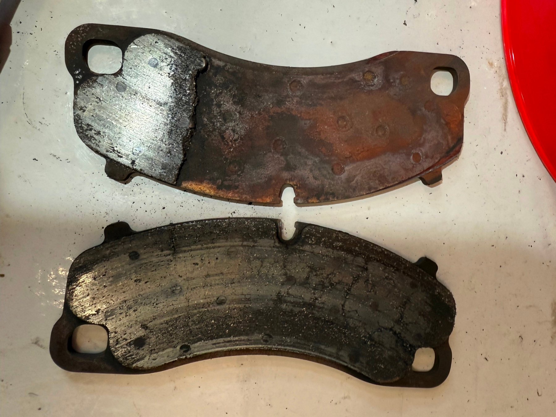

A post and others' comments in the "What did you do with your 718 this week?" topic from J-Dub regarding intense (severe!) brake pad wear following multiple track-days. :thumbup:

Jeremy did have quite a few events on these pads, but this is an excellent illustration of why one should still check their brake pads often as well as explaining why PCA wants a good inspection prior to their events ( now good for two months instead of just one month last year ).

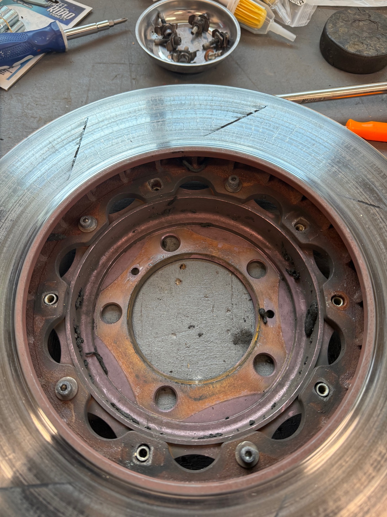

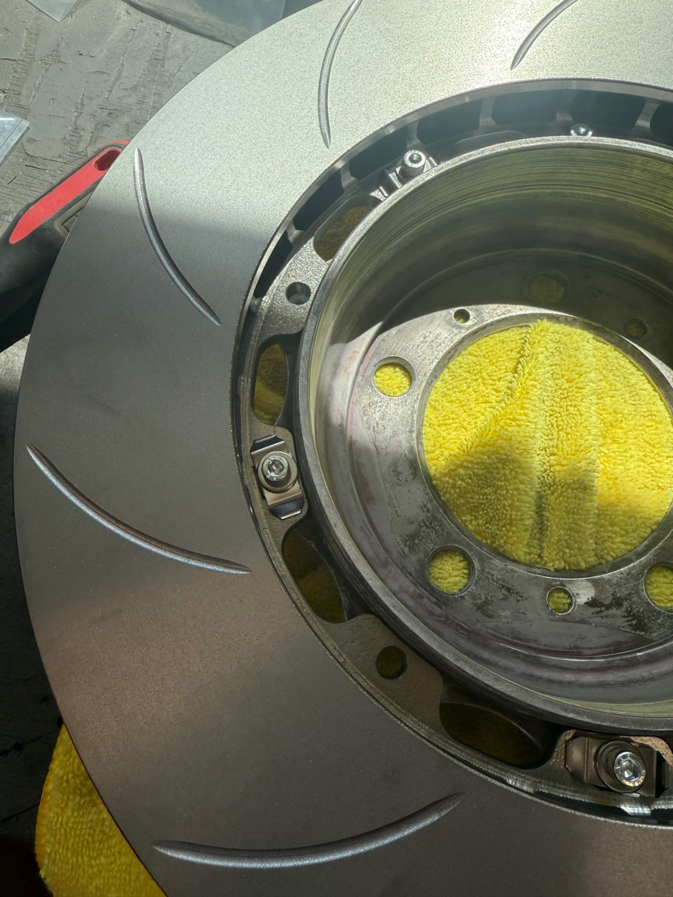

When you get the rotors on the bench you will find 10 fasteners. 5 look just like cap screws with washers, the other 5 are cap screws with a bridge and a stack of washers. GiroDisc instructions says that their kits have between 8 and 12 total fasteners depending on the size of the disc.
The captured nuts need to be removed. Here I have the screw in from the other side to pull it out but later realized it is easier to push them out while you are unscrewing the fastener.

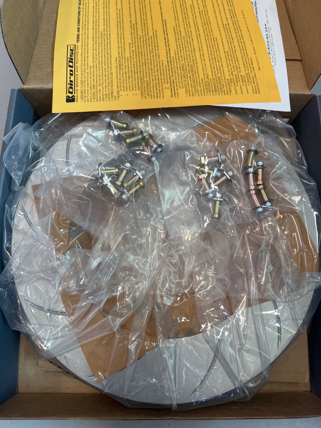

The replacement rotor rings include new hardware and are organized so you cannot mix them up. Notice there are two fastener types and you alternate the holes as you install them.
Cleaned up the hub and now starting to install the new hardware

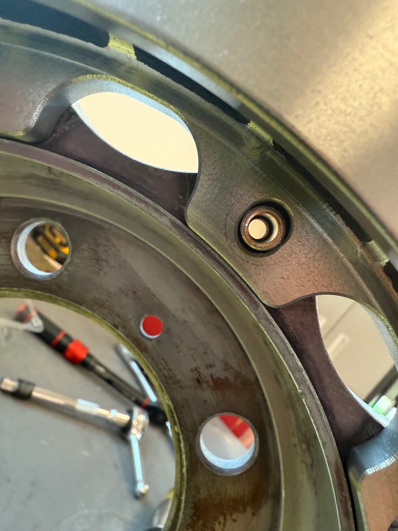

Notice the the hole in the rotor is actually a slot so that the rotor can grow/move as it heats up and cools down.
The instructions say to use high temperature thread locker. I purchased this one but later emailed them and they said any red thread locker would work.
https://www.vibra-tite.com/threadlocker ... eadlocker/
The one they say they use
https://www.mscdirect.com/product/detai ... v-_8&gQT=1
The washers used in the fastener kit is beveled, sort of cone shaped. This is so there is tension but the rotors can still move independent of the hub. It is important you do not over tighten the fasteners or the washers will be pushed flat and not be effective. They specify 60 inch pounds of torque, which is 5 foot pounds. The torque wrench I have lowest rating is 5 fl/lbs and I did not feel good about using that one as it at the edge of it rated range.

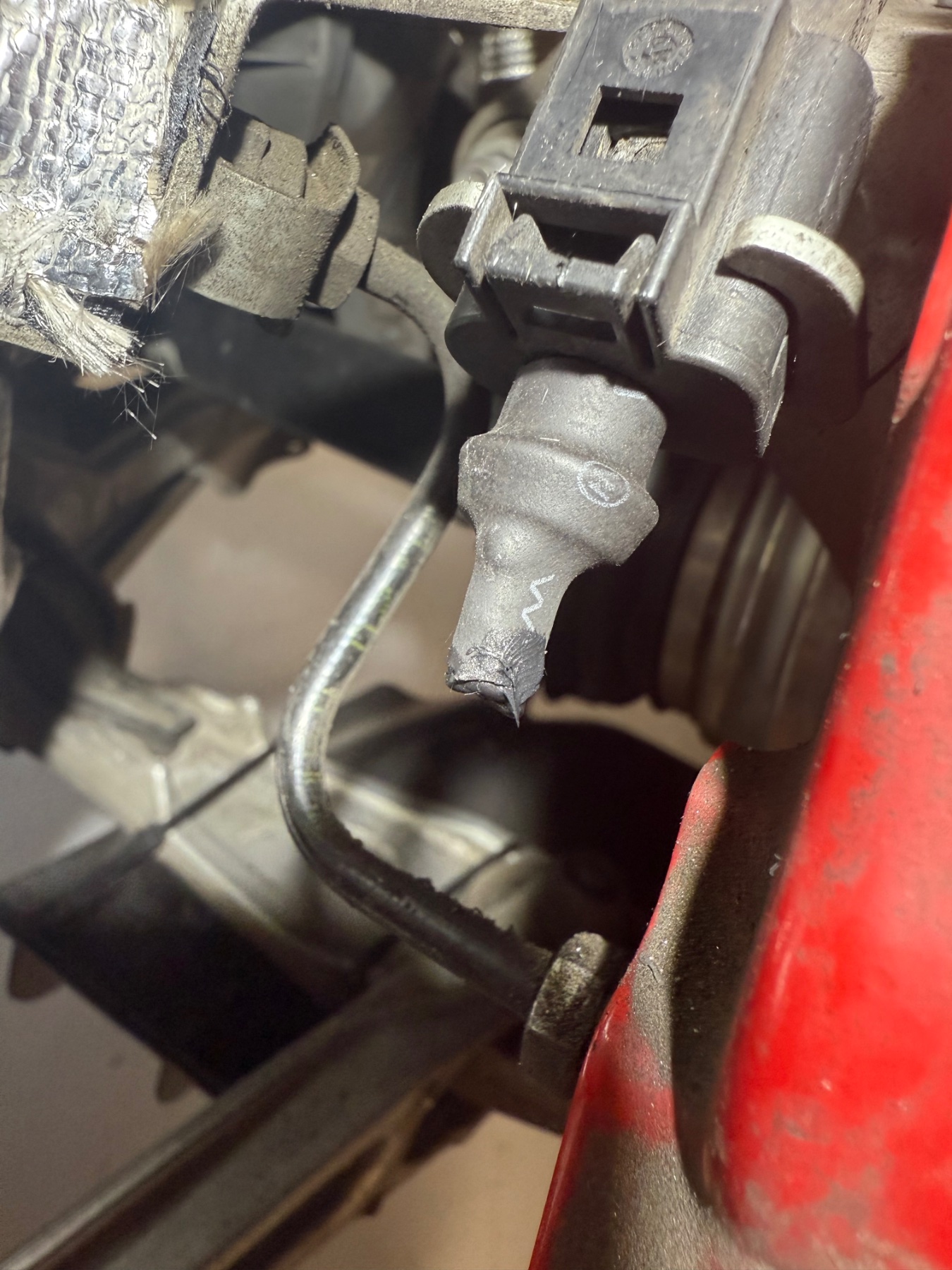

Recently I was trying to get through the rest of track season with the pads I had. I wore one of the front pads so thin a portion of the pad broke off of the backing plate. It was not until I got home for a brake inspection did the wear indicator alert light on the dash trigger. That inspired me to eliminate the wear sensor. I cut the two wires short, striped a bit of insulation, soldered them up, twisted the wires tight to the connector, added heat shrink and sealed the end of the heat shrink with RTV.

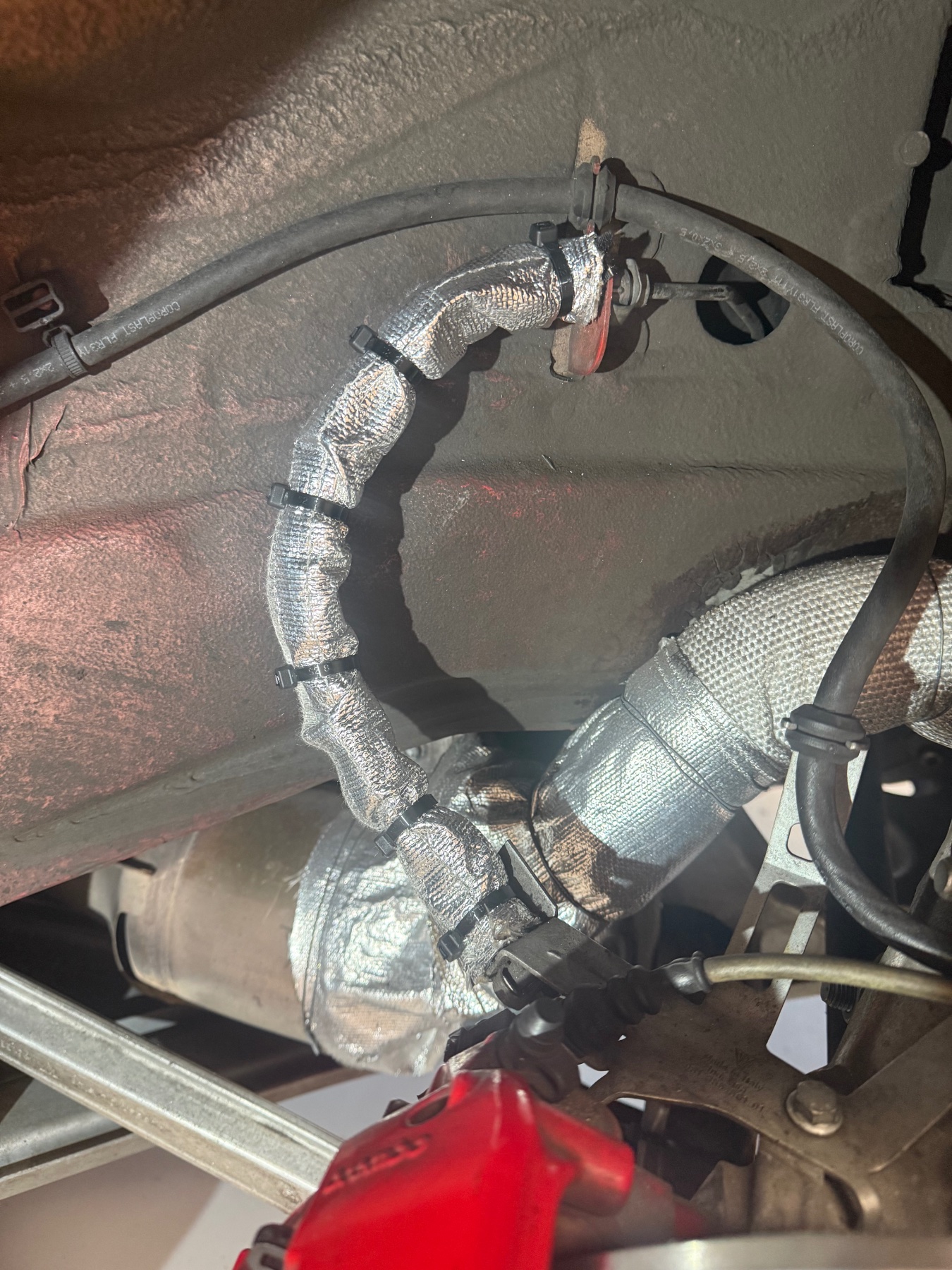

Heat! The Over Axle Pipes are right near the rear brake lines. Though I do have some home brew heat shields on the OAPs after I determined that the Jet Hot coating was not sufficient I decided to also add some heat shielding to the brake lines.
This is locally available heat sleeve that Velcro together but they have another version for half the price without the Velcro. To do it again I would skip the Velcro. Both are on the shelf at the local auto parts stores. After these pictures were taken I replaced the zip ties with stainless steel wire.

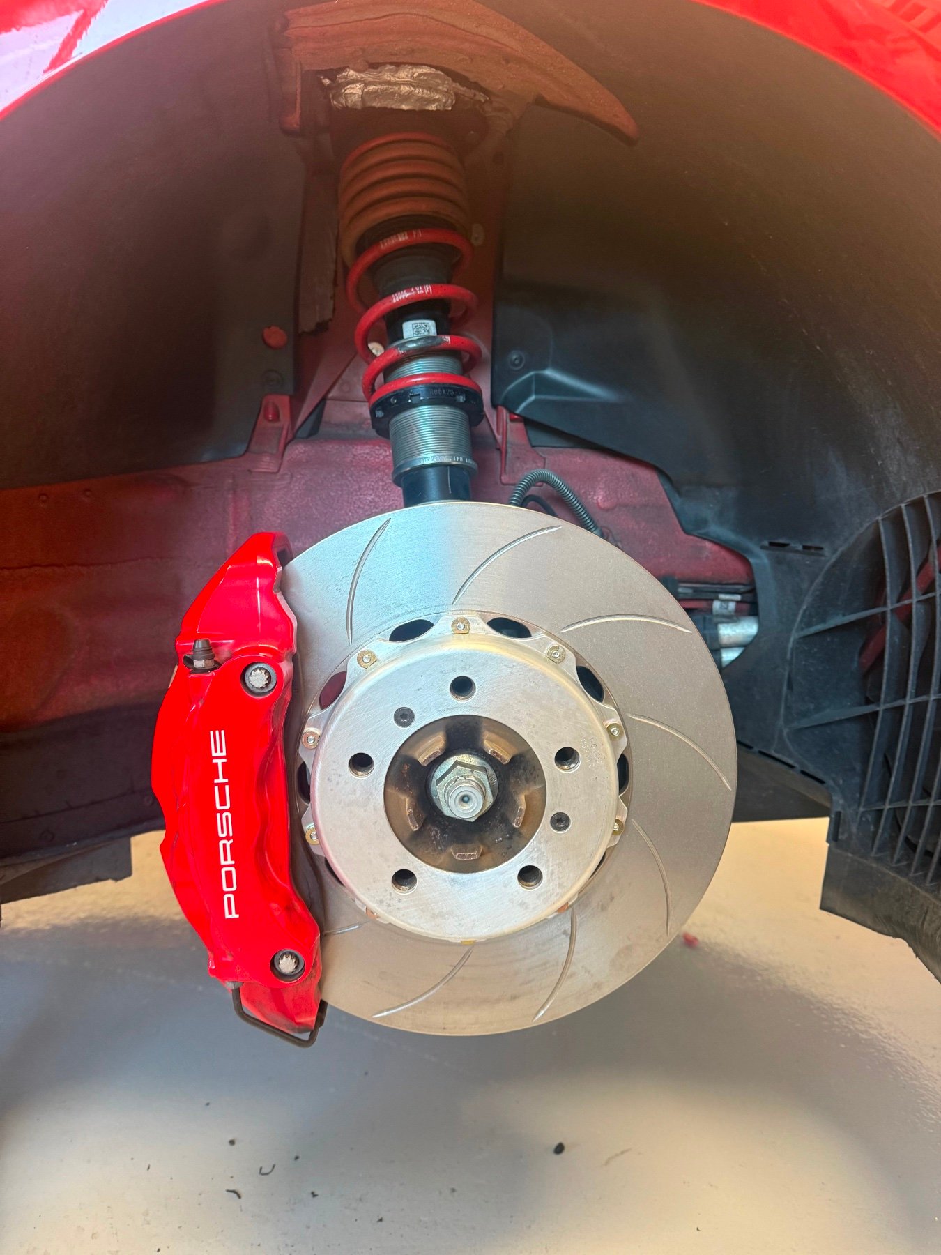

New rotors installed looking fresh. Note that it is not important which way the slots point but it is important which way the internal vanes go so that the air is drawn in the center of the brake rotor near the hub and slung out the edges, the vanes effectively create an air pump.
These hubs are early GiroDisc where they used a blue anodizing that faded quickly, they now use a black anodize that is resistant to fading. They offered to re-anodize these for me but I did not have the time. I hit these with oven cleaner and scotch brite pads till they mostly are just aluminum.

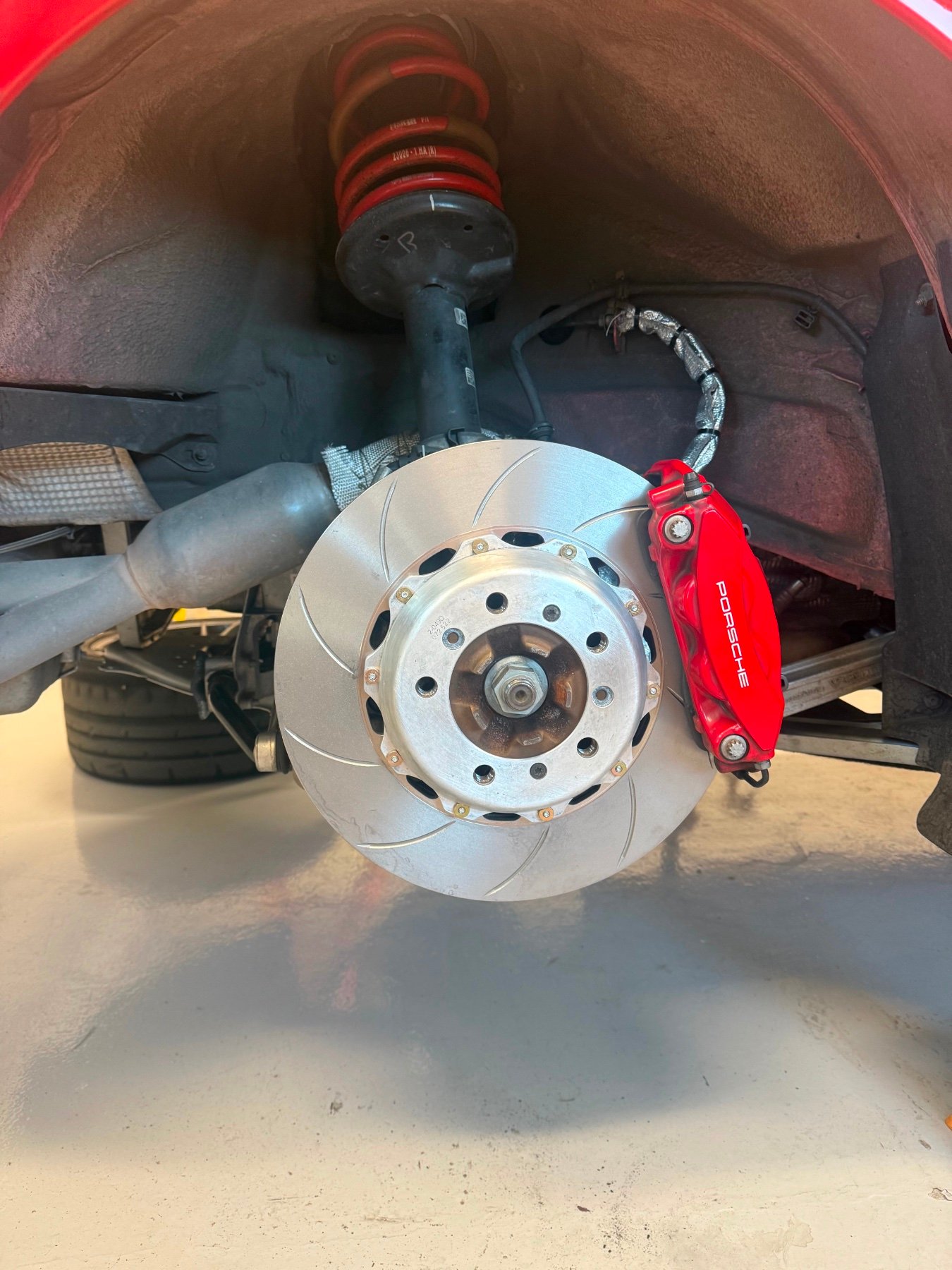

Rear
IMG_5943 rotated left.jpeg (339.34 KiB) Viewed 1208 times
Front
IMG_5944 rotated left.jpeg (309.7 KiB) Viewed 1208 times
