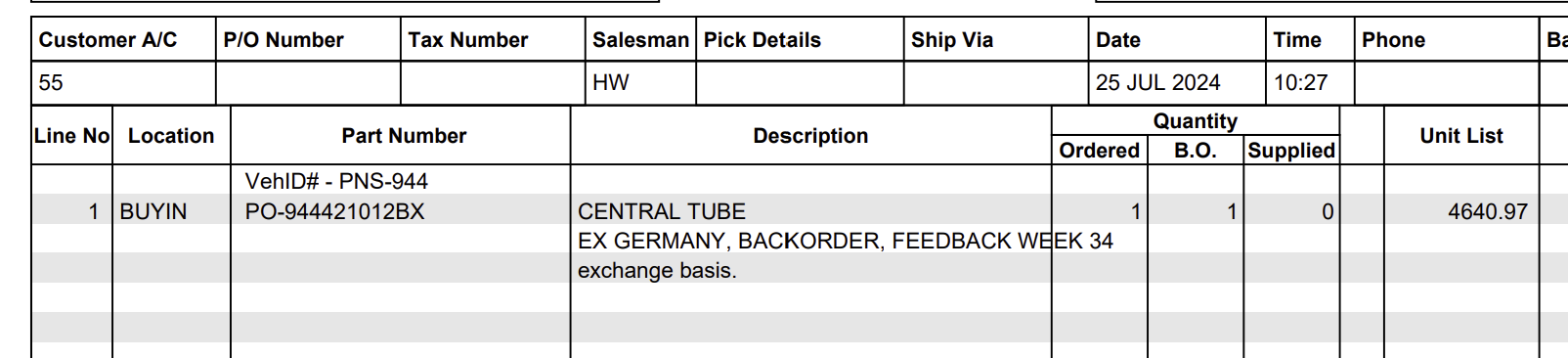

Screenshot 2025-03-11 064432.png (80.58 KiB) Viewed 5028 times
Good luck getting one from Porsche, that quote was in Australian dollars, so approx US$2900 for an exchange unit
