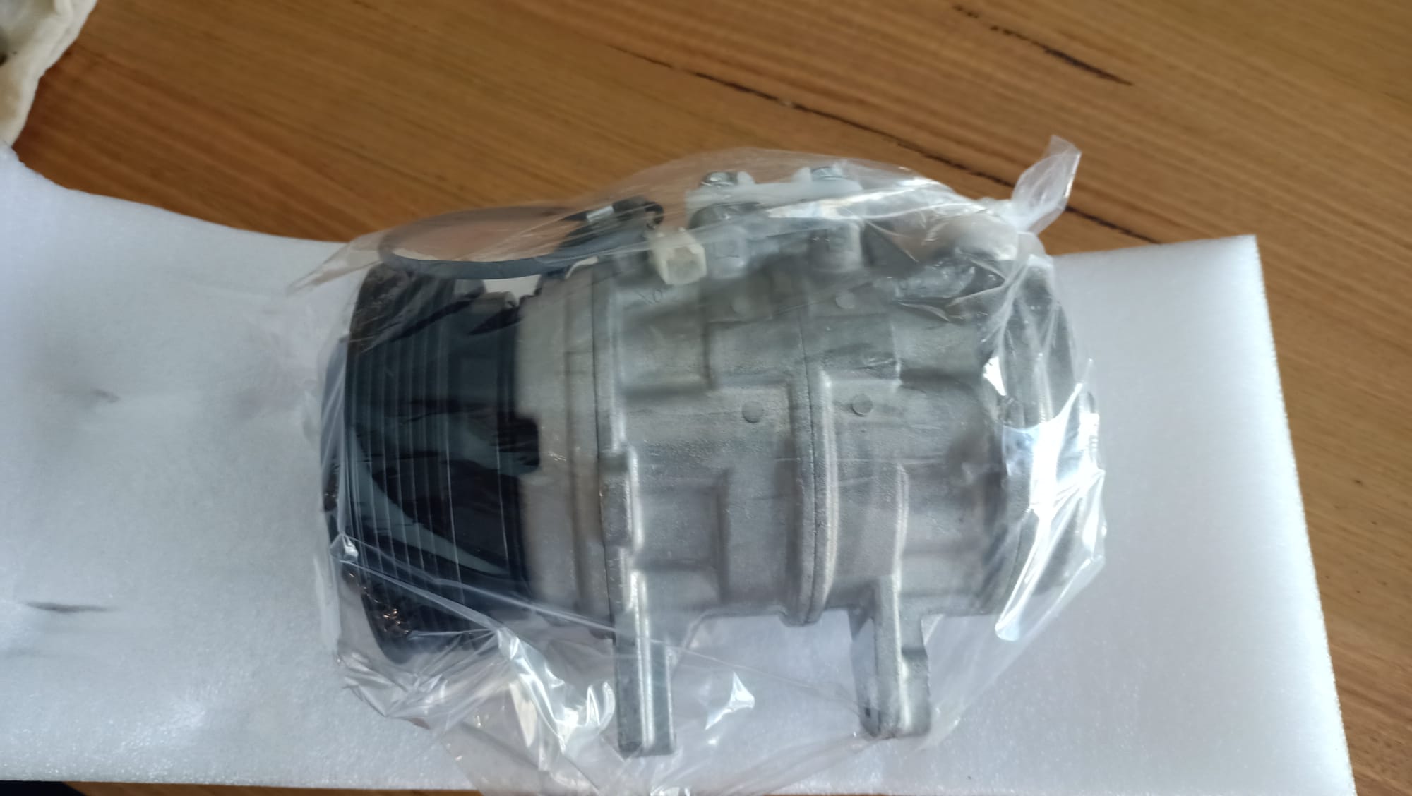

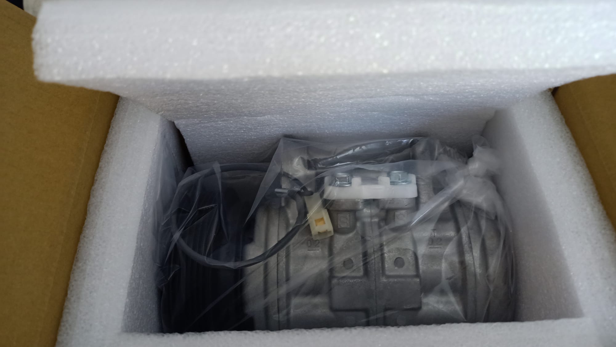

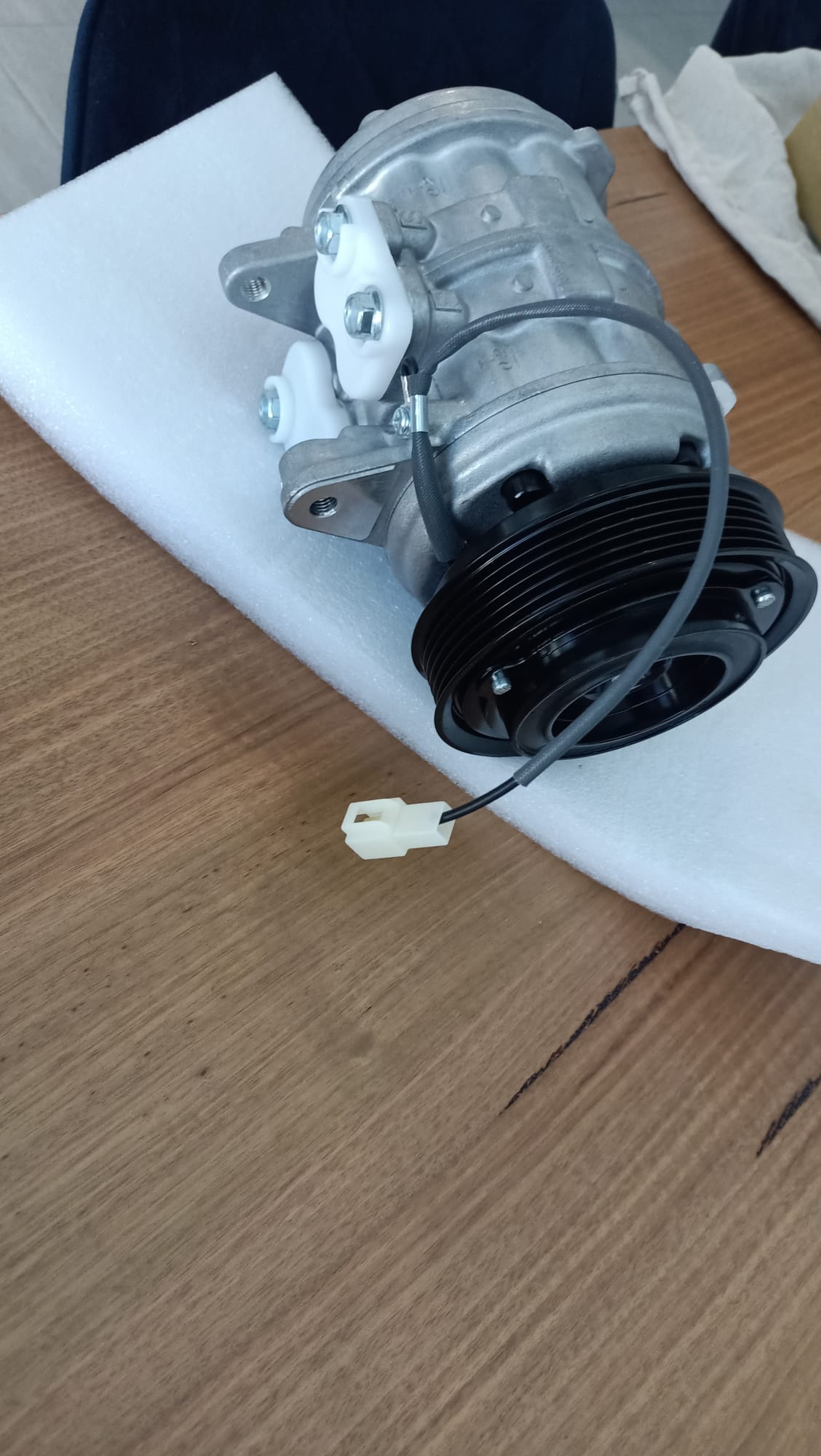

Quick update. A new A/C compressor was going to cost me $1800 AUD. Found a new one on Aliexpress for $300 AUD delivered to Australia (approx $185 USD). Ordered on 8/Jan and arrived 15/Jan. Had it fitted today and appears to be working perfectly.
Thanks again Tom and dr bob.
